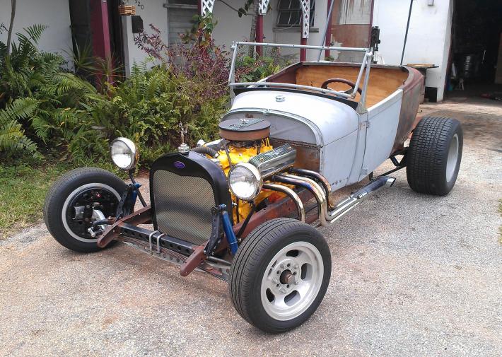

    Hot rod 2.JPG This was one of my highschool rods from 1959. This will be a rebuild thread below with photos as I can of my 1928 roadster. The other car I also drove was a full custom Henry J,but it got stolen the year after collage.
    I had taken 1928 roadster apart in 1965 and sold off some stuff to make new wife happy in our new house back then,put the rest away tell just a few years ago.. Now it's time to put this baby back together ,been hunting parts for 6 years,making by hand what I could not find,plus in many cases nearly comepletely remaking rusted out parts that were only good as a pattern do to my poor storage of them{ did think at the time,it was only going to be a year or so,before putting it back together= It's on me for not getting it,tell stepping up to it again a few years back!. There is older photos in my album.
    But today rolled her out for a shot at and angle that is kind of like one of my old photos;)
    Long way to go yet,but I got enough done now to at lest show something off. hotrodNsmall.jpg

    Front tires are 2in.too small/short,but they were free,so it will be some miles before I replace with closer to the taller size I had on it from 59 to 65

    A yellow Y block and is that part of a A phaeton body?

    Fantastic that you kept it !. Are you going to put the steel wheels back on? I hope so.

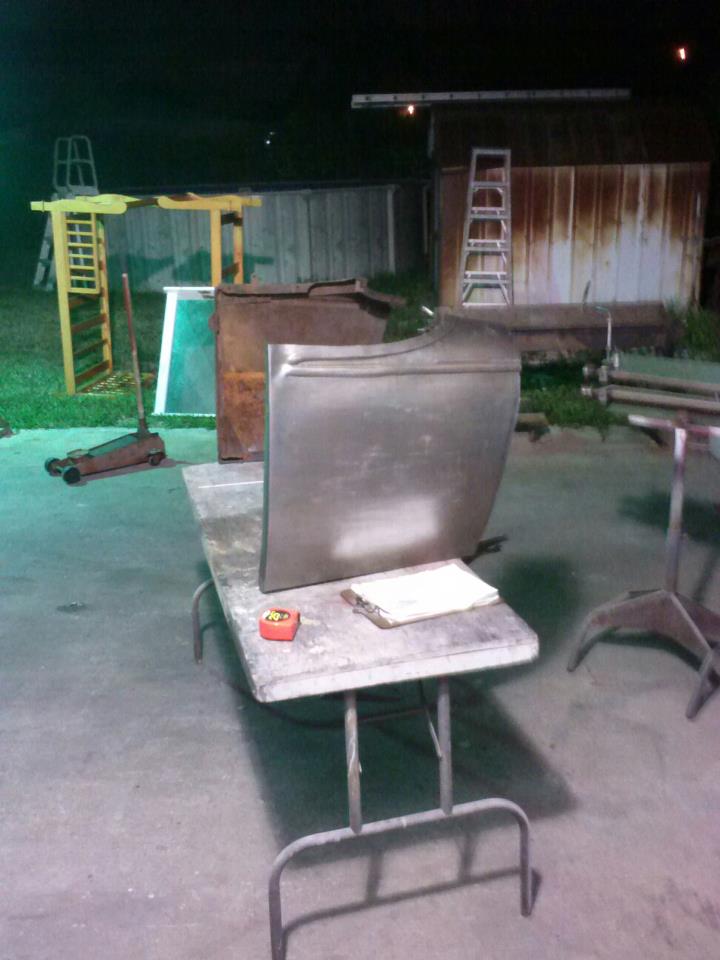

    I had some help from a buddy of mine John Fenner on the left rear panel as I had helped him on his hotrod V8 sbc MGB. My beadroller , plunshinghammer and metal brake were still down the street at his place when I started trying to do some body work,is always great getting help!.
    Some of the sheet metal really rusted out bad over the years of storage,and I had sold the doors,so made those frame works added two new skins I found fairly cheep, I had to replace a few parts and in some cases,even make from scratch most of them, the left rear panel behind door was comepltely rusted out,were others were O.K. to use small parts of. So I'll add a few photos of doing that.;)
    Started out this way,then put the kind of just repaired ,now good old right side,with the new fab left side close to gether for adjusting match ups. I did use inside bracing from old rusted out lift side,so was a little less to fab for the short rear panel.
    Had to make a custom set of rollers for beadroller to start out the shape of bead with.
