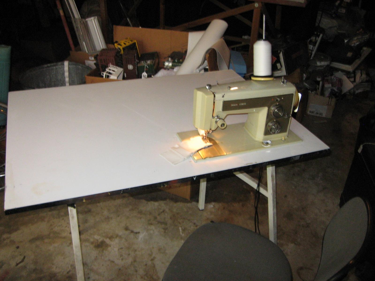

    I made a sew table my self from old drafting table I had around by just cutting a hole out the size of very bottom of machine just under it's base lip,this lets the work move with out hanging up on small housewife box it they come in,plus keeps the machine from moving.

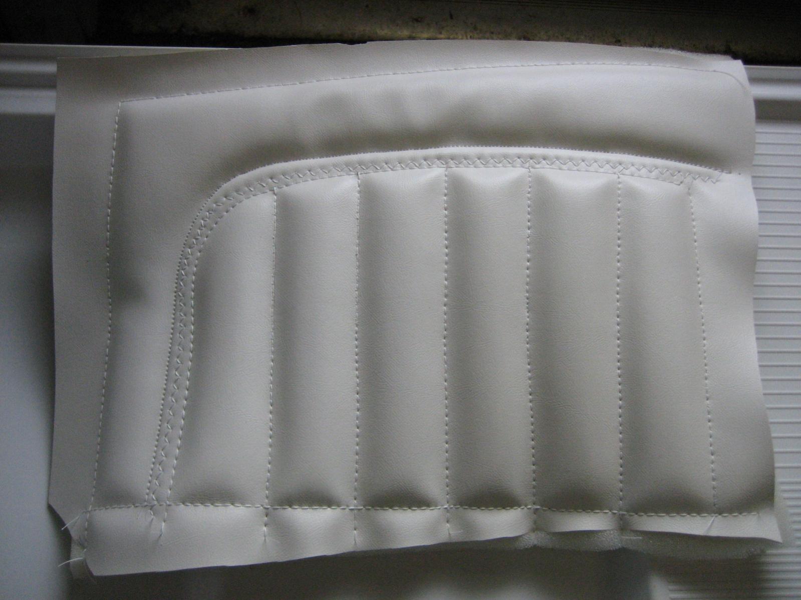

    A trick I tried worked pretty well too,but my son didn't like it for his "T",but some one may?.
    I was playing with Zig Zag stitch after I found out it would work if vinyl was upside down it would sew with 1/2in.sewfoam glued to it.
    So did a fast idea,not really trying to keep stuff super strait or even,just a proof of idea deal. The photo shows what could be done with out even cutting one color in to parts,just adding a sew pattern to the back side you draw there and comes out on the front,would of looked better if I had stayed on my lines in the back,but just fast test. You'll get the idea.
    Remember there are no cuts,only sew lines,the boarder is two lines with Zig Zag in mid for looks.

    IMG_9800.jpg IMG_9803.jpg This is old drafting table I cut a hole in to mount Kenmore,it makes moving your sew work around EZ ;)and key thing to getting a housewife sewing machine to do vinyl kind of OK.:D
    Note the big spool of v92 thread on Kenmore,to get it to spin and hold on there,8in.x1/4in. steel gasline smuched a little so it fits Kenmore spool pin and some small washers with a plastic contaner top about the size of v92 spool did the trick.
    The other photo is of walkingfoot adtachmint[this one was $15 new.]
    The swatch is of 3 types of seams you can use with vinyl.

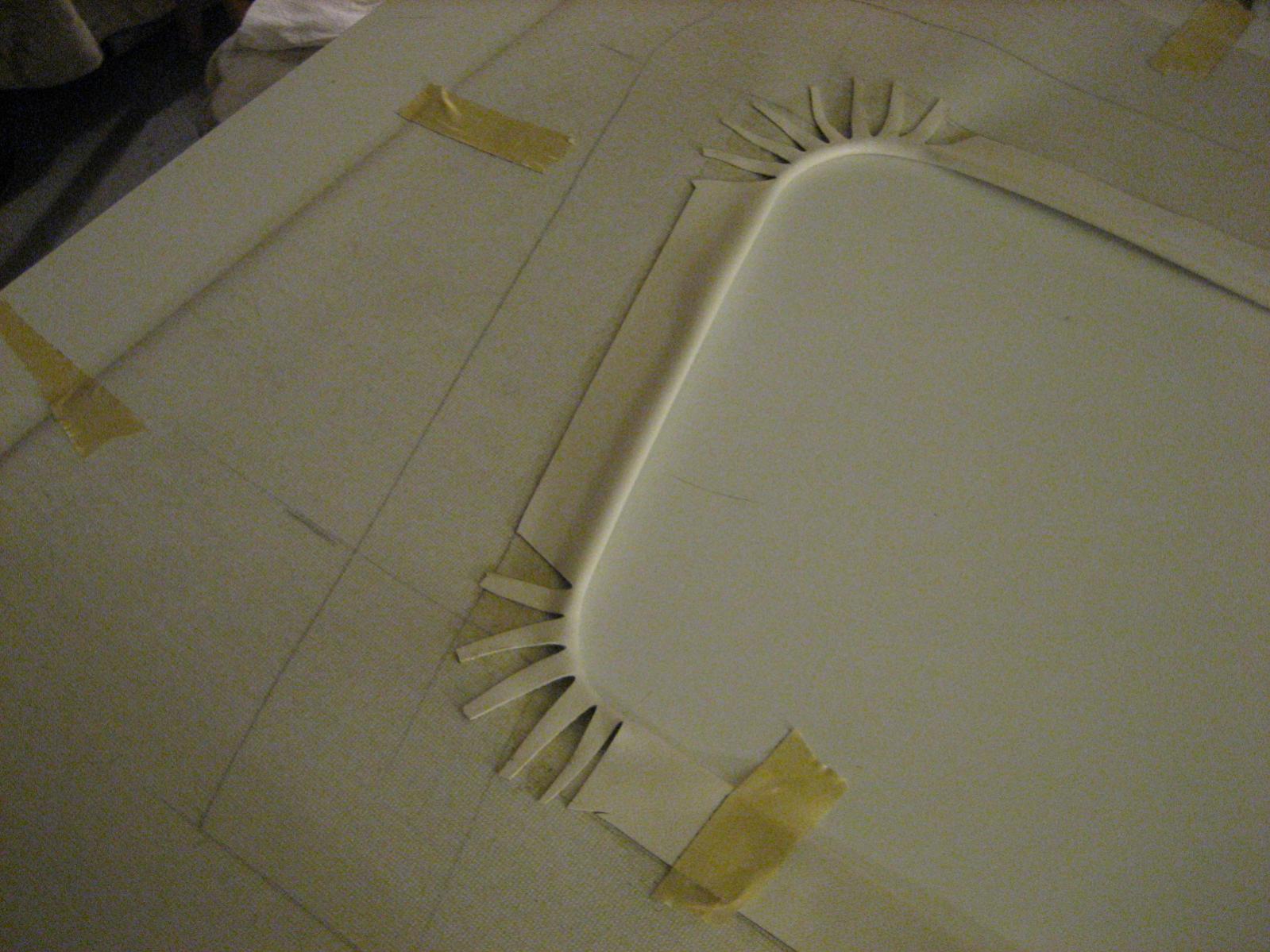

    scan0001.jpg Before getting going on this ,I had to find out what my son wanted his upholstery to look like,not the idea in my head,but the one in his. So he showed me some photo of stuff he liked parts of. I drew up a design and we talked and redrew it ,tell it looked good to him.:D
    Thats when we started trying to make test swatchs of how to do vinyl parts we'd need to make up the upholstery as in drawing.;)
    Having a drawing helps get us on the same page so to say:cool:

    IMG_9819.jpg To get around the limits of what this housewife Kenmore machine can and can't, I do some stuff that you would not with a pro machine I think;
    For going around the corners of the insert pleated panel,I cut and glued a 1in. tap under to get it all in place,with a lot cut on the turns for a smooth look from top side. The pleated panel has also a full 1in. exrta tap all round to let the sewing machine pull on a fairly smooth underside when sewing from the top in this case.
    After that glued outer in place over the pleated panel and then sewed,for corner I hand cranked it to keep good line.
    After cutting away the savage from behind by pulling glued tap up and cutting=this lets it all lay smoother. I added 1/2in. foam after that I cut to size needed to give it a nice soft look.:cool:
    This will be same way I'll do seat pleated planels,but there will be some outside corners around the outer sides that will need some tricks too.

    IMG_9971.jpg I compleated the seats :D:cool:,it's a two man job feeding it all through this old Kenmore,so had lots of help from my son on his T-bucket seats and door planels,he likes how they came out:D.
    The outer corners of the seats are done from back side of vinyl after stables and gluing to hold it right before sewing.
    The extra twin stitchs that show each side of outer seam are just for art of it along the outer cap panels[end boxing] ,some call them a Franch seam.
    Still got to do the black rug,but cockpit lip pad all around will only be after he gets the shiny blue paint job done with.
