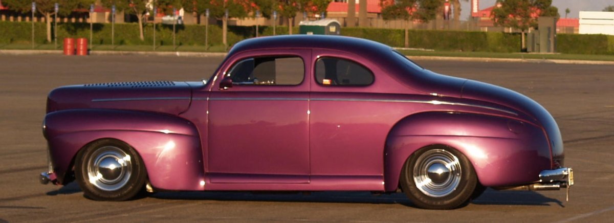

    Have our resident expert @themoose do some stock, slight chop and a third radical chop of your 46 coupe in painted form. Not to your rusty shell, but the finished red coupe from above. That should give you an idea of the proportion of what the chopped top does to the overall design.
    upload_2023-3-4_3-19-49.png upload_2023-3-4_3-19-53.png upload_2023-3-4_3-19-56.png
    Start with this finished version and get two other chopped versions, a mild 1-2 inch chop and then a final third model, a 3-4 inch chopped version to see how the proportions of the original stock body has already been played in the design. Then see if it looks proportional to the wide body. As each version of the chop goes, it starts to look squashed. It then becomes out of proportion and from the inside, hard to fathom taking it on longer road trips.
    I am 6 feet tall and old age is compressing my bones. So, the sight lines and comfort are very important. But, being inside of a chopped sedan delivery or any chopped hot rod, just did not agree with me and my driving comfort. As cool as a chopped sedan delivery was outside, the view from the inside was not worth it.
    Unless, the chop was not as radical and less inches would improve the compressed view everywhere. I doubt the cramped outward vision would make any road trips enjoyable. It improves the driving safety of you and your passenger, with a full stock window version, too. YRMV

  8. It’s a hard car to chop. However, you can save it with a Carson top, if you screw the pooch on the chop. Those coupes are as ugly as man ass, stock. So go for it.

    To me That series of Fords is the hardest top to get right when you chop it.
    That was my first thought, If you have to ask others opinion, the answer is no.
    That is just about as close to getting the profile right on a long door as you can get.
    I saw this one for sale at Vintiques NW nats and at a local swapmeet later and to me it is real close to being the perfect chop on that body style that is beyond hard to get right. The car was priced pretty decent for all it had on it including OT drivetrain and suspension but The truck tires and wheels would be gone an hour after I got it home and I'd be hunting a pair of skirts for it. Damned good thing I didn't have the money to buy it or place to keep it properly this time around. IMG_5818 (2).JPG IMG_5819 (3).JPG IMG_5817 (2).JPG

    ^^^^ Notice the drip rail to the flow of the roof and quarter window, that's why you need to be able to step back 20 feet or so or roll it outside. A shade too much of a cut for my taste, top looks a little flat. I always prefer to retain the drip rail line, although a favorite trick is to blend it into the roof ala 34 Ford. But this one has to sharp of a bend at the belt line. Everyone has to make the first cut, you had the guts to get this far to make it a coupe. A hair cut is not out of your wheelhouse. Anyone can luck out and do it right the first time, but it takes commitment to fix a boo boo! At least you're not hacking out a cherry floor and trunk pan to put an air ride chassis under it! lol Larry

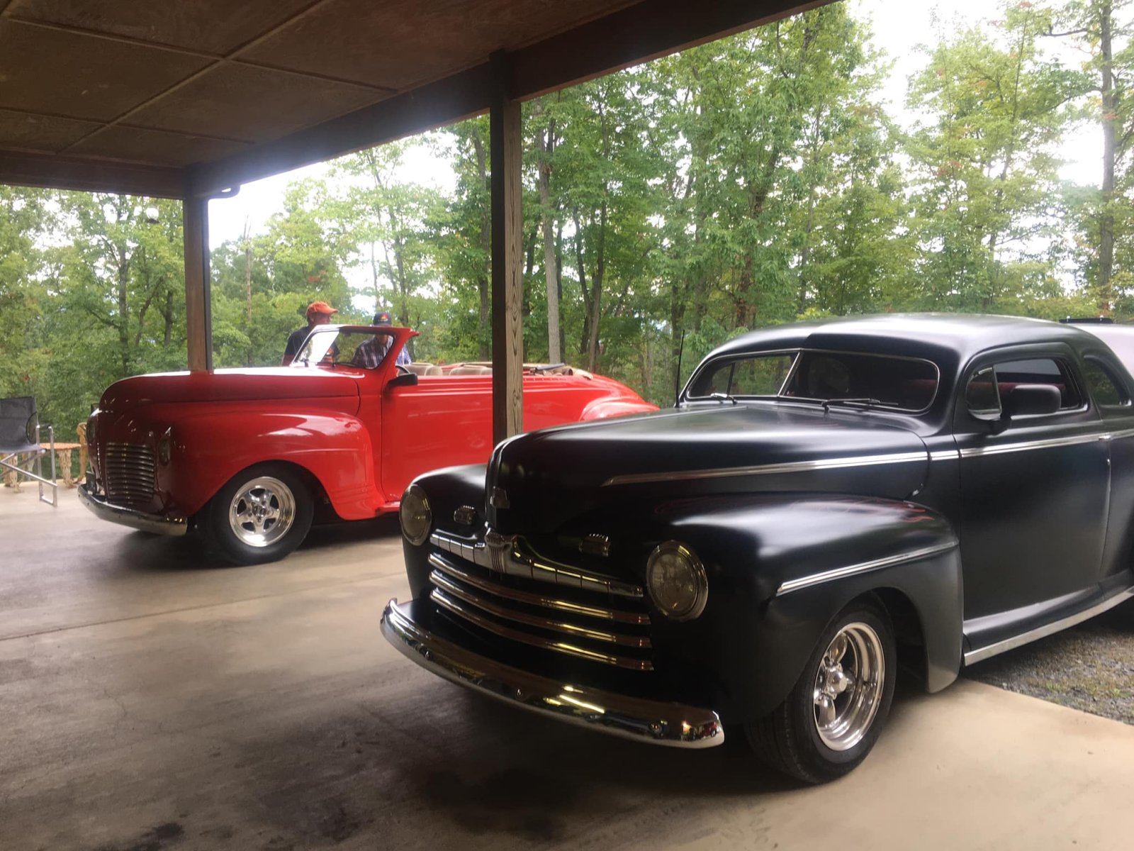

    IMG_20221022_130950334.jpg 273436974_10224956447031640_358074639884630238_n.jpg 273463744_10224956447311647_2241103254952244576_n.jpg I found this pic on Facebook. He said it was a 3" chop and took out the crown. Anything more to me doesn't look right and I might not be able to fit.

  25. The short door coupes are far easier to chop compared to a long door. I've contemplated a chop to my long door avatar ever since I bought it, but the degree of difficulty has kept me from doing it. Well, that and the cost of paying somebody to do it and get it right.
    Ford 'crowned' the roof on the long door to give more headroom so the back seat passengers wouldn't hit their heads on the roof when climbing in. Ford worked very hard to 'hide' this crown by spreading this change out over several places and didn't do too bad of a job, but even though the differences aren't large your eye 'sees' those differences nonetheless. It doesn't need chopping so much as it needs to be 're-contoured'.
    If you do some measuring, it quickly becomes apparent what the problem is. Ford crowned the roof about 2" higher as you move towards the rear. It's common the chop the rear about 1.5" more at the back to compensate for this, but this fouls up the window sizes. What you'll find (all measurements are approximate) is that at the divider at the vent window, it's 13" from the bottom of the window opening to the top. From the top of the window to the drip rail is another 2" for a total of 15". But at the rear of this opening, it's now 13.5" and 2.5" to the drip rail, a gain of 1". The quarterwindow shrinks back to 13" at the front of the opening, and the distance to the drip rail increases again. This is why when doing a 'standard' chop the quarterwindows usually end up looking smaller and too 'teardroppy'. The remainder of the crown is in the roof itself.
    After looking at the various roof panels used on these, it appears to me that using about the front 2/3 of the 4-dr sedan roof panel would eliminate the excess roof crown as well as eliminate having to modify the door opening at the drip rail (look at the top flange on the door/door opening to see why this is needed). Bring the drip rail down to parallel the lower window openings, and chop the door to get the same parallel glass opening. At the back, most guys widen the catwalk because the roof has gotten shorter if using the coupe roof, but I'd narrow it instead and lay the rear window down more. Getting the right 'sweep' on the drip rail will be critical. Cut the entire quarterwindow opening out, recontour it to follow the drip rail and chop it to reduce the opening-to-drip-rail measurement to the 2" that it starts with at the front. Whew...
    If I were doing it, I wouldn't even chop it at the front, all the work would be in getting the 'flow' of the window openings/drip rail 'right'. Too much chop and you get what that Merc in post 40 is.
    The short door coupes don't have this 'cheating' in the window openings/drip rails, that's why it's an easier chop. The one flaw with the short door coupes IMO is they end up having a 'big butt' with the wider catwalk. I'd be curious to see a photoshop with 4-6" taken out of the catwalk, cut down to the side trim line and then forward to in front of the fenders, then back down to the rockers. Move the entire rear end forward that distance. Shortening the frame/wheelbase would be needed. I think that would improve the proportions of the car considerably....

    Not the answer that I wanted to hear, probably the one that I needed to hear.
