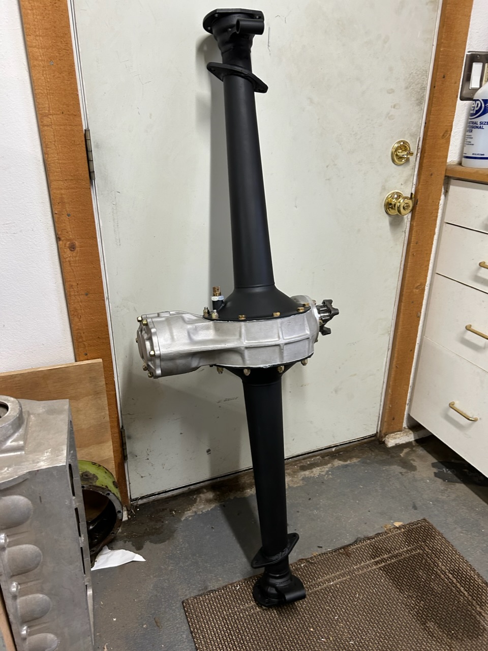

  5. Checking in
    Thanks Jiminy
    So finished up coop rear
    Now need the time to install

    John,
    Is that a ring gear "snubber" on the axle housing? Does that center section not have a pinion shaft support bearing?.
    The assembly looks great.

  8. Hey Dan,
    This is a 201 Halibrand (V8) with the straddle mount bearing and yes that is a snubber.
    Since these are '35 housings with the smaller bearing the snubber will take some of the load if I get too frisky with it.
    Can't wait to get it in and finish the new motor.
    Happy New Year All, J

    looks good john
