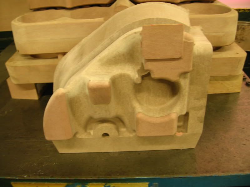

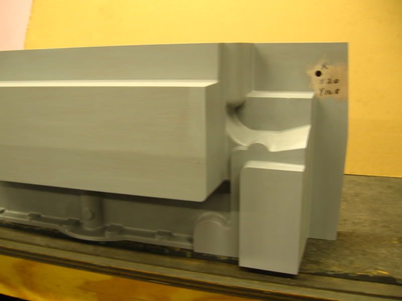

    Hello gentlemen,
    I'm Tod Buttermore, and new to this forum. As you can see I have a new Model A block underway, which I hope to have sample cast this fall or winter. I don't have alot of time to work on it since I machine parts for Snyder's Antique Auto Parts all day everyday. But after pecking away at it here and there I am finally getting near to casting a sample. Hopefully this will be a viable option to old and repaired original blocks. This block will have a pressurized oiling system and will accept stock sytled parts for final assembly.
    I hope to sell them through Snyder's, mainly. As they are not yet ready for retail, please do not contact Snyder's for any details.
    Tod Buttermore

    Since August I have been busy with other projects (like Snyder's new 6 to 1 head, and the Prus Model T head, and a new Model A header). But lately things have gained momentum and I am starting to test assemble the new A block core pack in its sand mold. This will allow me to make sure everything is right before core boxes are poured and a casting is made. So far, everything looks good.
    Tod Buttermore

    As of now, all CNC pattern work is complete and I am test fitting the core assembly. So far, everything is looking very nice. I have 4 core boxes to finish from their current "core plug" state. Then I will be pouring the first couple of samples. With my current work load I expect 2-3 months and I will have sample castings. That puts samples at the end of January or early February of 2013.
    Tod

    Well, I finally had time to finish the pattern after letting things sit for so long. Yesterday 3/20/2014 we poured the first sample casting. I am very pleased with the results. Now it is time to set it up and machine it.
    Tod

    If anyone wants some private info (a pic or 2) on the block, email me (or PM). Keep in mind, these will not be ready to go to market until I make fixturing, write the machining program, and even sample a few more (4-6 months?). I have several people wanting these already and I will probably let some friends have the first few for testing. I have confidence in the work but you never know what can crop up once things get underway.
    Tod
