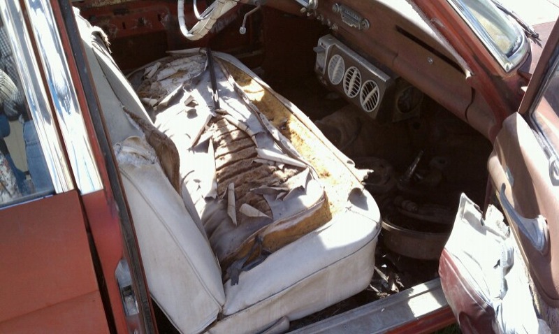

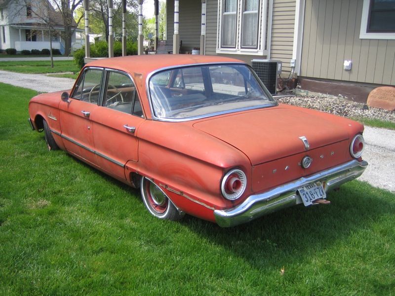

    my dad and i had been looking for cars for me for awhile. originally i was looking for a t-bucket, but i recently struck up an interest for 50's-60's customs.
    we looked for 63 ford falcon wagons for a couple months and researched them for awhile. but eventually i started looking more for 2-door falcons. then it became apparent that rust free falcon deals that were what i was looking for were hard to find. one day we found a 62 falcon four-door in irving, texas that was virtually rust free and looking fairly stock. we looked into it and i finally decided it was what i wanted.
    so we contacted the guy and with in a couple of weeks the car was sitting in our yard courtesy of Ben DeLozier.
    for now the goal is to get the car running well and safe enough to drive daily. although an additional goal has been set, see how efficient we can make it.
    the long term goal is to create a cool mild-custom falcon that i can drive while im still in high school. i want the color to stay pretty close to the stock red. but i would also like to add some sort of scallop and lace top possibly. still undecided. i will also lower the front by about a coil and a half. wheels are going to stay the same except the caps are going to be baby moons with skinny white walls. ill shave some trim including the FORD letters and the gun sights. havent decided on the grill but it will probably be customized with some cabnet knobs. interior will be white with red inserts (pretty stock)

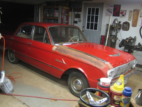

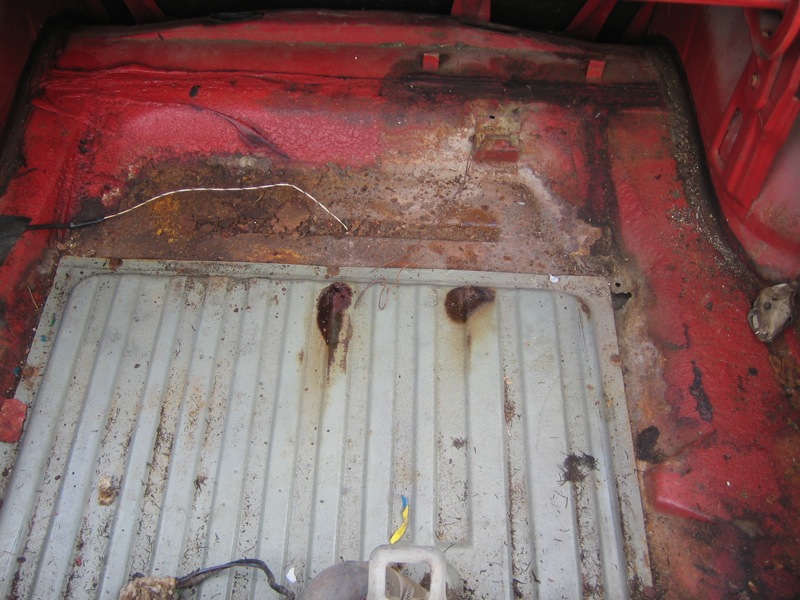

    That looks a lot like my '62 Tudor when I got it, especially the gas tank. 'Cept mine was worse. The guys at Bel-Kirk Mustangs in Bellevue Wa. told me about swapping out my 16 gallon tank for a '67 Mustang 22 gallon one, with the sending unit. They sell both reproduction. It was a bolt-in with the only mods being rerouting the filler hose. It was a little tricky but turned out great. I cut a coil out of the front springs, and put in 2" lowering blocks and it sits pretty good, (Check my photo album) You can also do a "Shelby Drop" up front by drilling new upper A-arm mount holes 1" lower, and 1/4" rearward. should drop it down about 2".

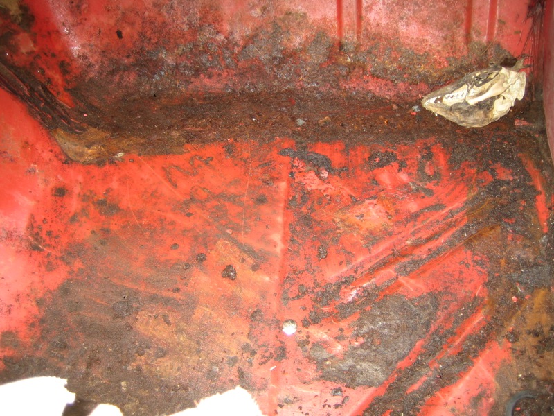

    Thanks for the kind words guys. Jesse's a great kid. He has his head screwed on straight, works hard, gets good grades, has a great sense of humor and makes his dad proud. Plus he's plays a mean guitar and is a pretty darn good rookie pinstriper! Am I bragging? Maybe a little. ;)
    Boeing Bomber - Are you thinking that someone swapped the gas tank on this Falcon? We were wondering when we pulled out that old carpet. It looks newer than the rest of the trunk. How can we tell the difference?
    As you can see from his pics, Jesse spent the better part of Sunday cleaning out the nasty interior. Had to get that out before the car goes in the garage. Need to keep the critters out. Anyone see Irving?

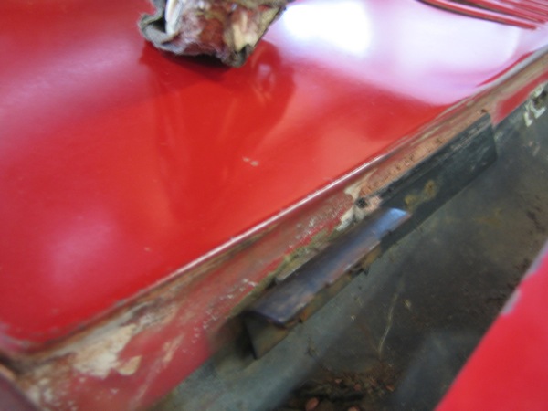

    Great start guys!I love the round falcons.I had a 62 myself that I miss to this day.Be very careful of the hood where the hinge bolts to it.I have found that if they sit this area will rust.If you pull up to hard it will break off(ask me how I know).SDBcivic on here has a 4 door parts car that he is selling stuff off of if you need anything PM him.Good luck.

    The falcon needs some new seals for the hood because it was rubbing up against the back of the jam and every time I open the hood there was a loud bang. Originally we thought the hood just needed adjustment, but today we discovered a metal piece that screws into the jam was missing on the side that was making the noise. So I made an identical piece with a hack saw, a drill press, and some files (one of the many reasons old fords are better than new fords-you need a degree to make a part for a new ford :D) There's the original piece in two pictures and the new piece in one.
