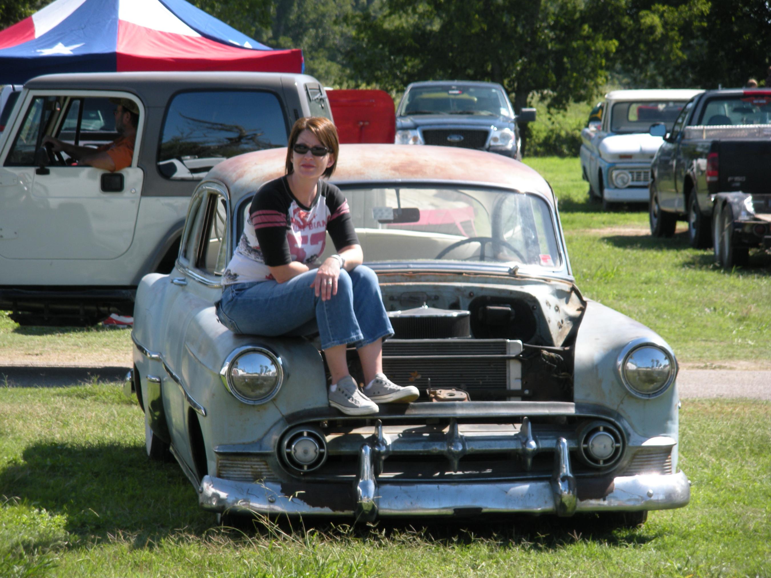

You will want to C the frame for sure to go LOW. Gambino can hook you up or order parts from suicidedoors as well. I would support Gambino tho. My custom built rear set up. This is with the rear wheel well moved up and aired out.
