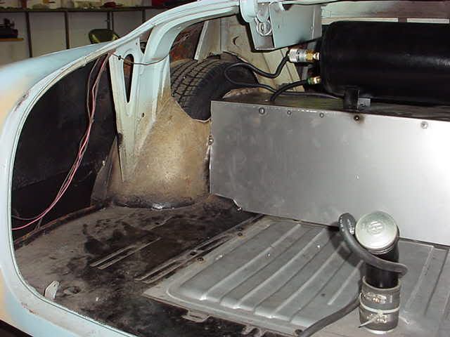

  19. happy hoppy
    Joined: Apr 23, 2001
    Posts: 2,327
    happy hoppy
    I had to cut some more of the wheel well since this pic. was taken but, it gives you an idea.
    I also had to cut some of the lower 1/4 window "box" 'cuze my tires go up so high. this means I can only roll my 1/4 windows 2/3rds down, but I can live with that.
    when aired out, the inside-top of my 1/4's are about 1 inch from touching the tops of my tires. but I run tall tires, if you use a smaller tire and a fender skirt you might not have to butcher as much as I did.

    What size tank is that in the first picture?

  23. happy hoppy
    Posts: 2,327
    happy hoppy
    its a 16gl re-pop mustang tank.
    you can get them anywhere for around $100 more or less.
    they work great, chopstix is using a 20gl in his 51.
