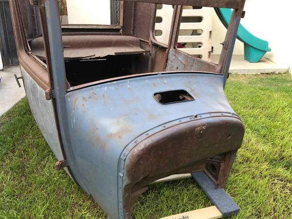

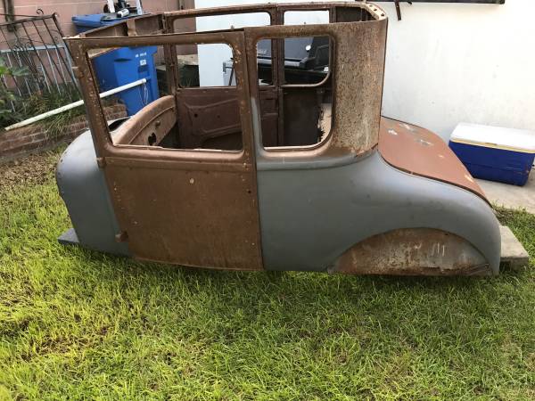

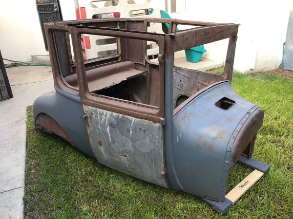

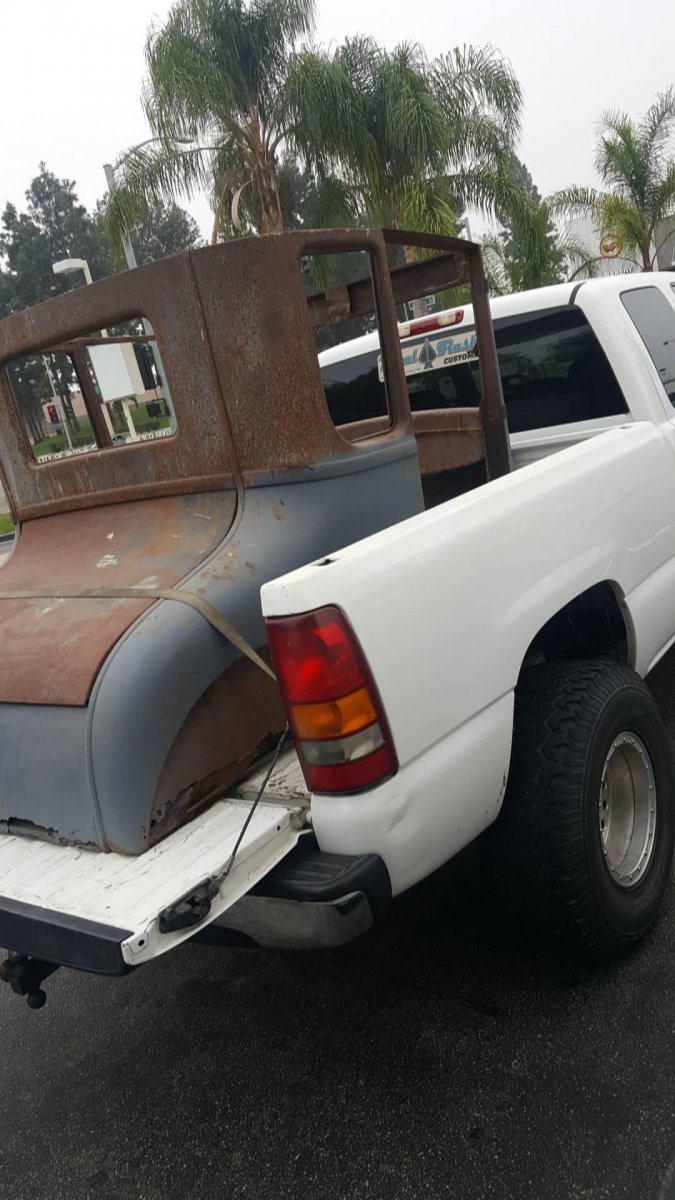

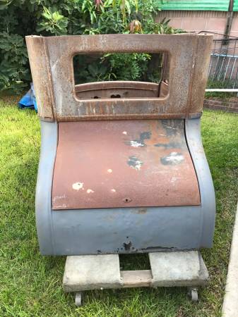

    Just picked this up Sunday. Want to do a traditional 50s style hot rod racer. Want to chop and channel it with a 346 cadillac flathead. I'd like to run wide 5 hubs as well. Kind of new for me to learn so I'll be looking for advice along the way. IMG_20171029_130617_894.jpg 00l0l_lf5ErMA5Ob1_600x450.jpg 01717_DumYEPmeki_600x450.jpg 00m0m_kWzbS5PypON_600x450.jpg 00i0i_awAMR4sdJCU_600x450.jpg 00X0X_6W2kOsC2W8z_600x450.jpg

    Model T coupes are cool but narrow.
    Plan carefully with shop and channel couse you run
    out of space for pedals and headroom fast.

    As AndersF said you will run out of room quickly. I chopped but did not channel and have almost no head room.The pedal thing is an issue as well.Im still working thru that.

    I've seen many 'T's' in that condition....body only. The fact that you've got doors and a decklid makes it quite a score! I love the Caddy flatty idea! As stated, these cars are small. Chop and channel carefully. Measure twenty times, cut once!

    Yea I've been doing a little test fitting with myself in it. I can definitely see how space is a premium.

    Once I saw it had the doors I was sold on it. I'll fix the rust and channel then see where I fit with a chop.

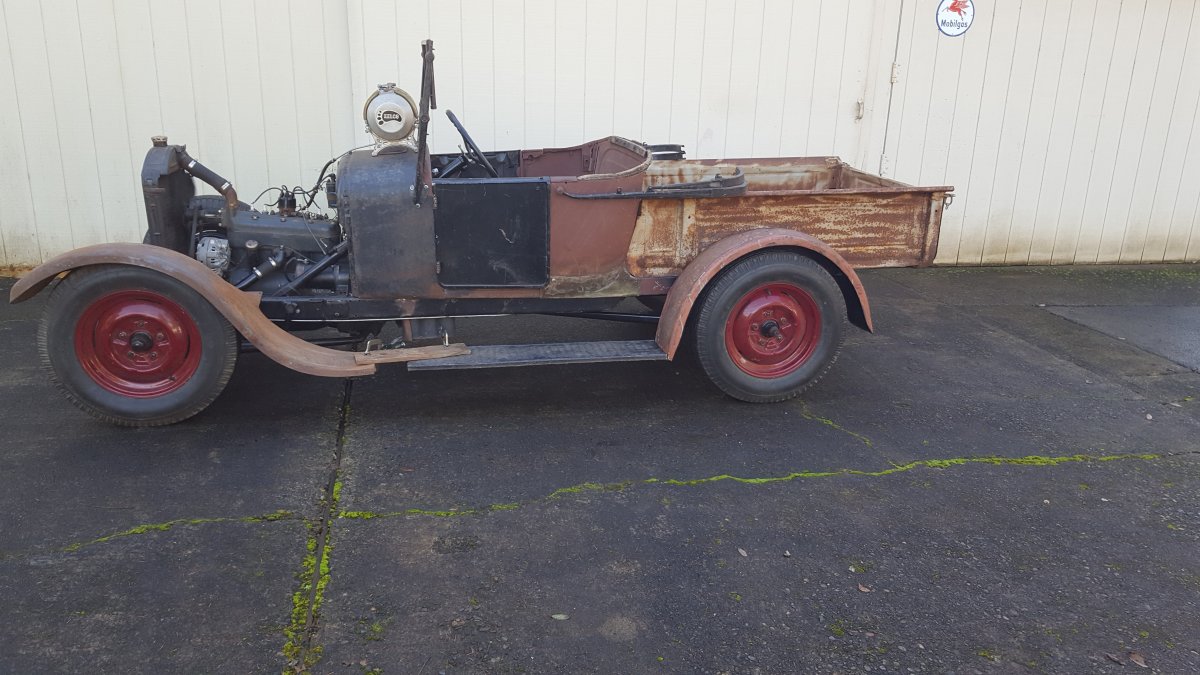

    This chassis has been built to take my 1926 T pickup.
    https://www.youtube.com/edit?o=U&video_id=5GQ8Ujaq7MY
    Not exactly the same for a coupe, but it is a 32 Ford style chassis which helps provide you with more room in between the chassis rail.
    The height of the rails also helps in hiding some of the ugly stuff that can hang down and be seen from the side, which ain't always pretty.
    It will be running a 346 Cadillac flathead so it will give you some idea of what you are in for...
