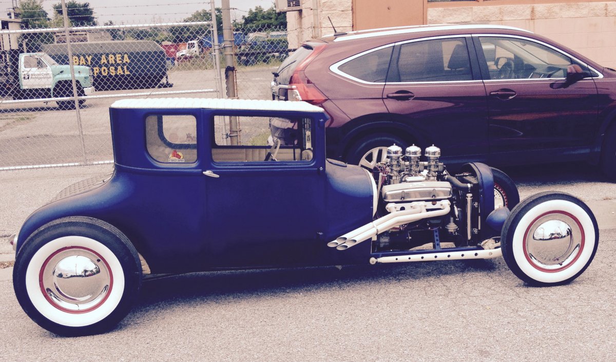

    So i started to google to see whats else was out there.
    One off the first coupe that come up that i like was this one.
    I even start to collect some parts to do something like this when i come to
    mind that i allways wanted a 50:s styled hotrod. At least since 1988 when
    i read Hotrod magasines 40 years anniversery. So i did some more searching
    on internet for 50:s hotrods and i constantly come to Hamb.
    I allso find the car to have as my main inspiration here.

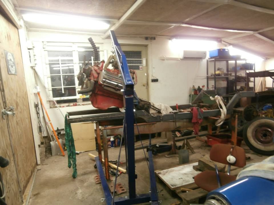

    I first started with the rearaxle but change my mind. I wanted to do the crossmember first.
    And to do the crossmember i needed the motor and transmission in place first.
    And then up with the engine and start to determine the position off it.
    My oilfilter interfear with the frame and i wanted to keep the stock one for look.
    So i cut out a pice in the frame and welded in a plate to mount my engine lower.
    Im later find out i did the work for nothing when i had to lower the engine more.
    I allso tested the frontaxle so i dont get any problem with the steeringrods.

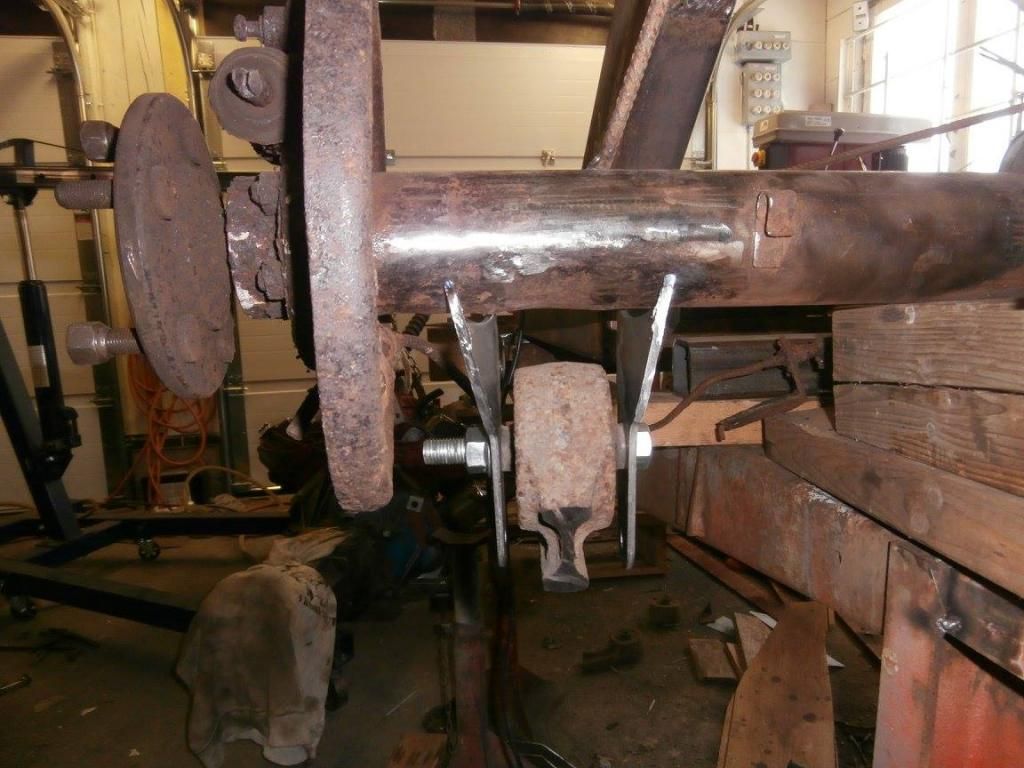

    With the rear motormounts in place i needed something in the front.
    I just keeped the stock mount and added tabs on the frame for them.
    And then it was time to make something to mount the front spring.

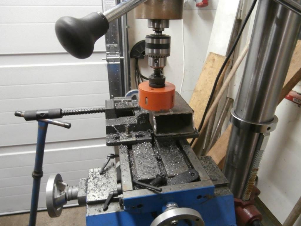

    To make my own x-member i toke a pice of tubing and splitted it in half.
    I allso drilled and tapped some holes every 8 inch on the rails to clamp
    fuel and brakelines. I guess it will be difficult with the x-member in place.
    I could then do some initial mock up to get them in place.
    Then i added some some holes to give them some kind of stock apperence.

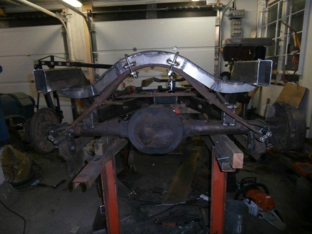

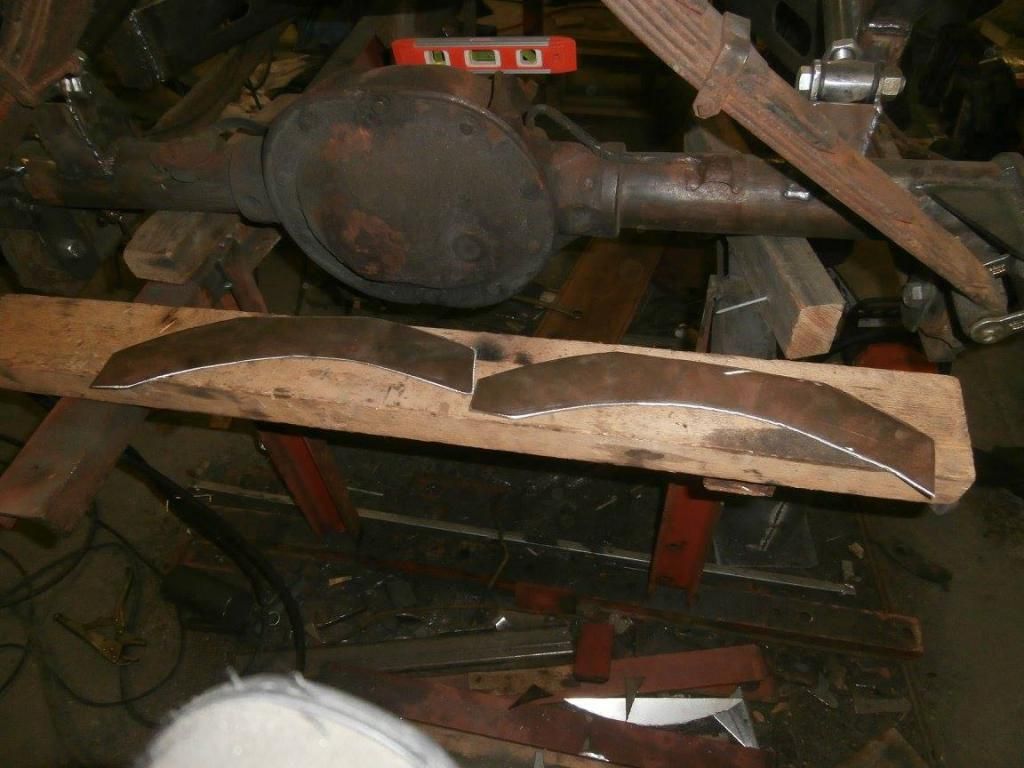

    The next job was to put some notches for exhaust in the x-member.
    A boring work but i want to run my exhaust high in the frame.
    Then i started to fab some suport betwin the framerail and x-member.
    And finally i split a pice of tubing to make the pices i need to connect the x-member in the middle.
    But theese aint welded in yet. I waiting with that until im sure the engine and trans is in its final place. I allso need to know where driveshaft and handbrakes routing are before.
    I could now cut my frame loose from the table and flip it around to do some final welding.

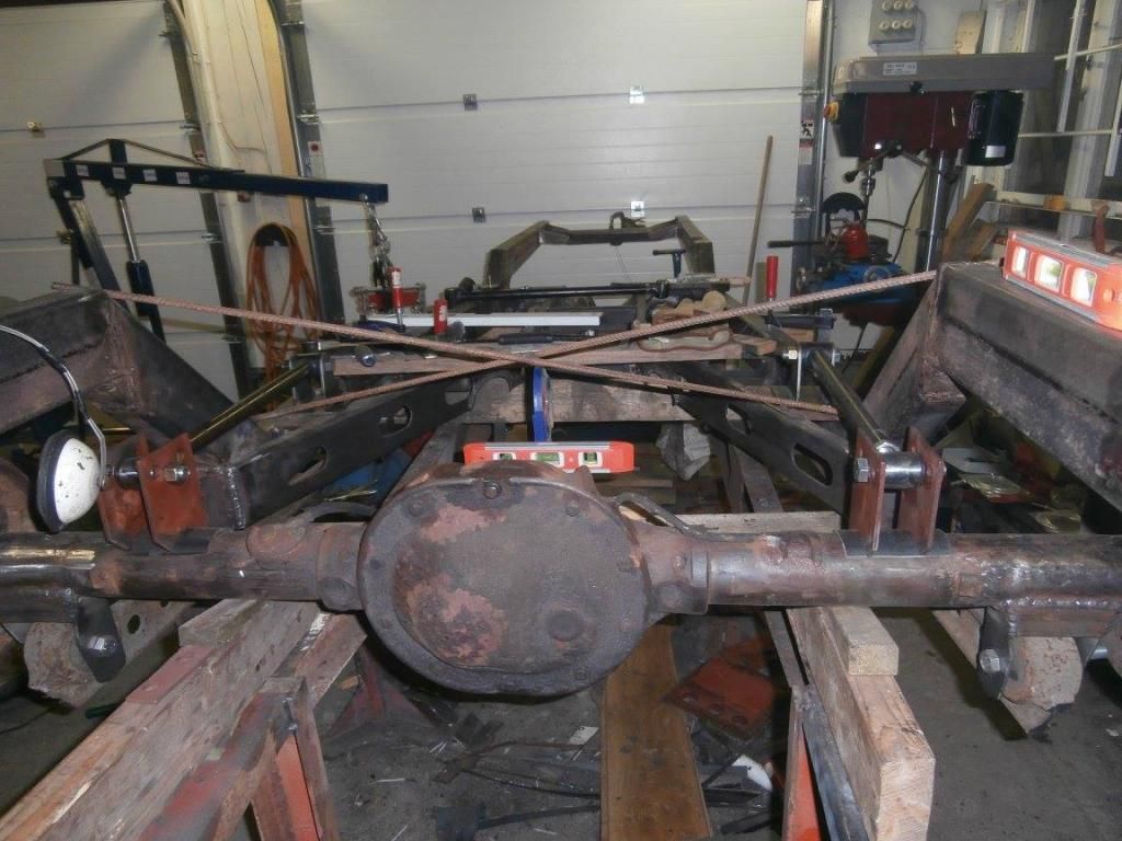

    With the crossmember in place it was time to mount the rearaxle.
    I had a idea how to mount it but chicken out becouse i was not sure to pass the
    swedish tech inspection. So i ended up with a regular 4-link.
    A link to a thread i started about hanging up my rearaxle.
    http://www.jalopyjournal.com/forum/threads/will-this-rear-suspension-work.957446/
    I had see someone here on Hamb with a trailingarm for a Land Rover he intended to use.
    It have a cool I-beam look so that what i used as the lower arm.
    Other then that it is a regular set up with all arms paralell.
  27. Interesting build, sure like all the pictures, thanks for sharing, looking good!

    With the axle hangin in the frame i need some suspension to the rear.
    I hade a Model-A spring i intended to use so i started with to mount springbrackets on the axle.
    I hade been looking for a Model-A crossmember since i started the build but those few that was
    for sale where sold before i contacted the sellers. And to buy one from the states and import seems
    unessesary expensive. So i started to make my own.
    The advantige is that i can make it to fit my frame and not have to adapt something.
    I got some pices of iron that was perfect match to use to the spring.
    The backdraft was that it was 3/8 and not so easy to bend.
    But i could use my cheapo pipebender to do that.
    First i drilled a hole for the spring and then rigged it in the bender.
    But i got problem that the pice kinked at the top.
    So i hade to put it in the wisegrip to straighten it.
    So after i alter it betwin the pipebender and the wisegrip it starten to shape up.
    My second problem was that the sides bends not match.
    So when i was pleased with the bend on one side i put in some woodwedges there
    and bended the other side to match.
    Then i hade to move things around in the bender to do the final bends.
    Then i take a 1/8 sheet metal and made the skirts and finally the tabs for the clamps.
