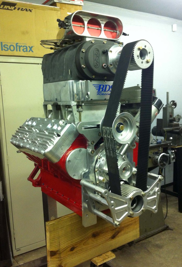

    Russ, I just found this thread-it's great! Thanks for the props!

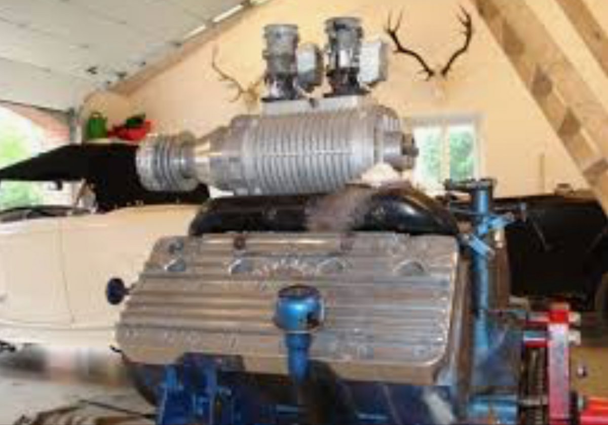

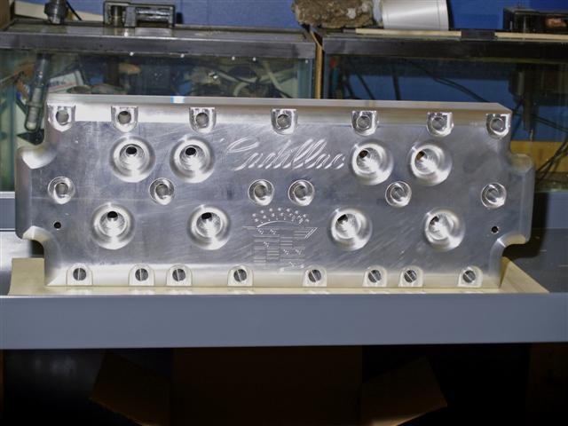

    I've been seeing, and hearing a lot of Caddy flathead stories lately. Garry Odbert is in the middle of porting his engine, to run at Bonneville this year, in his roadster( 1st 2 pics). He has just achieved 200 CFM flow, out of his #5 and #6 intakes, and is working hard to match the other ports. This means 500HP is possible!
    Bob Brooks should have his Caddy flathead powered liner on the salt this year, running on nitro. Bob has a proprietary head design, with 2 spark plugs. He doesn't want me to show the chambers, but I can show you the tops(pics 3&4)

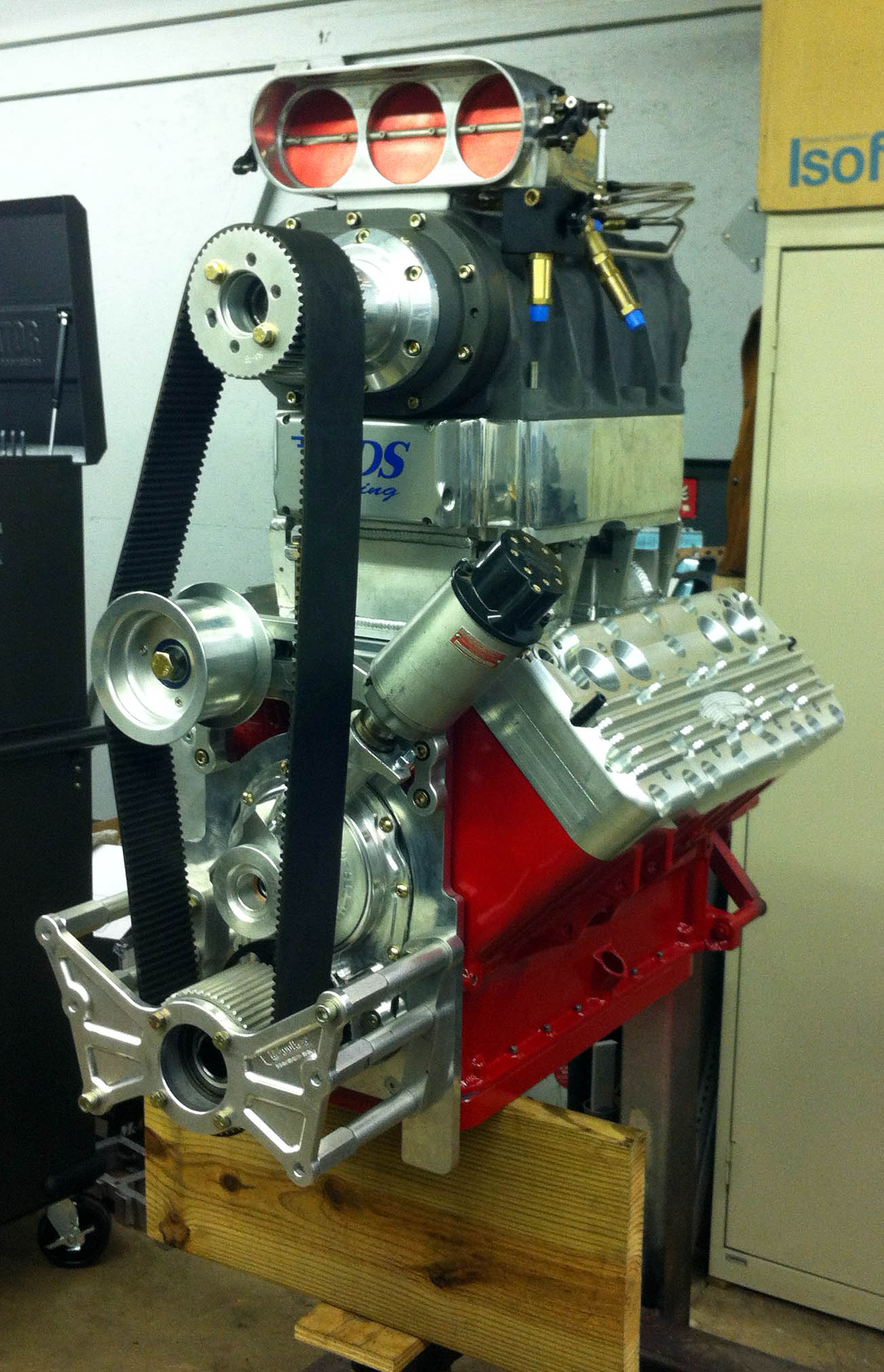

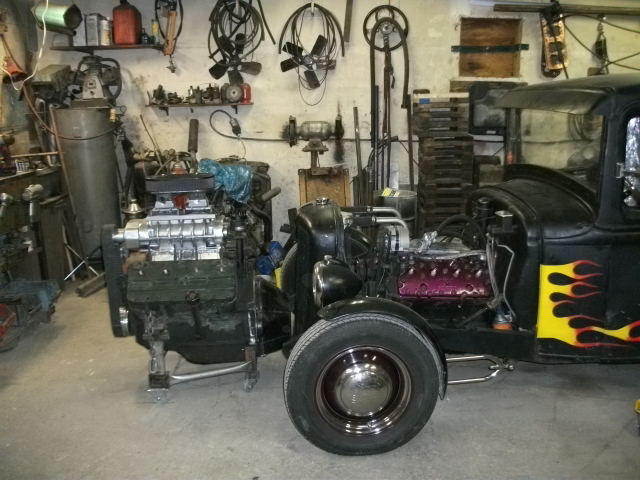

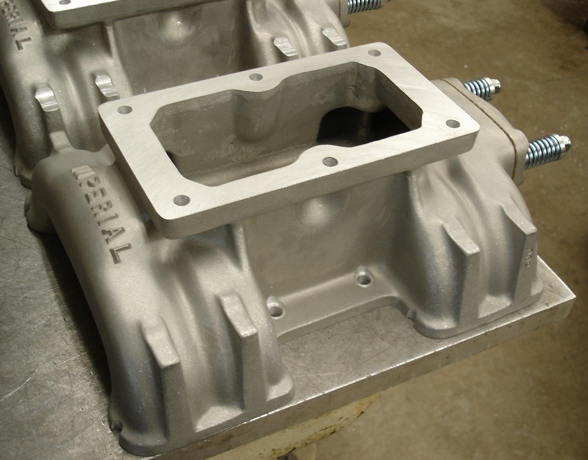

    Collin Sugart has been busy, making 4-71 blower intakes for the Caddy flatheads(pics 5&6)
    Lastly, the Flatcad (Last 2 pics) will go to the dyno next month, with high hopes of making close to 500HP. I'll let you know how it turns out!

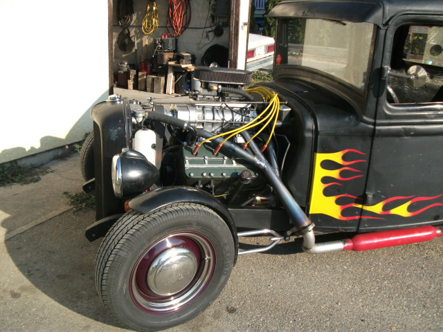

    Joined: Jun 24, 2011
    Posts: 4
    flatout258
  9. 38FLATTIE
    Joined: Oct 26, 2008
    Posts: 4,350
    38FLATTIE
    from Colorado
    Flatout, I really like the way you did the blower intake!
    What blower are you running? Can you give us engine details?

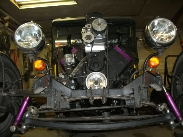

    Overheating Issue:
    I got your timing cover on the Caddy,and it seems to be just fine without any leaks. I took a couple of pictures of it going in, before I installed the rad. I still don't have my computer on line so I can't send any pics to you.
    I've got 5,600 miles on this engine now and the only problem I'm having is with it's temp-control (my rad is just too small).
    I went on a 300 mile tour on a fairly warm day(36 degrees celcius) I had to pull over and stop a couple of times to let it cool down. It would cool down while idlelling, how 'bout that EH?
    I will get through the season with the rad I've got!
    About your over heat problem, just one out of left field for you.
    Could it be also that between your diff ratio being a little low so hence your rev's are up a little plus maybe your water pump is working too efficiently and pushing the water thru your radiator too fast.
    It can be a common complaint on model A Fords when they install repro water pumps, they boil for no reason, but really the reason is the water is not staying in the radiator long enough to cool down.
    If you install a bigger radiator because the storage is bigger it will probably work but still it may not be the only solution.
    Try some sort of restriction in your water system and see if it will help.
    Remember big trucks have quite large radiators but probably in proportion to a car they would be similar but usually they run relatively small diameter radiator hoses!!!
    Just my 2 cents worth.
    I feel 2000 rpm at 60 mph, and 2500 rpm, at 80mph should be fine.
    As for the water pump, it is rated at 20 gpm at 3.5 amp draw through an 0riface 3/4 inch in diameter, which should be compatible with the thermostat opening.
    I should mention, I have a mechanical temp gauge mounted at the rear of each head and the thermostat is mounted in the driver-side upper radiator hose, this allows me to monitor each side seperately and it is interesting to watch how the drivers side runs at or close to the thermostat setting until the normally colder passenger side rises in temp (130-180 degrees) depending on how hard it is working.
    When-ever the passenger side does get to 190 deg, and the engine keeps working then they both climb quickly until I start going down hill or pull over.
    Wind resistance above 60 mph is a real factor and over 70 mph it is able to raise the temp as quickly as going up a long hill!
    I hope there are fewer hot days this summer, 'cause I really enjoy the ride.
    I have to be careful, with the rpm, It seems that 4000 rpm happens to come pretty quick in the lower gears without any sign of running out of breathe.
    I'm more used to higher revving engines (I'm trying to stay below 4000) so don't accelerate too hard from a side road or stop sign in second gear or to merge with highway traffic.
    For me it is a little hard to watch the tach and blend with traffic.

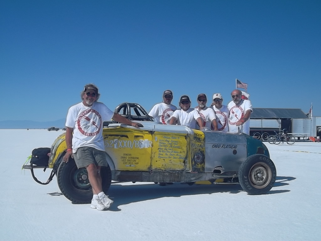

    Russ, the Flatcad is in racing form, and running 165.040MPH! At this point, it's the worlds fastest documented Caddy Flathead!

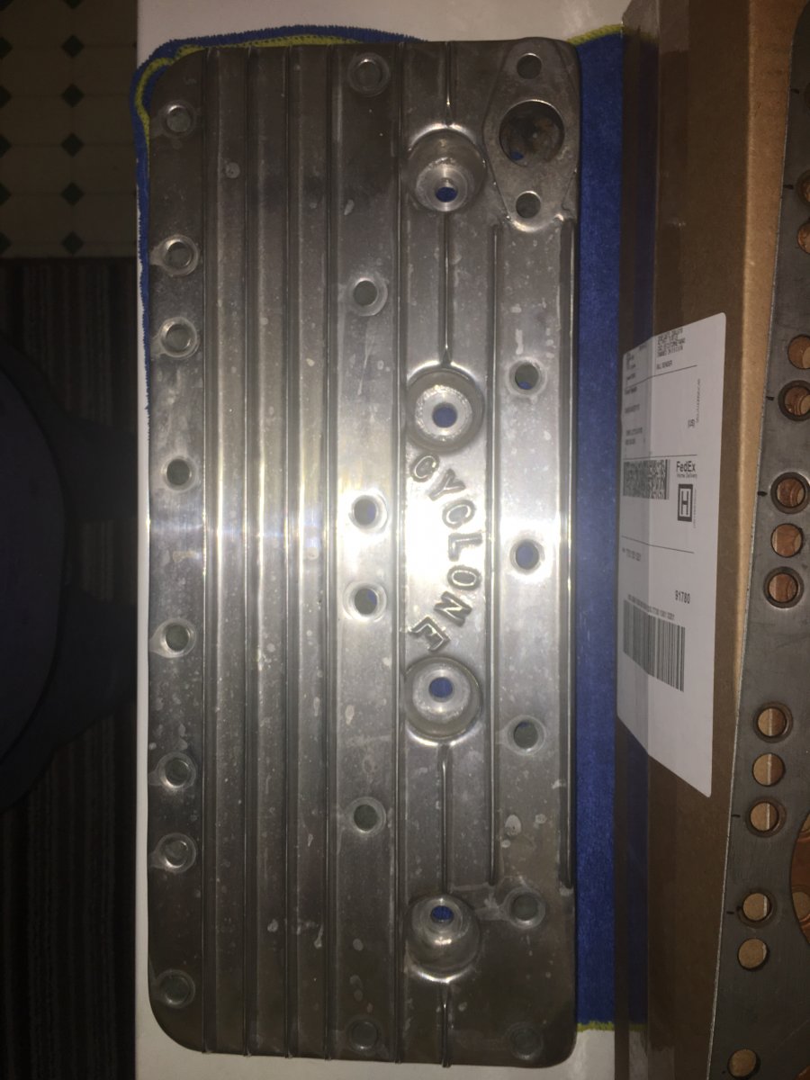

    Don't forget us here @ Cyclone ;).
    This is Palle's engine, I just love the look of it blown.
    Can't wait to get or 38 Cad into 64c when time & $'s allow. 5B921B7C-DEA0-43D9-A519-0AFBE85F6A4D.jpeg A17D8FC5-85AE-4643-80E7-048D6B9D8BBF.jpeg
