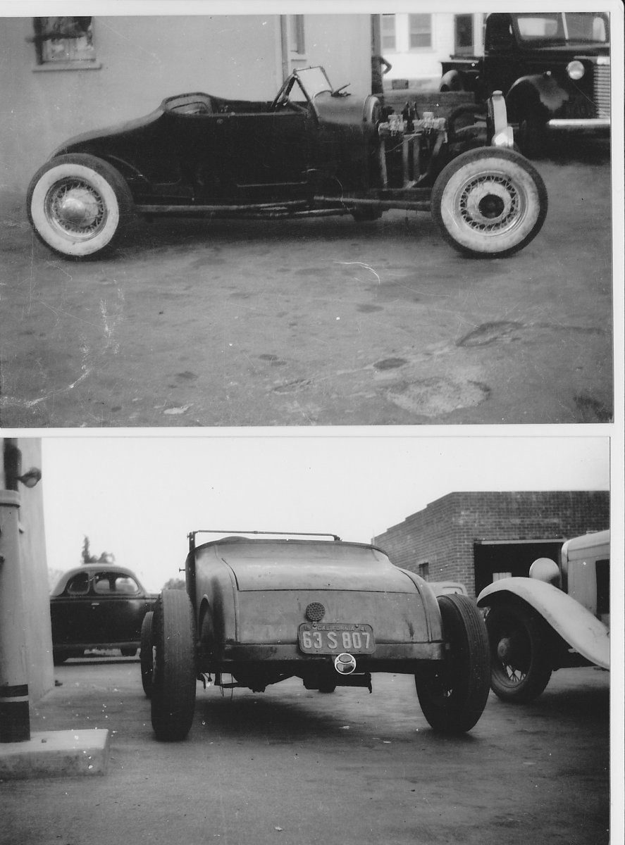

    DocImage8.jpg Me and the hot rod Banger I built in 1951.
    Z ed and channeled, B block, Thomas head, full pressured, Mallory, juice brakes, split wishbones, dropped axle, '32 grille.
    Bought it for $95 in 1950 at age 15. Had a windshield but only top was a sheet metal removable. In 1950 a Model A was still a driver, not a collector car due to WWII.

    definitely a poor boys hot rod ........
    one heck of a motor

    28dryer That would have been a fairly advanced hotrod at that time?

  12. 28dreyer Very cool car, motor build sounds like someone knew there stuff. Am surprised that the top radiator hose didn't give you problems.

    imUOTE="62pan, post: 11413496, member: 57734"]28dreyer Very cool car, motor build sounds like someone knew there stuff. Am surprised that the top radiator hose didn't give you problems.[/QUOTE]
    Not as much trouble as one of the two fan blades that broke off during a street drag, fortunately when the hood was on. and wiped out the water pump casting from the imbalance and put a distinctive custom contour on the hood. The bang was humungous and at first I thought I had blown the engine!

    Mechanically yes, but at that time in our area very few rods were finished off like they are these days and those were more frequently seen in CA. Maybe that's why today they are called rat rods, maybe a contraction of retro rods or does it refer to the look of their condition?

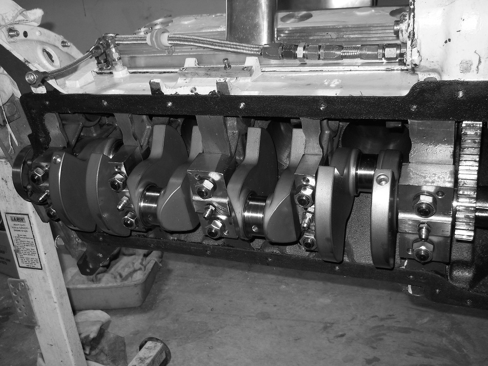

    I used Mitsubishi / Dodge Colt main bearings. mains.jpg 001.JPG
