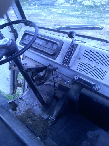

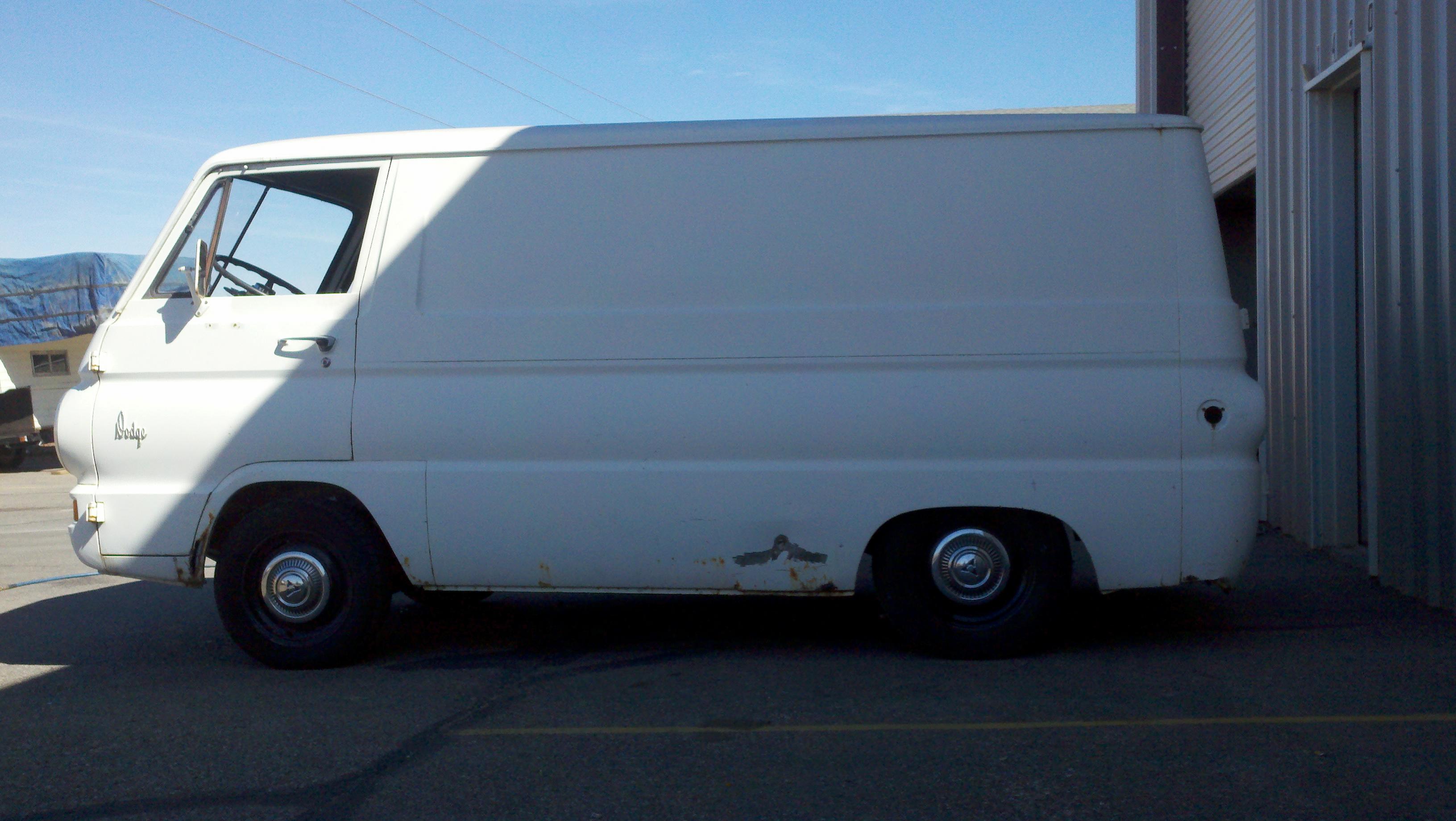

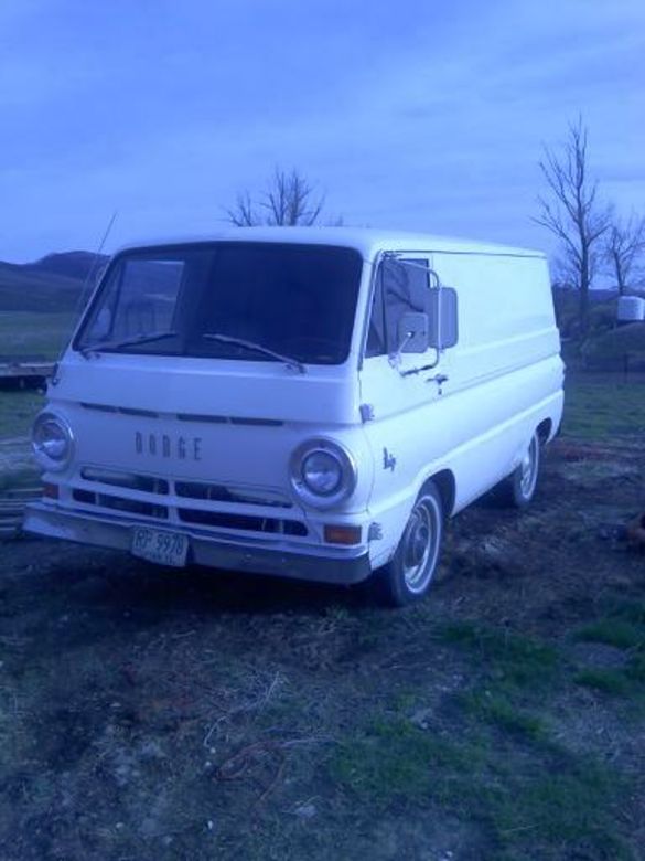

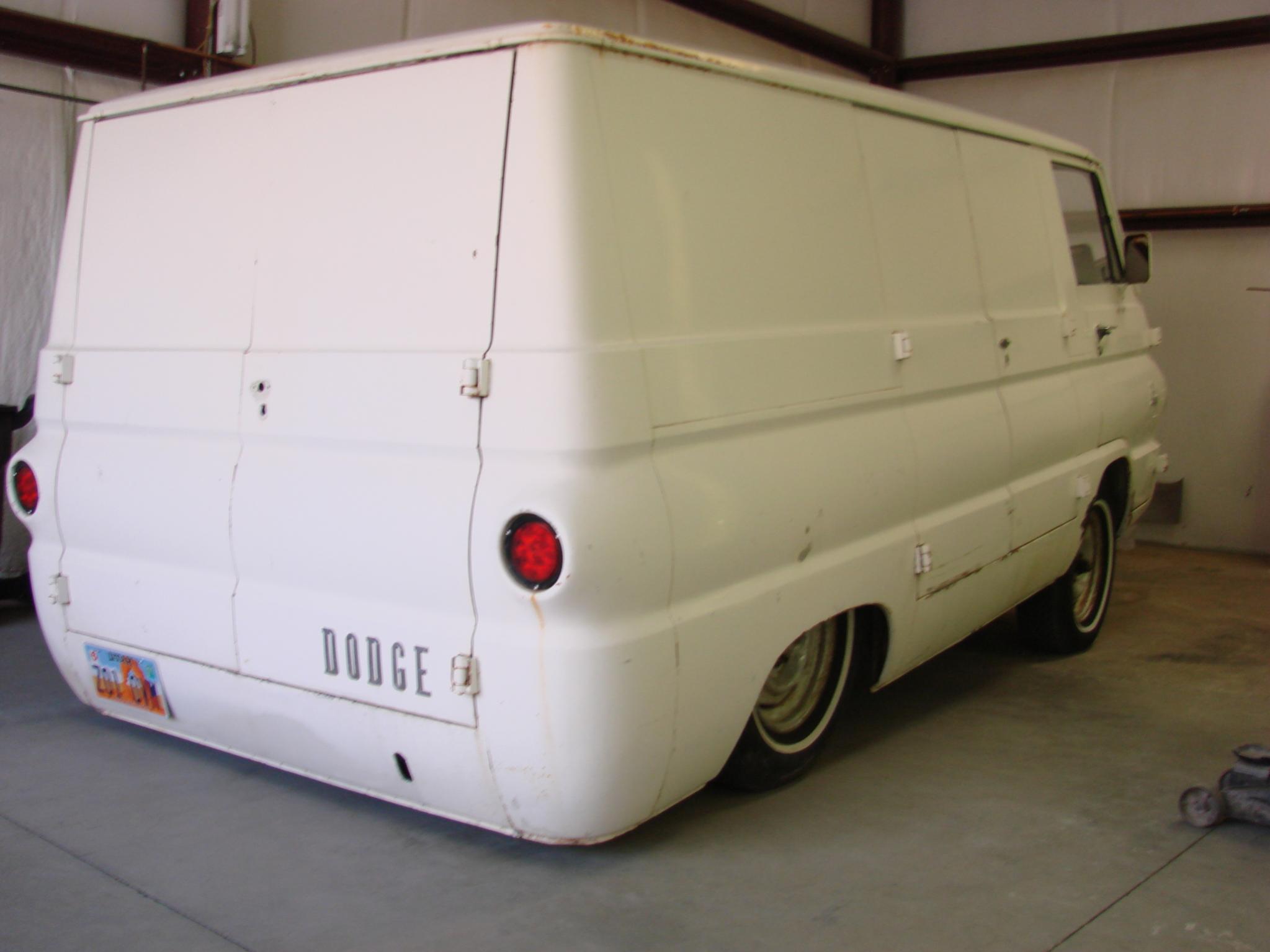

    Been meaning to do a build up on the progress of my van. Bought it 2 years ago with the plans of bagging and channeling it to lay body flat on the pavement. Going to post pics and info as it comes along to share the info because i have not seen a A100 on the ground yet.
    Here are a couple pics when i first got it....sorry some of the pics are cell phone pics so quality sucks!

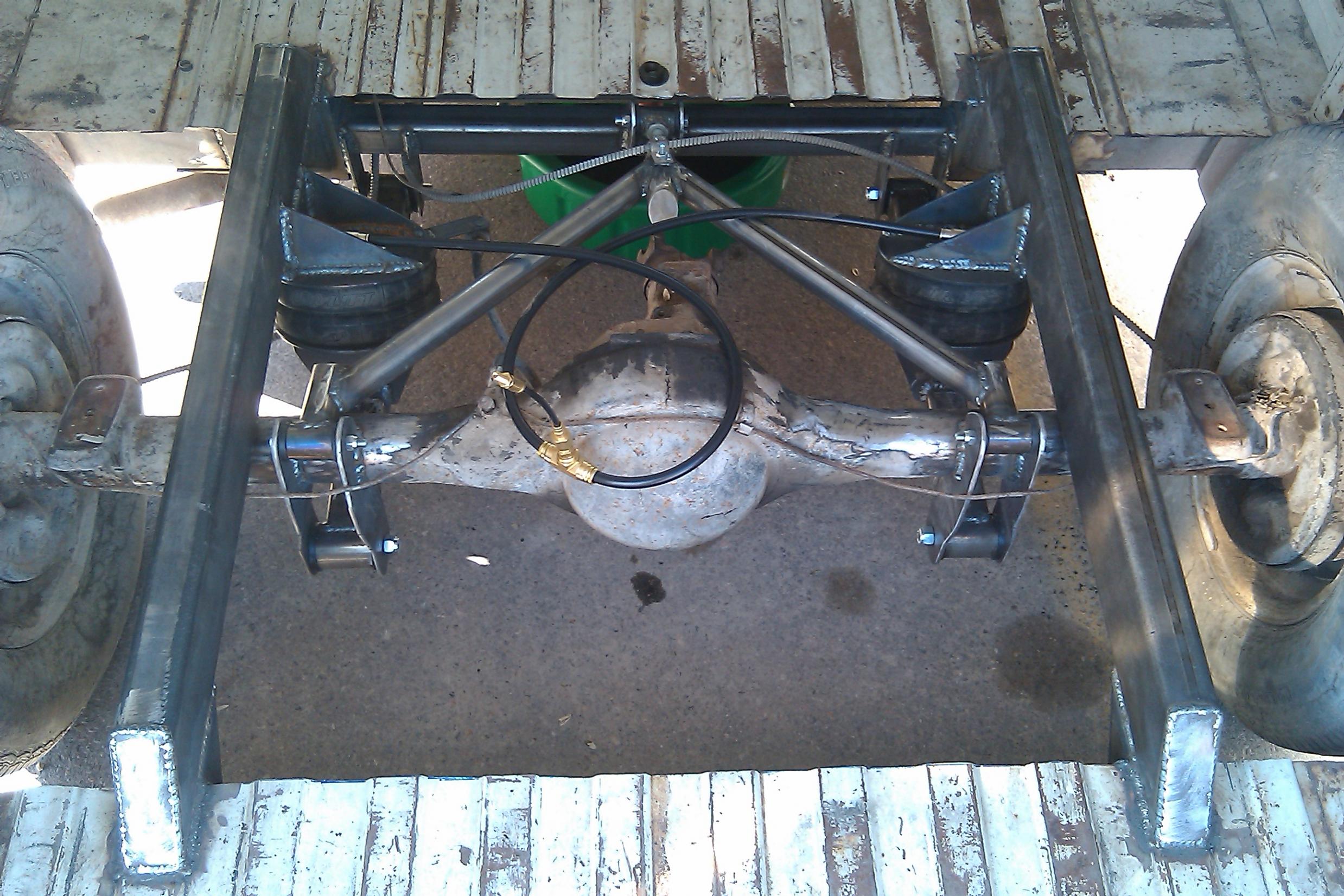

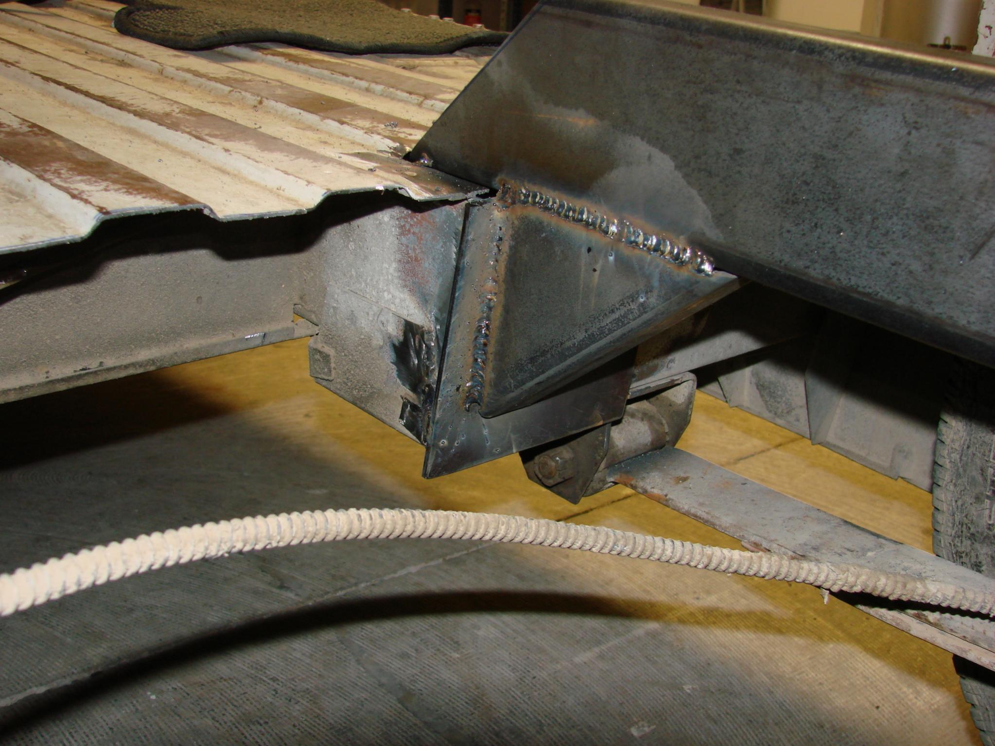

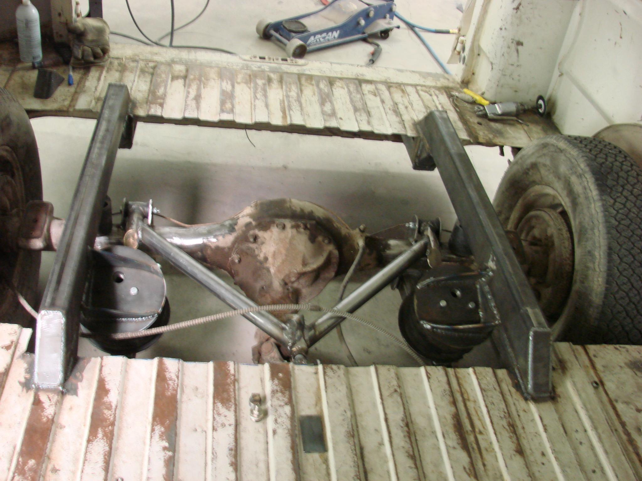

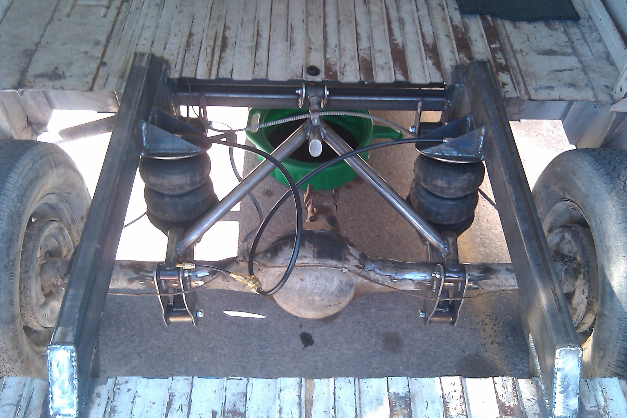

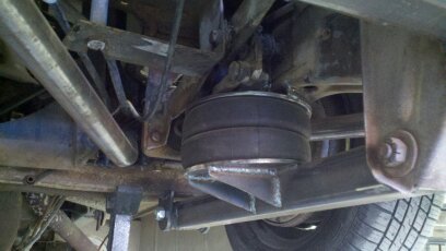

    Start of the rear suspension sub-frame and bag mounts....
  3. KSNPVMT
    Joined: Jun 4, 2010
    Posts: 95
    KSNPVMT
    from St George
    rear suspension done.....

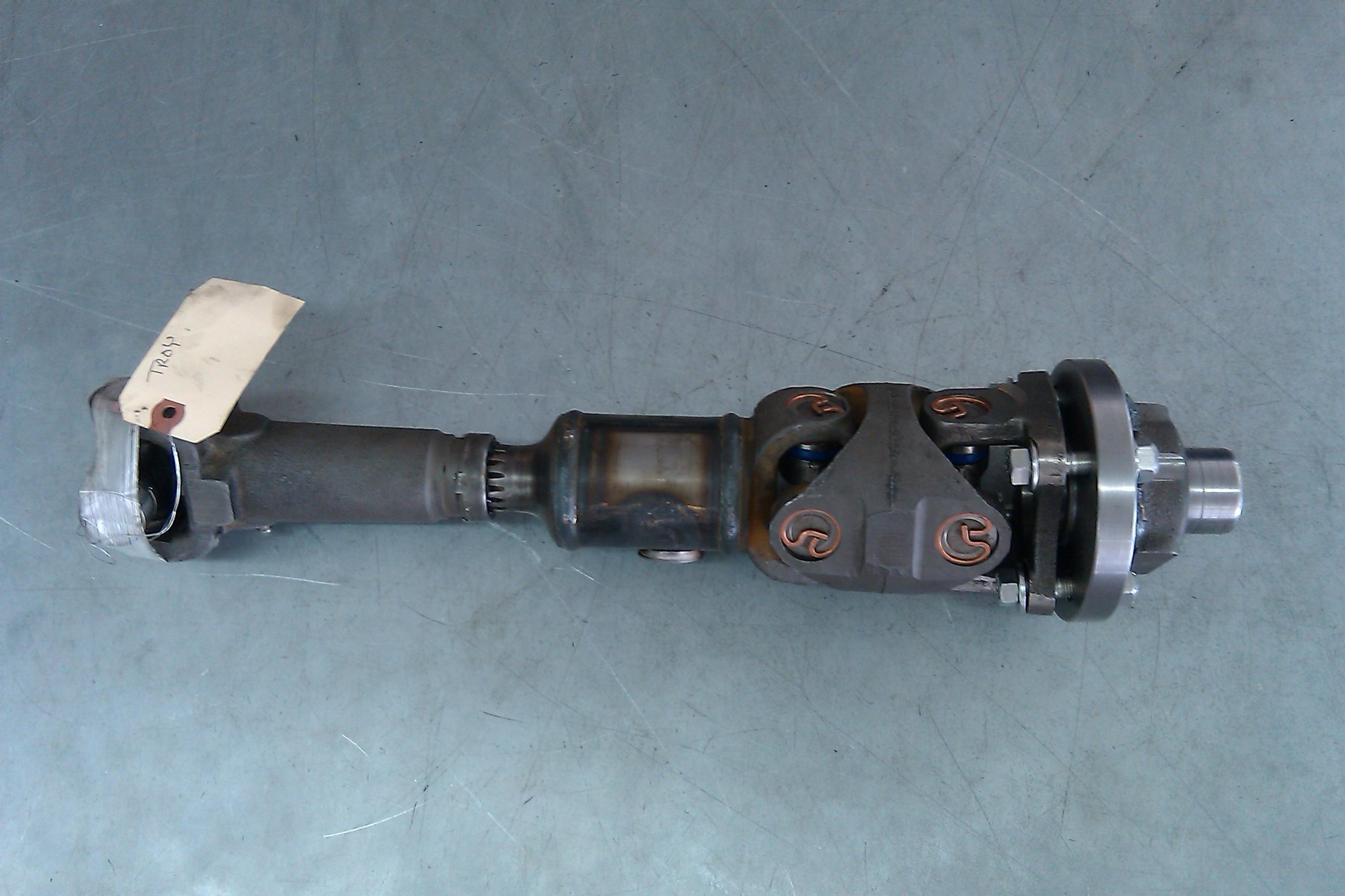

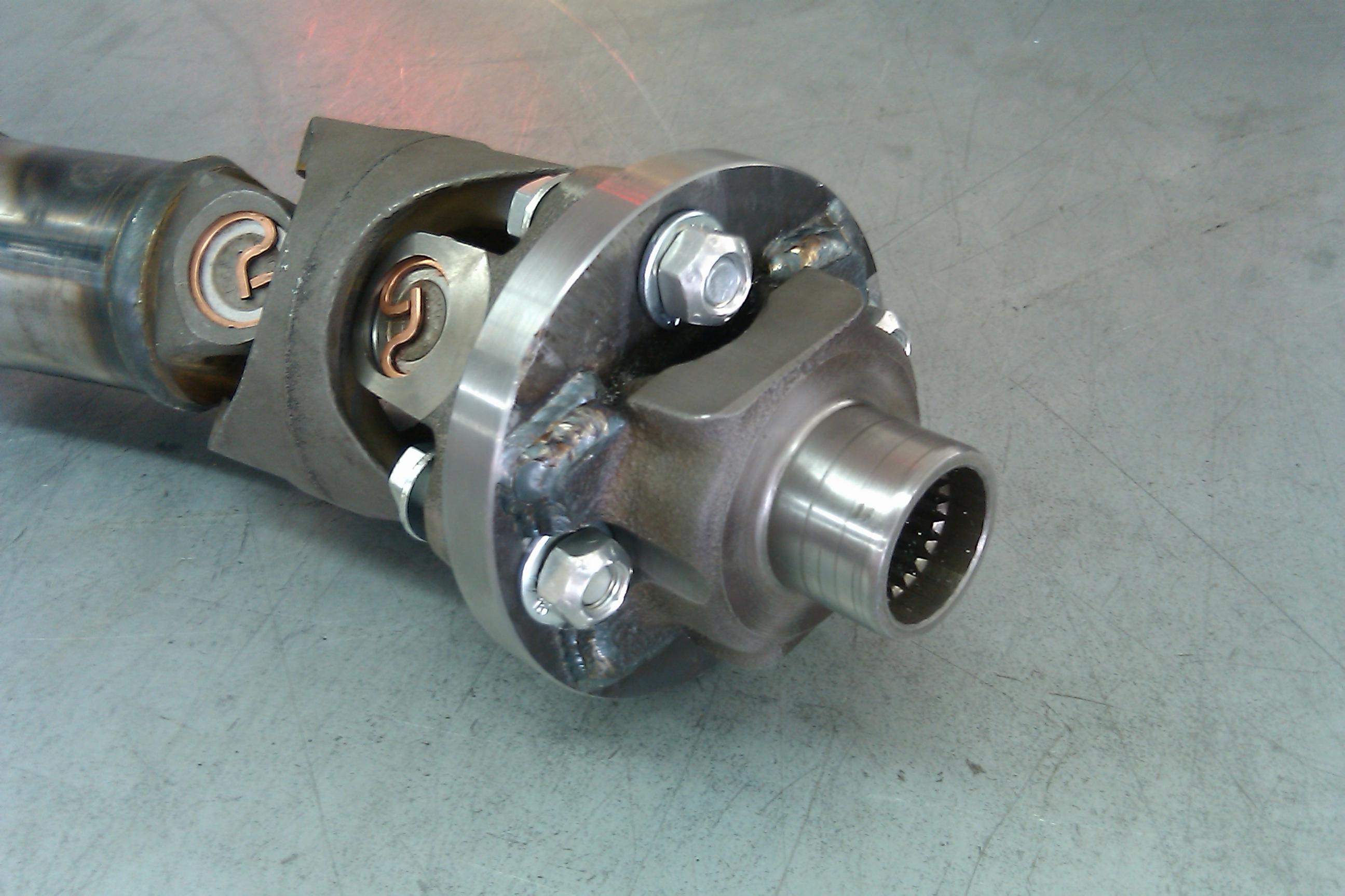

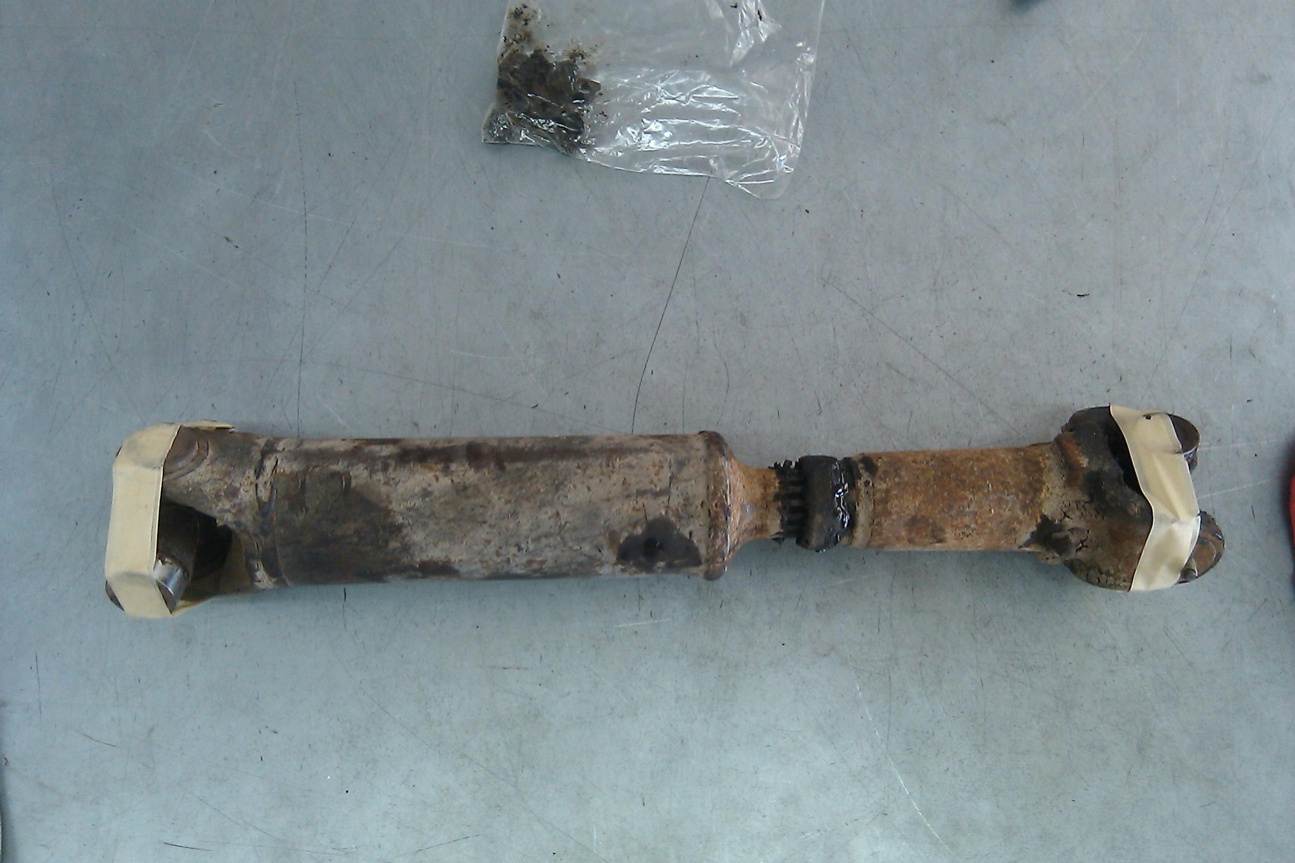

    The drive shaft was a major hurdle in my opinion! It had to have a cv joint in it because of the articulation it has and such a short shaft. Well... they dont make a cv yolk adapter for this trans because it wasnt popular enough i guess so I had to machine my own just so the shaft would not bind at full lift and full drop. This is what i came up with...

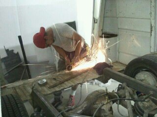

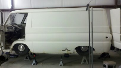

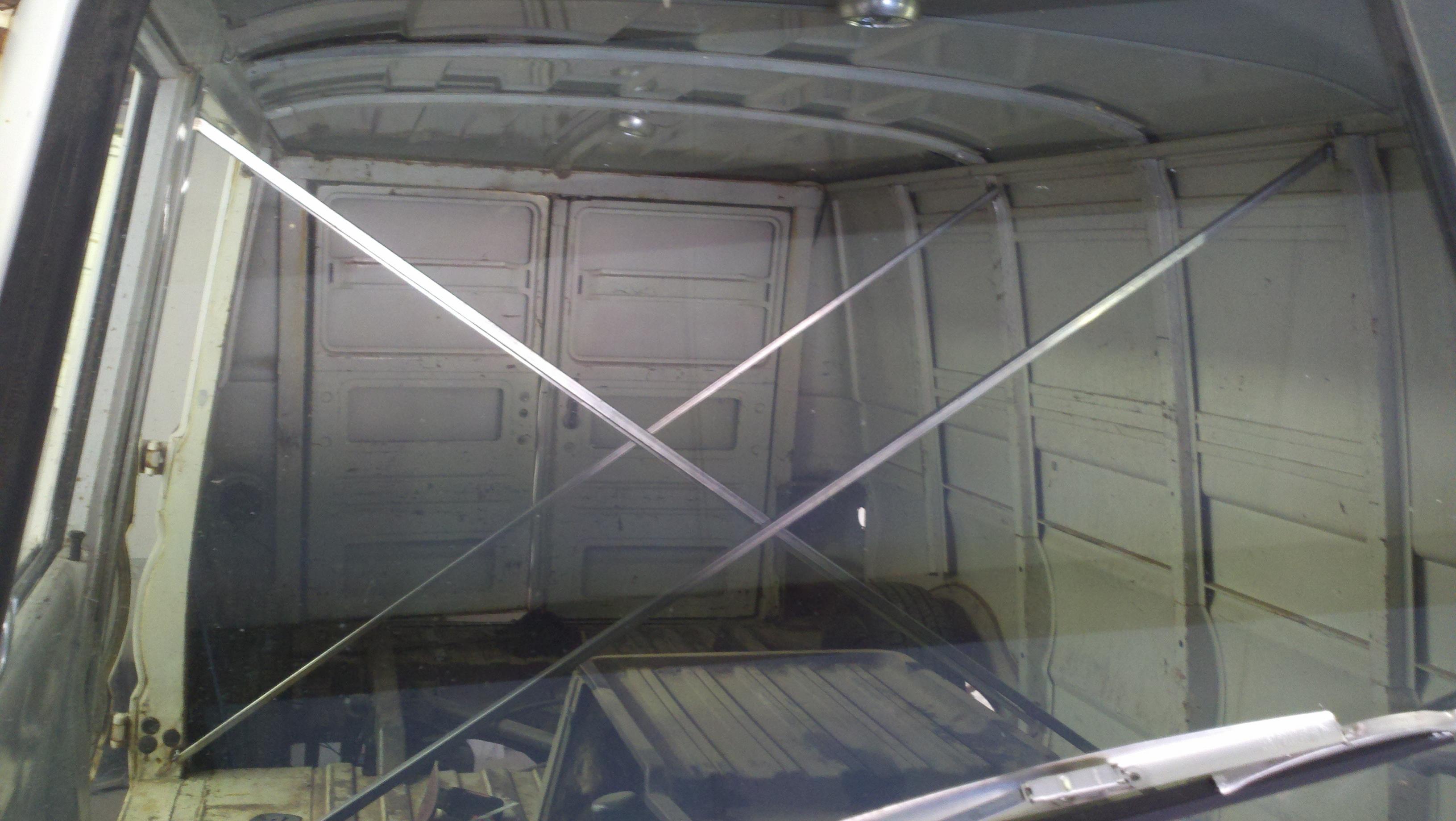

    With the suspension done (except for front shocks still to do) it was time to start cutting for the channel. Had to go 4" to run a decent size tire. The A100's come with 15" wheels...not 14" like the econolines. Did some bracing and started cutting....

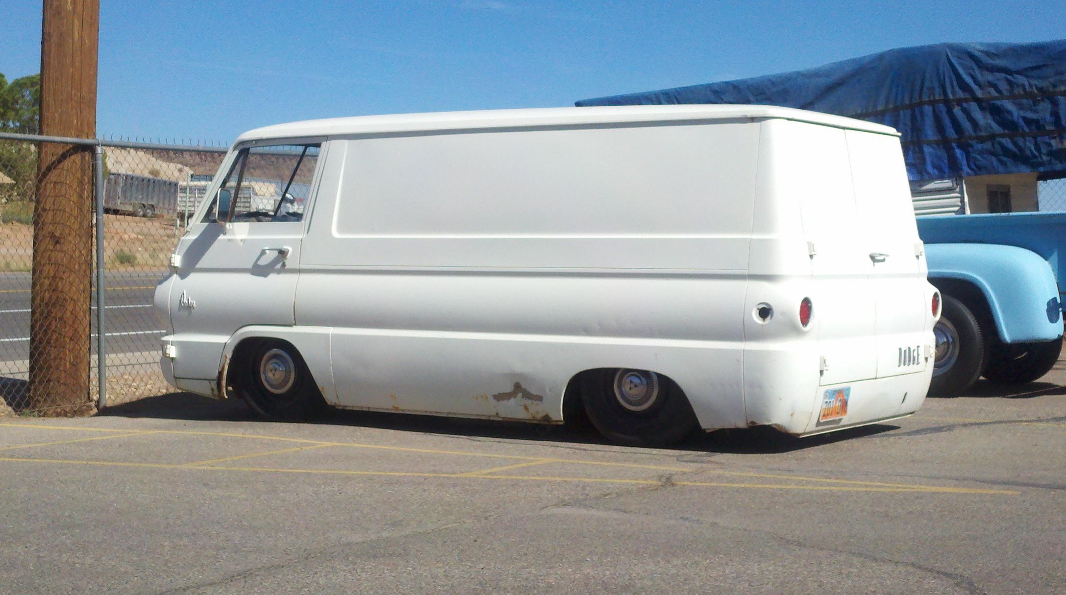

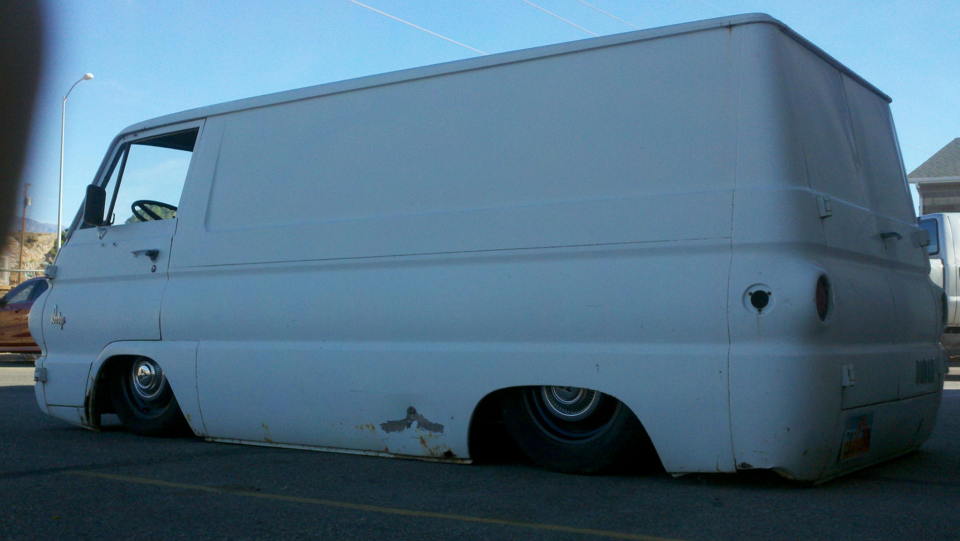

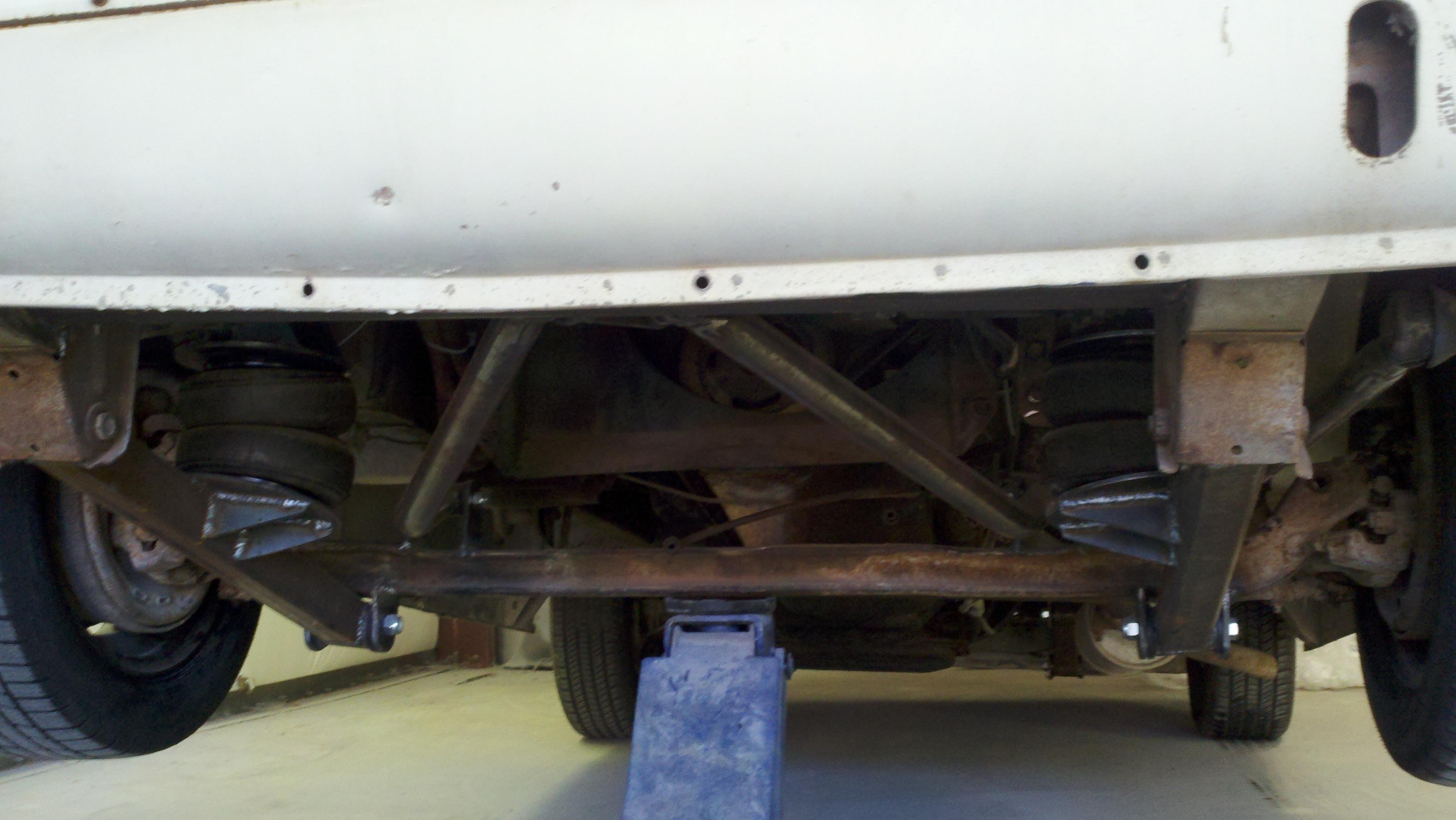

    I have about 3/4 of the channel welded back together but i am having to cut out some rust, replace fender wells, and change the floor up front a little before i finish completely. but here are a few pics of how it sits now with it at full drop & full lift.....

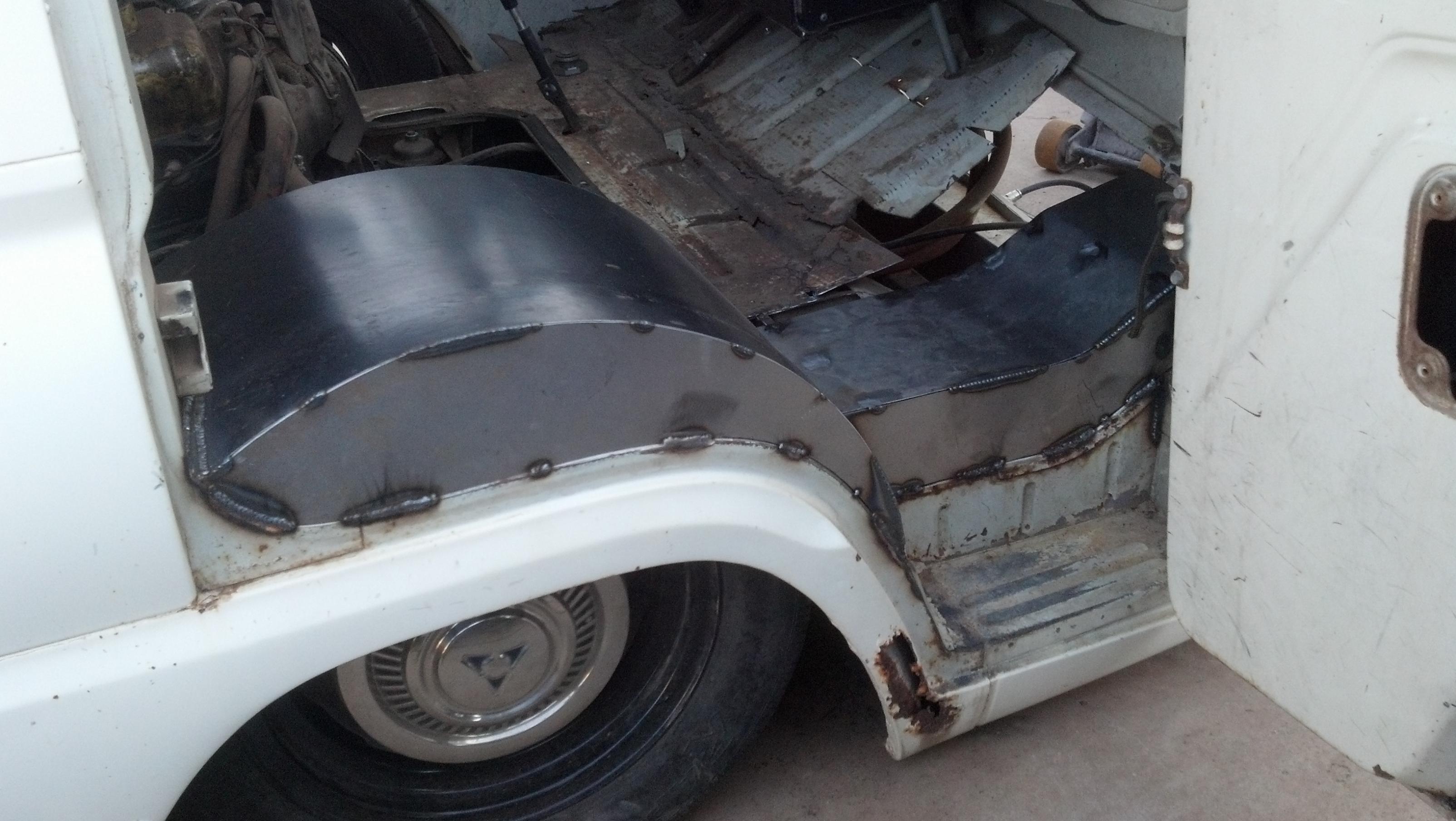

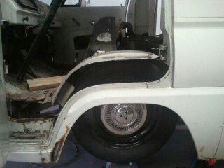

    Few pics of the fender wells and started working on the floor up front.

    The way you attached the rear "frame rail" to the unibody subframe is the same i did on my unibody car. althou mine aint BDed.
