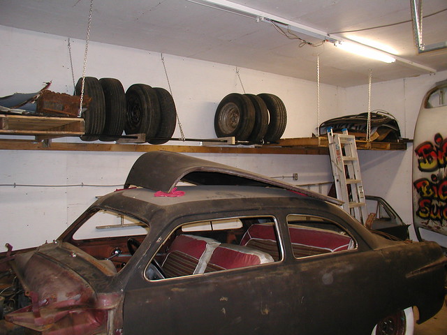

You know that story of the over-excited idiot who buys a car sight-unseen on the interweb? Asks all the wrong questions, looks at the wrong photos and eats whats put in front of him? I'm that idiot. I didn't set out to get into a full-on body off resto project, but I had a boner for a chopped shoebox and a nice pair of rose colored glasses so I jumped. Fools rush in. But this thread ain't about sour grapes, it's about lemonade…
Let's start with Bob Bleed's highschool sweetheart. It's a running '51 Ford sedan, chopped 3.5", needs some cosmetics…
So after some new tires, brakes, headers and exhaust, a nice '55 Dodge grille direct from Bob Owens, and a rattlecan paintjob it was roughly presentable enough to drive it to Cheaterama, the Scrap Drive and the Hunnert Car Pileup…
If you looked at it from the right angle, in dim enough light and a cool enough setting, it even looked almost ok…
After I finally got it back to Ontario and started tearing it down, the floors had been "patched" with galvanized sheet from an old shed and a little duct tape…
And covered up some nastiness…
Niiice...
Rusty goodness...
Oh, and the frame was—for lack of a better term—fucked. As in dangerous and non-salvageable. Mere technicality. This shot is getting a bit ahead of the story, but you know where it's going anyway...
So, being on a budget, I started researching an S10 frame swap. No way I could find a stock frame right? Well, it just so happens that about this time Jaker was advertising parting out a '51 shoebox. Got a solid frame? You betcha.
Another trip to Milwaukistan for another shitbox…
Jake threw in about a car and half worth of extra parts in the deal. Jake is a freaking' rockstar...
Back in Ontari-ari-ari-o. And then there were two…
Don't get too acquainted, this ain't going to be a long happy relationship. I just bought some sawzall blades...
With some other stuff taking up space in the shop…
(my GF's brother bought this l'il Trumpet in 1974 for 75 bucks! Going to restore it someday )

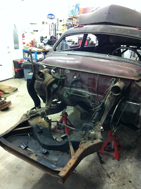

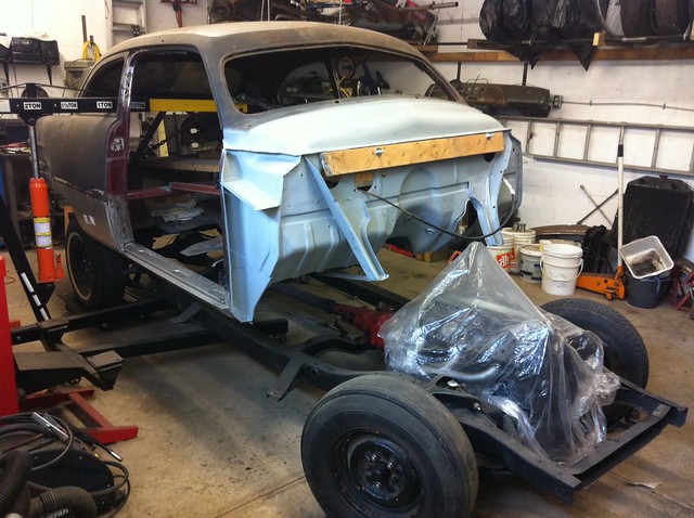

Ok, so let's crank this puppy off the frame...
I pumped, jacked and pumped some more. Then I decided to lift the body off...
Even non-car-guy friends come in handy sometimes...
And oot she comes...

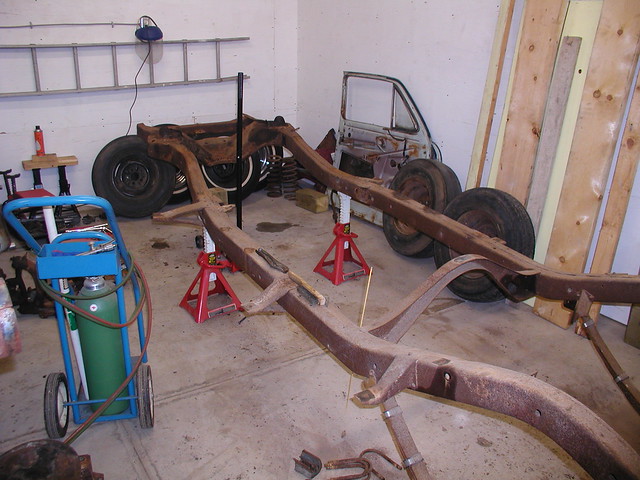

Voila. One solid frame that'll get sent out for sandblasting and paint...
And a victim...

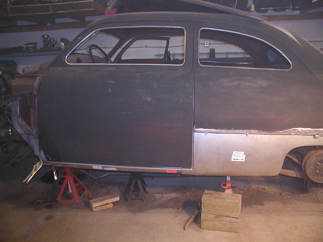

Some frustrations, but most days I try to stay relaxed. Keeps me from thinking about work.
Trying to convice myself that I might actaully get somewhere... someday (thanks to Mr. Moriarty for the inspiration)...

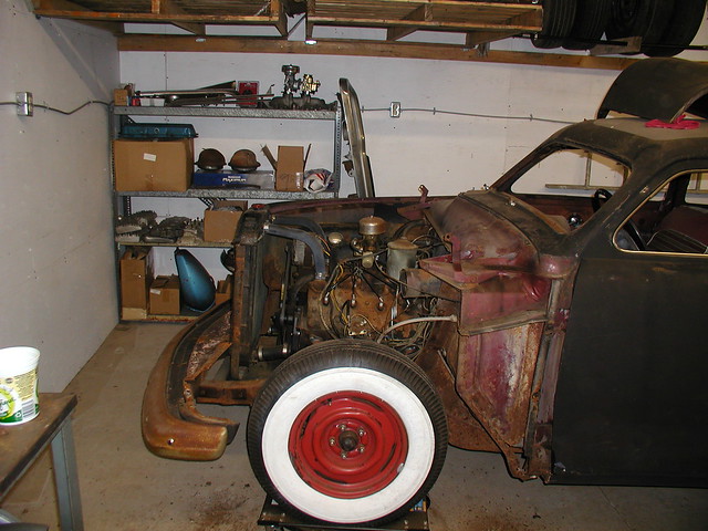

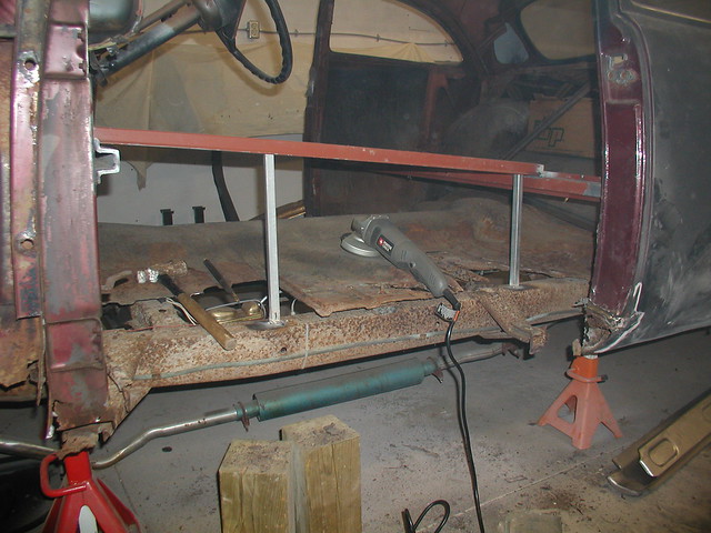

And since the garage was getting mighty small in a hurry, I decided to try to get organized. Quickie racks and shelves...
Starting the tear-down...

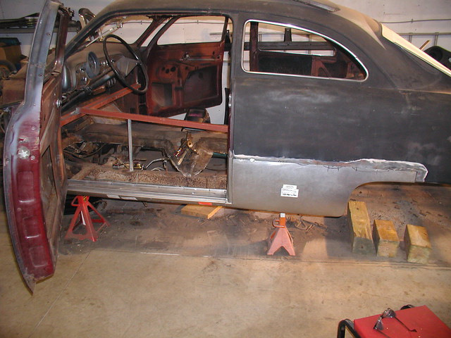

Finding lots of ugliness...
And some interesting previous, um... bodywork?
So when in doubt, cut the mo-fo out...
At some points it's like, Dude, Where's My Car?
But it feels pretty good when you start seeing steel where there used to be cancer...
Damn, this shit's easy! Look how fast it's coming together!

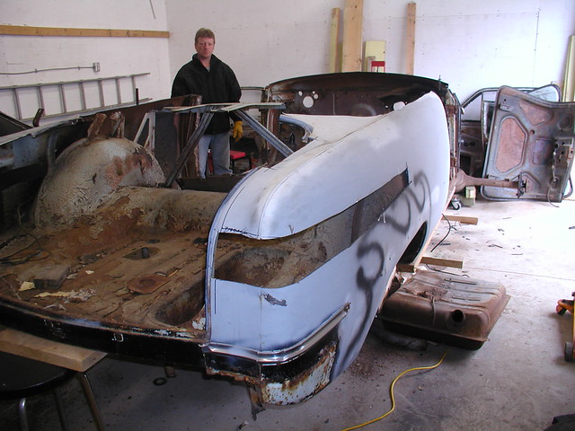

While we're at it...
Let's cut some more!
Nice wheelwells...
Cut 'em out!

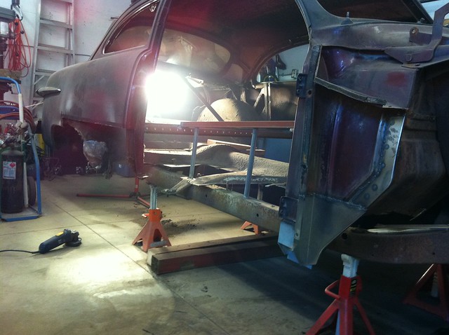

I'm cutting away like a madman, and I found PBRmeASAP's wrench that I dropped inside the fender last year...

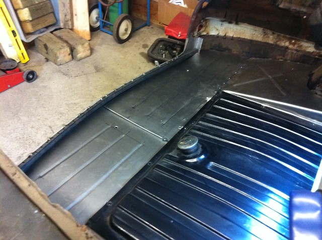

Ok, now test-fit everything, with the door on, to make sure stuff fits and the door closes with correct gaps. At this stage it's all just clamped in place...
And tacked in...
I've bought most of my patch panels from Mac's, and they are mostly EMS sheetmetal. The quality is great, pretty much everything fits and works like it's supposed to, although some directions would come in handy for eejits like me who are diving in for the first time. One exception was the inner rockers, they didn't make any damn sense to me so I made some one-piece ones that seem to do the job...
Oh, and in case you were wondering...

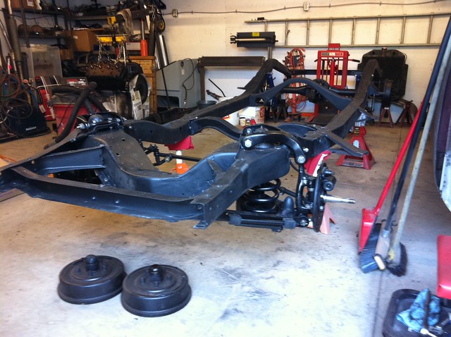

Got the frame back from the sandblaster. $250 for blasting and satin epoxy I thought was a pretty good price...
It starts to feel like progress when you go from this...
to this...
It's all stock suspension, Aerostar springs up front, 3" lowering blocks in the rear. I won't be laying frame.

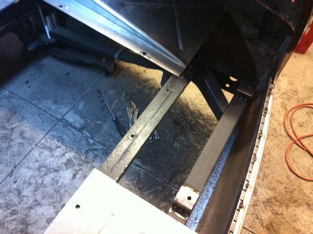

The parts car was in rough shape, but it was still a bit of a bummer to cut it up. There's a lot of it going to end up in my car, hell in some ways it was better than my car. If Mr. Bleed hadn't done such a nice job on the chop on my car it would've been the one heading to the crusher.
Pulled the dash to get at things. Dash needs to be completely restored anyway...
Firewall cleaned up nice. Yep, Mexicali Maroon. I thought about keeping it that colour, but I bought a complete interior that is in great shape, but it's dark blue. Maroon ain't going to work.
Got tired of barking my shins so the front clip got whacked...
No more maroon...
No more frame... the scrap guy loves me...

There's more where that came from... and a twist in the plot...
Hey look Ma, more rust! What a surprise...
And more cutting. I should've bought stock in Norton before I started this project, I've gone through a lot of cut-off wheels (which I find more accurate than a sawzall)...
Steel!
Hey what's all this about? He wouldn't would he?
Oh yes he would...
Not sure if the dual taillights is a dumb idea or not, and cutting them in scared the shit out of me (they needed to be damn straight in relation to the ones above, and side to side), pretty nerve wracking, but I think I pulled it off...
I can't stand far enough back to get a good shot, and every photo makes them look crooked, but they're actually straight...

Levitating the body again...
to get it back on the frame to get things aligned. It'll come back off the frame once the floors are in so I can do the finish welding, clean and paint the underside...
Now comes the fun part. Floors. From what I could figure, prefab floorpans from various places are expensive and sometimes not great quality. I read a bunch of threads here on the HAMB and thought I'd give 'em a shot from scratch.
Again, I don't have a ton of tools or experience, but I'm a keener! Yeah, whatever. I spend some time and very little money building this hillbilly bender/bead roller combo...
The Harbor Freight bead roller has some flexing issues, so I ran out and chopped down a No Parking sign and used that to beef it up...
Finnrodder made himself some nice dies to replicate the stock beads in Ford floorpans...
He was kind enough to send me a sketch of his plans, which I fancied-up a bit 'cuz I was bored at work one day (note: the shaft diameter in these plans is too tight, I had to have it reamed out)...
and I found a guy on Canadian Rodder to make me a set...
I ordered 18ga from Metal Supermarket, and had them put a 90 bend down one side. That way I had a nice accurate edge to work from. I got 6 pieces (3 per side) so it would be nice and manageable for a weakling like me.
Here are my first-ever beads. Not going to win any awards, but close enough for the girls we dance with...
I don't have a photo, but I used a Sharpie and drew a centreline on the fat die so I could guide the sheet metal through. I also used a C-clamp to keep things in line. Didn't always work, some of them are wonky, but that's what carpet is for right?
Just roughly placed in, but looking surprisingly like a floor...
I think I paid $150 for the steel, rough-cut to size, and flanged. I think all this from Mac's was looking like a grand or so...
I'm ok with a few wonky beads if I can save $600-800.

I don't have photos of the floor braces in place, but they're there. I drilled some holes so I can access the bolts, and I cut an access hole for the brake master...
Lots of welding left to do, and a few screw-ups to fix, but I'm reasonably happy with 'em.
