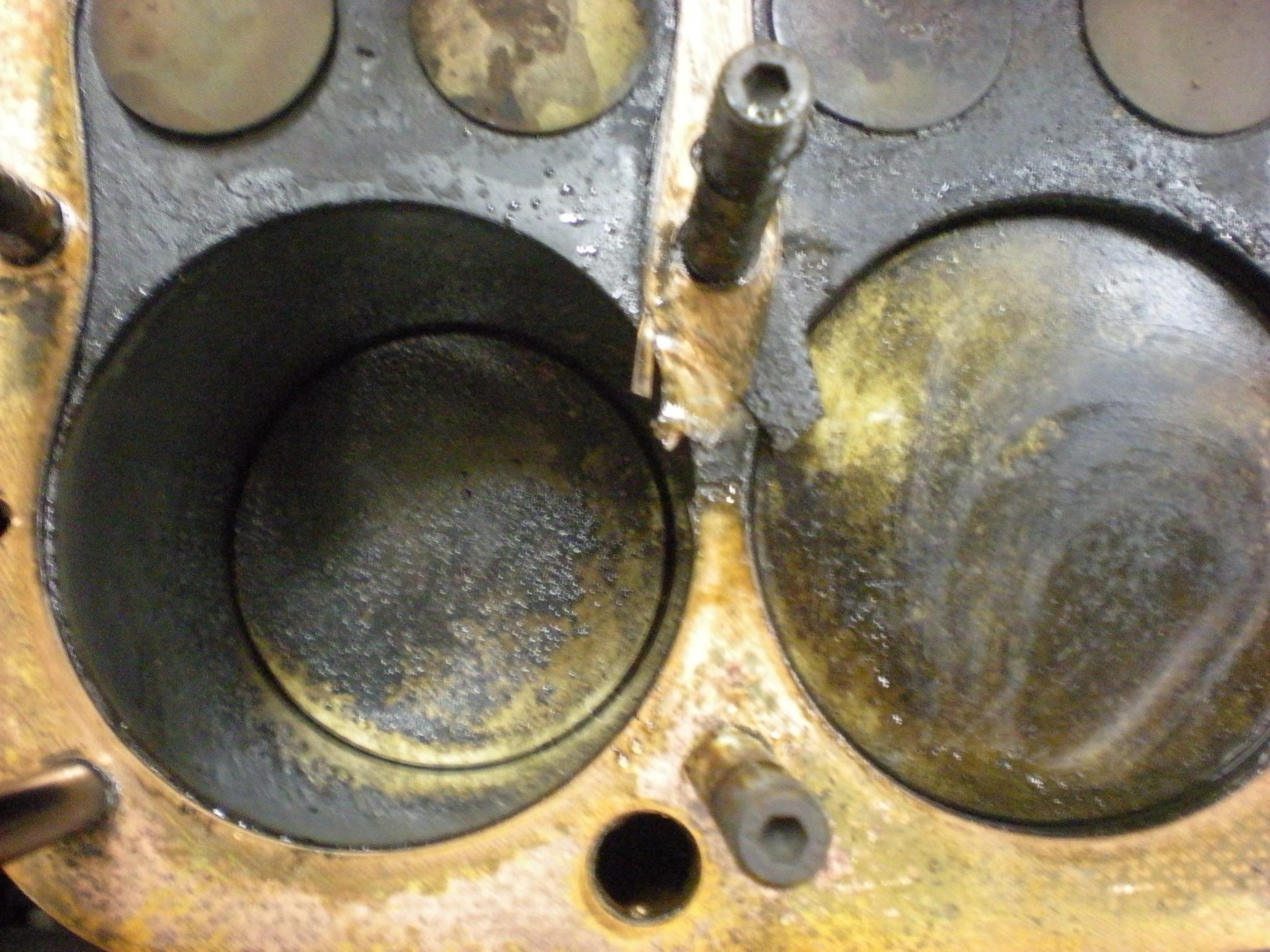

    I might have missed it last mouth but how is your engine CRAZYDADDYO

  18. Crazydaddyo
    Joined: Apr 6, 2008
    Posts: 3,346
    Crazydaddyo
    It was the head gasket. The web between #1 & #2 was blown out. It's been fixed and is running again.
  19. Wow those combustion chambers are really clean. Forgive me Dan but is this the same B Diamond you have been running for the last few years? And how long has it been since you last had it apart before the failure?-Weeks

  21. Crazydaddyo
    Joined: Apr 6, 2008
    Posts: 3,346
    Crazydaddyo
    Yes, this is the engine that I've been running for the last few years. It has been together for about two years now. The head had some carbon build up, but I was also surprised at how "clean" it was considering how much blow by it has. It confirms my thought that it is running lean on the top end. It doesn't look like there has been any detonation though.
  22. Bluto
    Joined: Feb 15, 2005
    Posts: 5,113
    Bluto
    Guys if you had water in the combustion chamber, even a little resulting steam will blow the carbon off pretty quick
    Sorry Dan but you may have only patched the problem for now
    Give me a call
  23. Crazydaddyo
    Joined: Apr 6, 2008
    Posts: 3,346
    Crazydaddyo
    Because the gasket failed between the two cylinders, no water went through the chambers.
    I agree I haven't fixed the problem. But, I like to experiment and because I don't have a bunch of money in this engine, I feel it is a good test bed.

  29. Bluto
    Posts: 5,113
    Bluto
    Crazzzzz
    Water can enter the engine in many ways. Blowing a gasket at the narrowest(weakest) place is not normally without some real cause.
    I think it's a good idea to find out why. Do you have a crack in the intake port? Did someone wash the car and get water down the carb? Drive in the rain?
    It's funny how driving on a foggy night can make the motor sound different at idle.
    You may have a leak that only opens when the motor is warm
    Is the block sleeved?
