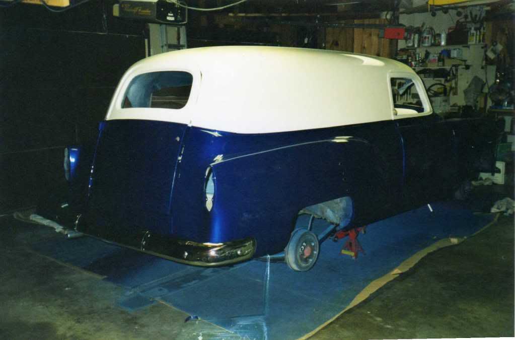

    So, about 13 years ago my dad and I tried to restore this sedan delivery- Thats me as a snot nosed, teenaged, know nothing know it all-
    We didn't know what we were doing really at the time, and just patched the cracking bondo, blocked it out, and painted it. It came out really nice, and surprisingly lasted 8 or nine years before it started to crack.
    [​IMG].
    I enjoyed this car for years, and we built several car in that time, so when it started to crack I told myself some day I'd re-do it correctly. But I never had the time or the money, and It still looked ok from 20 feet so it got put on a back burner, and I just drove it.

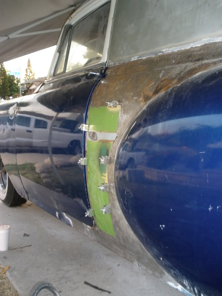

    When I went stripped the driver side i found lots of collision damage, and poor repairs. I always wondered why it sounded hollow when I closed the drivers door and not the passengers.
    This is after I started cutting the metal, but you can see what is going on here. They replaced the ehole door jamb from the beltline down, but they didn't remove the old metal first, and the welds were terrible. Also the whole side was just too far in.
    The repair panels are made out of an extra fender-
