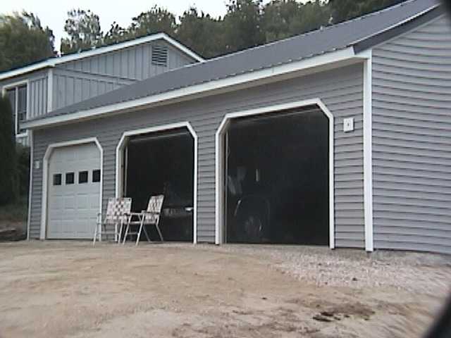

    I built my 36x26 three car two years ago on a slab.I was quoted $7500 for the excavation and slab but I got really lucky and my son in laws father got the equipment and an operator for free and the slab cost me $2500.$1400 of that was the concrete.
    I built the actual garage with a lot of help from my friends.It's vinyl sided with a metal roof.The cost was $8500. I found that the metal roof was actually cheaper because you screw it down to "purlins" made of 1x2's nailed over the trusses so you don't need plywood,tarpaper and roof shingles.The roof is guarenteed for 50 years so I know I'll never replace it.
    Another thing I did was rent a nail gun (I have a compressor ) and Sears sells a plastic device that measures 16" on center when you're laying up your walls on the ground.With a little practice two of us were building 10 foot walls 8 feet high in about 15 minutes.
    I also used pressure treated plywood for the bottom four feet of the walls and particle board for the rest.I put the walls on 6x6 pressure treated wood.
    I got four quotes for material which ranged from $8K to $10K .
