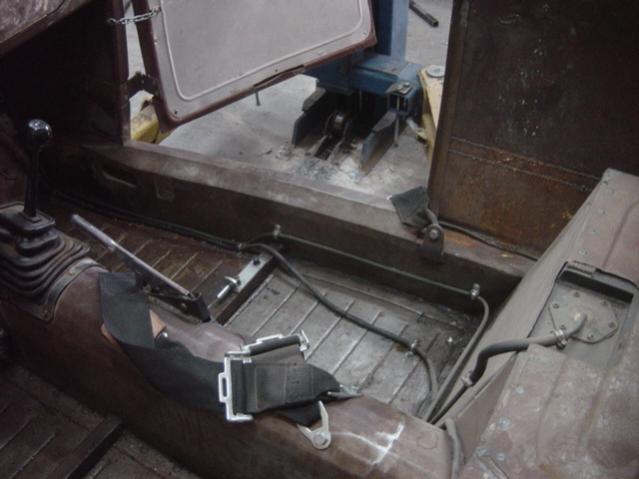

    My goal was to get the total height of the car at or under 4', with a reasonable ground clearence.
    And it needed to be comfortable enough for me to take it on longer drives, if I wanted to ( I'm 6'2" )
    So building a regular Highboy was out, there just wasn't going to be enough space...
    I found a bit more space by using Sportscoupe Quarter Panels ( that gave about 7 or 8" more interior space because the cockpit goes back farter than a Roadster does )
    That meant I had to section them a bit to make them line up with the Roadster Cowl, and I had to make my own doors out of 2Dr Sedan skins & Roadster insides ( lengthened )
    But that still wasn't enough, so I dropped the floor down so it was flush with the underside of the Framerails ( aftermarket '32 )
    Here is a pic looking down.
    And one without the seat.

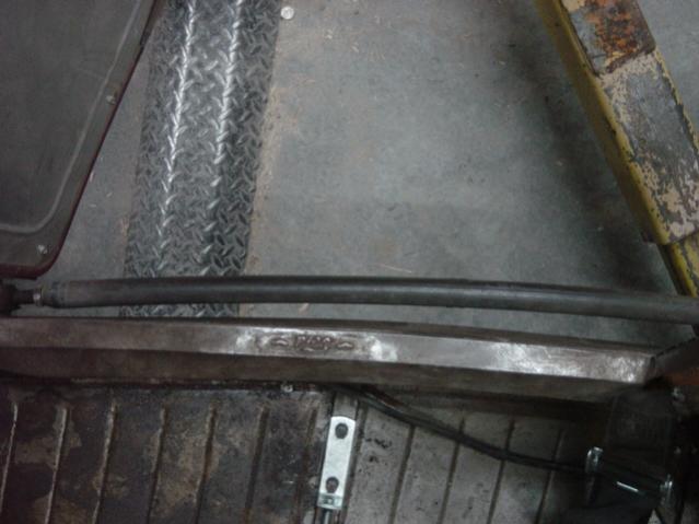

  9. metalshapes
    Joined: Nov 18, 2002
    Posts: 11,138
    metalshapes

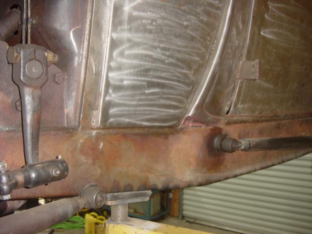

    Since the Framerails are 6" tall, and the subrails are at least one more inch that gave me more than 7" extra interior space.
    This pic is of the pass side foot well, and inside of the right Frame Rail.

  10. metalshapes
    Posts: 11,138
    metalshapes

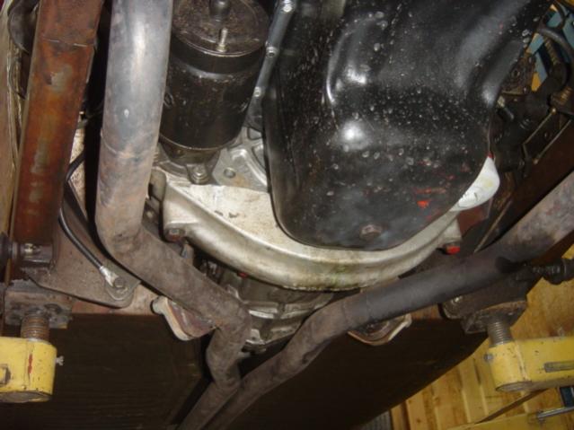

    Also, the Tunnel is closed off underneath, to give the Spine some extra strength.
    But its stepped up so the Exhaust pipes have a channel to run through.
    They stick out about 1/2 of the diameter to give them a chance to cool, and to have a "soft" barrier in case I hit something.
    ( I 'd rather mess up an exhaust pipe than rip up the underside of my car...)

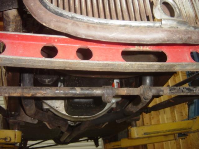

    The only two Crossmembers are the ones that hold the Buggy Springs for the front & rear suspension, so there was no strong point to hang the rear off the Tranny off.
    ( 3 if you count the one that holds the front of the engine...)
    So I used a early cast aluminum Scattershield, that uses '55/6/7 mounts.
    And the engine mounts are '55 to '57 Chevy as well...

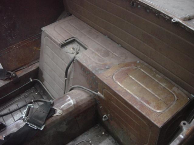

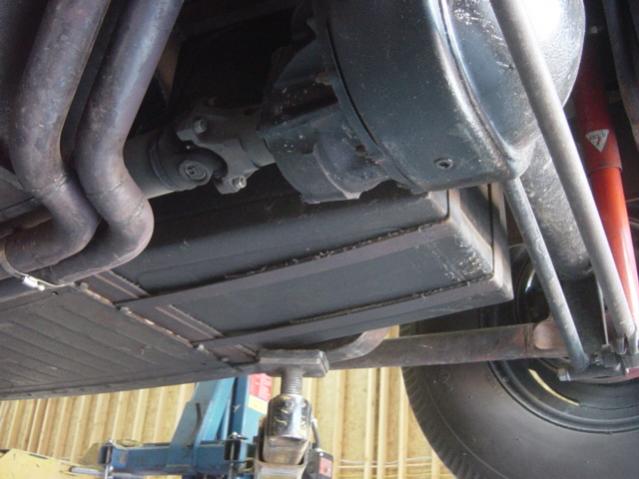

    The gastank mounts from underneathand is completely shielded from the passenger compartment.
    ( once I make a little cover over the pick up tube...)
    It sits on the right hand side of the car, just in front of the rear axle.
    ( the best place for weight distribution, center of gravity, and safety )
    I made it out of Mild steel sheet, it has baffles, and its coated on the inside against rust.

    The Battery sits on the left hand side, behind the seat.
    And goes in from the top.

    Rear suspension.
    The '57 Ford rear axle is mounted to a pair of '36 Bones, that I kept as long as possible.
    ( I wanted a bit of flex because I was not able to have them pivot under the car, and the pivot points had to be on the outside of the Rails )
    In line with the A Pillar/ front of the door seemed like a nice spot...
    I made them follow the curve of the Frame Rails by Heat Shrinking them.
    ( an O/A flame, a bucket of water & a rag, and a day per siide...:D )
    The pocket for the pivot point attaches the Framerail to the Boxingplate, and its oval so I can get a Cotterpin in...

    The character line in the Rails ends exactly at the edge of the Cowl.
