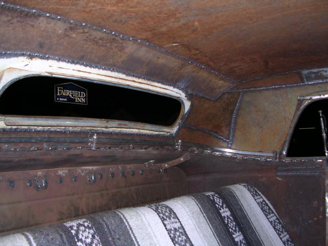

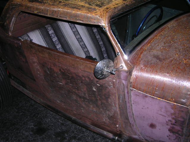

    I love that car.. Can I see how you attach the top? Specifically at the windshield?

    The top attaches to the windshield posts like a Roadster top does.
    A bushing that slides on, with a setscrew ( bolt ) to hold it there.
    At the back its held down with 1/4" nuts & bolts ( 5 ...)
