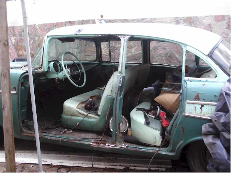

    Here's some pics of the progress on my conversion. My 10 year old niece and I started this Saturday.
    We started on the '57 since it's still too cold to paint the Austin.

    Update pics.
    4 door to 2 door on the driver's side and the straight axle installation. The one picture of the door work has the seams smeared out.
    The wheelbase is extended 4".
    I think I'm going to end with a longer axle before it's done. The 46" Speedway axle is a tad bit short.

    I think you could probably figure something out to get the rear windows to work if you were careful about cutting up the original door frame so you could reinstall the regulator, maybe slightly modified. There will be window track all the way around the inside of my car. So you could get window felt and install that too.
    There's nothing wrong with the dip. It's untouched. You cut the rear door down in the front about 6" in front of the dip, so it stays in exactly the same place it was in before you cut the door.
