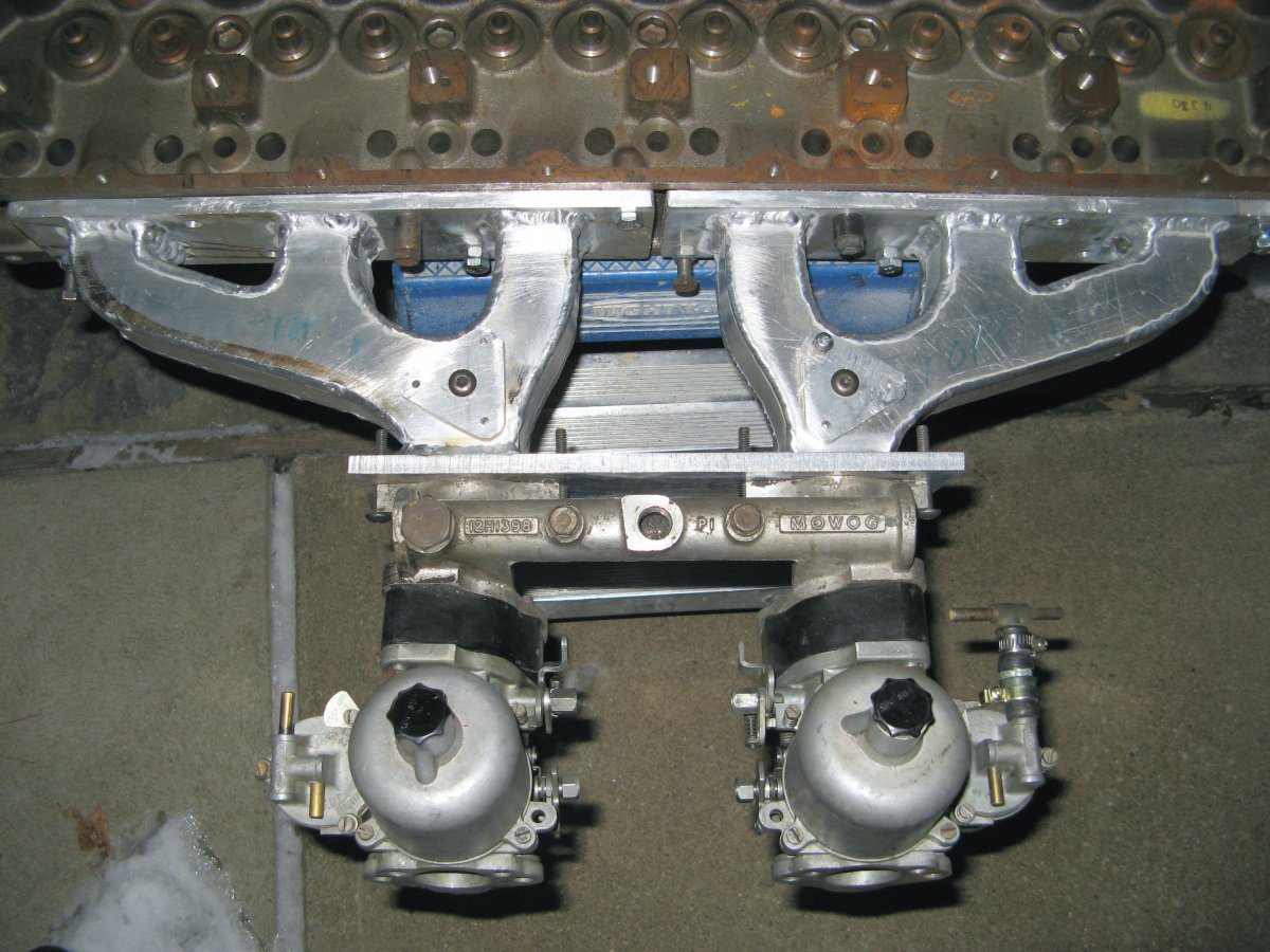

    I built this intake last week for two SU carbs. It usually takes me about two hundred hours to fabricate an intake manifold using hammerform dies. This time I decided to make it out of flat aluminum stock. It only took about 40 hours to get this far. I still have to make throttle linkage and an equilizer tube, plus polish it all up, but you get the general idea. Does it look old fashioned? I did zero calculations on it - just grabbed a pencil and sketched the runners kinda seat-of-the-pants like. This head is an uber rare cast iron crossflow piece that was an experimental prototype, never put into production. Sorry, I don't know where you can get one.
