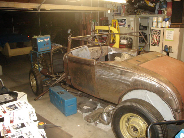

  1. Its been a long while since posting anything about the car. Today has been the first day in the last 6 - 8 Months in the sunlight. I have been working my tail off for the last few months making as much progress as I can before the year end. (Sorry to the HAMB Chop car...but she's next after I get this one on the road :) )
    It started as (and still is in some respects) a 28 Sports coupe (Thanks 'Link'), that was destined to the scrap heap, but with a little determination and hard work, its become what it is today.
    I have always wanted a roadster, but time and money never were on my side. When the money was there, nothing could be found...vice versa. So I decided to go my way with the car to achieve close to what I have always wanted. Im focusing on a Pre-war Salt Racer Look.
    Im so happy w/ this car, I cant wait for the chance to fire it off to take it down the road.
    The car will be powered by 4-Banger w/ dual 97's, B-Cam, Early Cast Iron Winfield Head, Deuce distributor and lakes header (which is on the stand ready to be installed); has 39 Trans for gear changes, Kiwi Quickchange 3:48/4:11 gear set, Deuce Truck grill, 38' Ford Super Deluxe Dash, 40' steering wheel and 35/36 Wires Powder Coated to match orignal Ford gauges in dash 'Gold'.. Lengthened trunk area another 4-5 inches (yeah I know...roadster wannabe :) ), Roadster Stanctions (thanks Hamber for tech) and 4" chopped Roadster Windshield. Doors were cut off, narrowed, beaded and topped. Custom inner door top panels formed to wrap into the dash.
    There is so much more to do; Im will make a convert. top and side curtains for the car, Install the motor, brakes and electrical. but it should be a breeze compared to what I have already done. :eek:
    Ill keep posting updates as I move along.
    Huge thanks to Vaphead at Riley Automotive; for the parts and awesome service.
    My goal is to be running and driving by mid December.
    Enjoy.
    P.s.: I need an early electrical tachometer to fill my clock hole in the dash !

  18. Thanks for the compliments guys. Sure means alot to the confidence level. :) Im going to keep posting updates to the car to this post as I keep moving forward.
    SUHRsc, the brake line idea is great. I ordered a piece of T strip from SAc. Vin. Ford and they failed to tell me its aluminum. Ugh! Thanks too for the idea on making the 1/2 round body line behind the seat. I have been ponding to go with metal or just line it with a nice wood.
    A small update: Finished the windshield posts for now. Started to mock up the steering, but realized I got to get the seat in to figure out where the wheel is going to end up... :eek:
    Im going to move on to mounting the seat and getting the top fabricated along w/ the header.
    It's been so moist in the air lately, its been tough keeping the surface rust out. I'll eventually treat it w/ some etching acid to get it clean before I etch prime it.
    Should I keep or shave the gas tank filler? The tank is cut out.

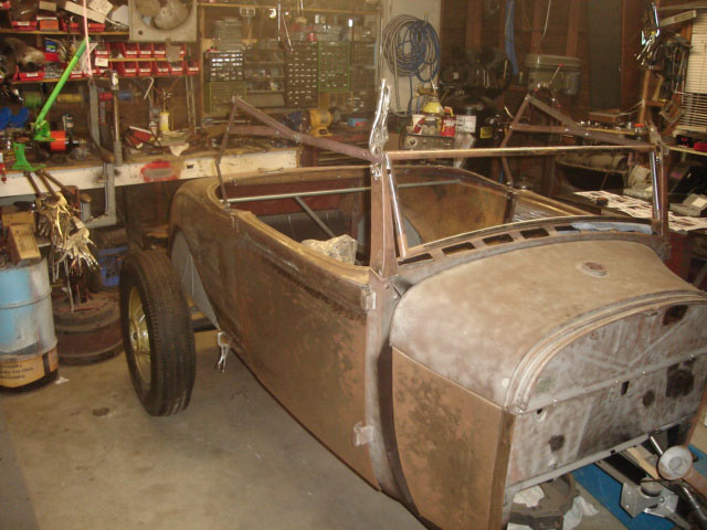

  22. Another update to report. Nothing large. I started on my top irons. Im making them from scratch. Lots of cardboard templates; flip/flopping and making sure they will work for my needs.
    Im going to mount the bows and header on tomorrow and chop the very top down another 2 more inches.
    Overall, im very excited Im this far with it. It's getting closer and closer to looking like a roadster. :)
    Sorry: With all the "gobble-d-gook" in the background, I know it's hard to see them.

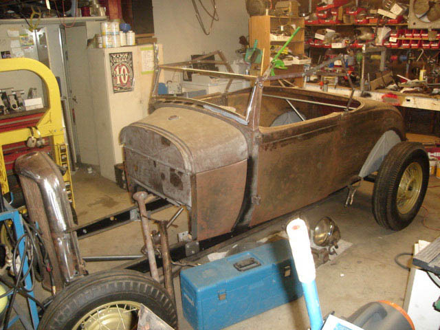

  29. Another late night in the garage.
    I got the convertable top frame 99% completed. Have a few more holes to drill for the top bow and maybe some adjustments but overall its fully functional...up and down.
    Still debating on a rear bow...I dont think im going to need it since my head clears nicely :)
    My buddy said it couldnt be done...IN YOUR FACE!
    When all upholstered, Ill have 9-10" side windows, with the header down a little, 9.5" windshield view.
    A tight fit getting in, but nice overall.
