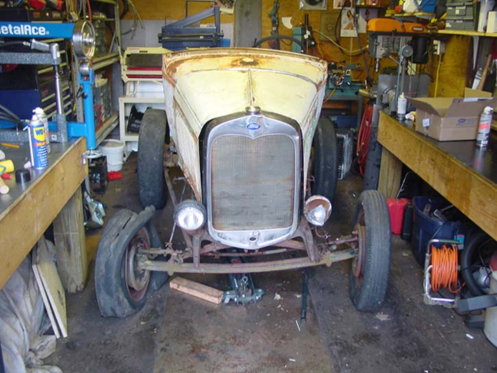

    I have been out running my T around this winter...in the following pic is a nice afternoon jaunty, it was a balmy 34 degrees here. It was so cold, that the intake kept turning to ice...which leads to the next project for the year: a new body, i give in, it will be a full body with a hood, cowl, and sides!
    HAPPY NEW YEAR! and remember, real men only need 4 exhaust ports! :eek: :D :)

    Damn that looks like fun, Happy New Year.

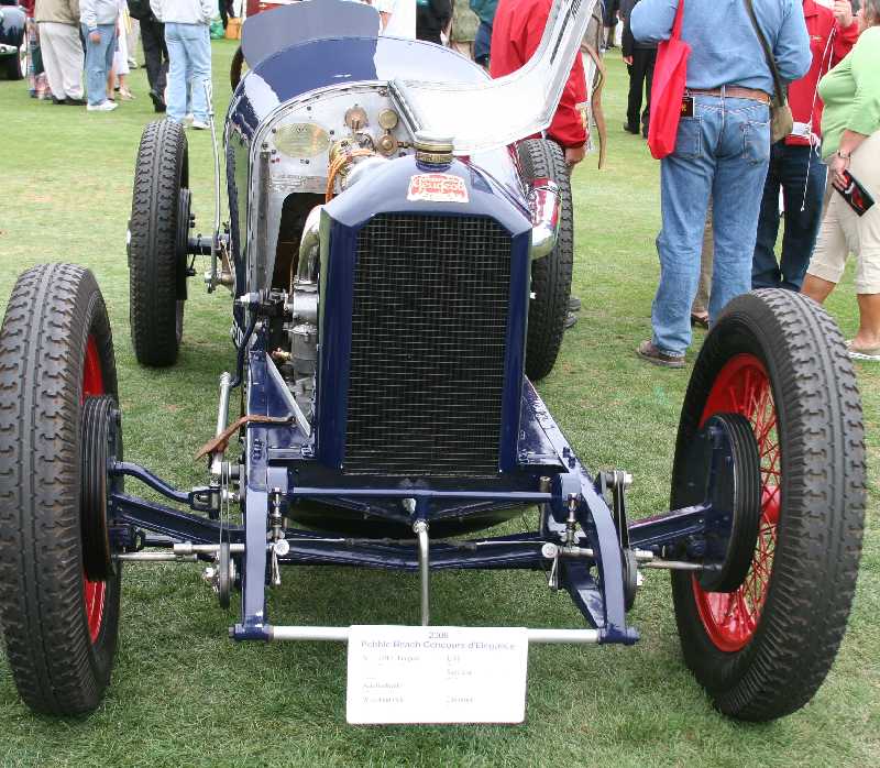

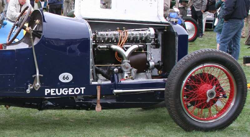

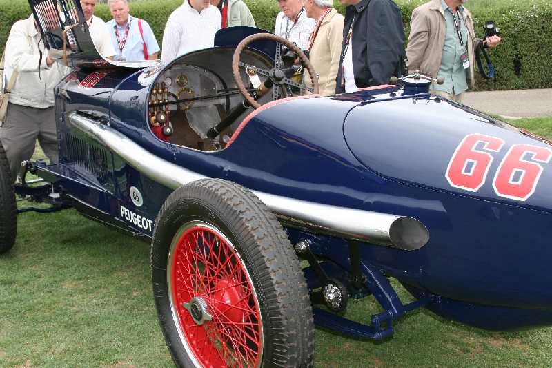

    and as inspiration, for us, the lovers of the mighty four holer: i include a picture of the most inovative and widely copied engine design in the world:

    More Peugeot pics please!

    those wheels are rad!!

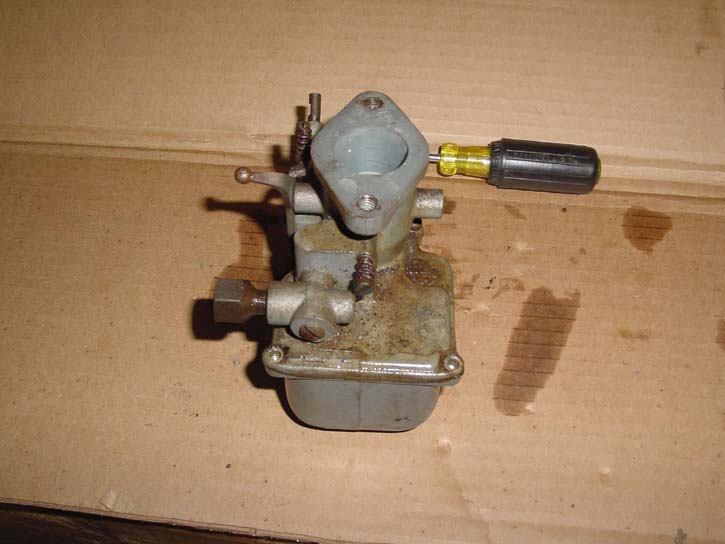

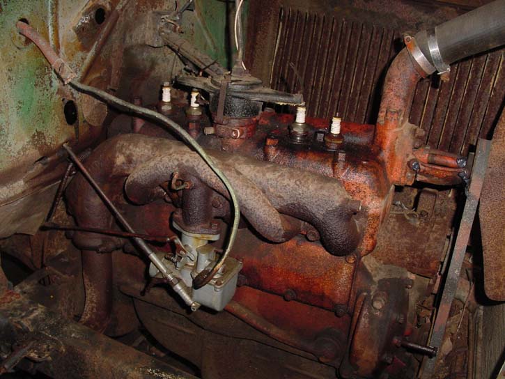

    I just picked up a new project last weekend and it looks like I may have been bit by the Banger bug. I was told this A was converted to a doodlebug during WW2 and was used to tow parade floats, etc. Spent the week learning about Model A engines and cleaning about 20lbs of corn and other seeds that were packed into the engine, rebuling the distributor, and cleaning the carb. Got the engine started today and it seems to run good. My plan is to install an original rear, lengthen the frame, and drive it around while I build a boattail body for it. One question I have is what make and model of the carb?

    That carb looks like a tillotson(sp) replacement. I dropped one of those once in the middle of a rebuild and warped it useless. One drop, no shit. The original zenith would be a cast iron carb. I think when they ran out of zeniths at the auto parts store the replacement was that tilloston. I think it's a wee bit faster than a zenith. AWESOME Thread by the way.

    That carburetor is a "Marvel" sold by Sears as a replacement back in the day. They are great carburetors if they are in good shape.
