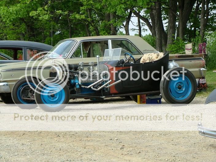

    Lees than $3,000 first time around. Ugly? YES! Fast? You bet! Fun? More than should be legal.
    sko_ford likes this.

    Thanks for all the great replies! The more I learn, the more excited I get about this! flatheadpete, your car is pretty much exactly what I want to build, minus the flat head though. But if I can find a runner cheap enough, who knows... I love those wheels! Very cool car...
    I also really like the chrome reverse wheels like on Harms Way's car....oh crap. I'm sure my vision is going to change a thousand times before I'm finished...
    All the cars posted are awesome. Lots of great ideas. I'm now in the process of doing some research and learning about all the options for axles, drive trains, suspension, steering, etc.
