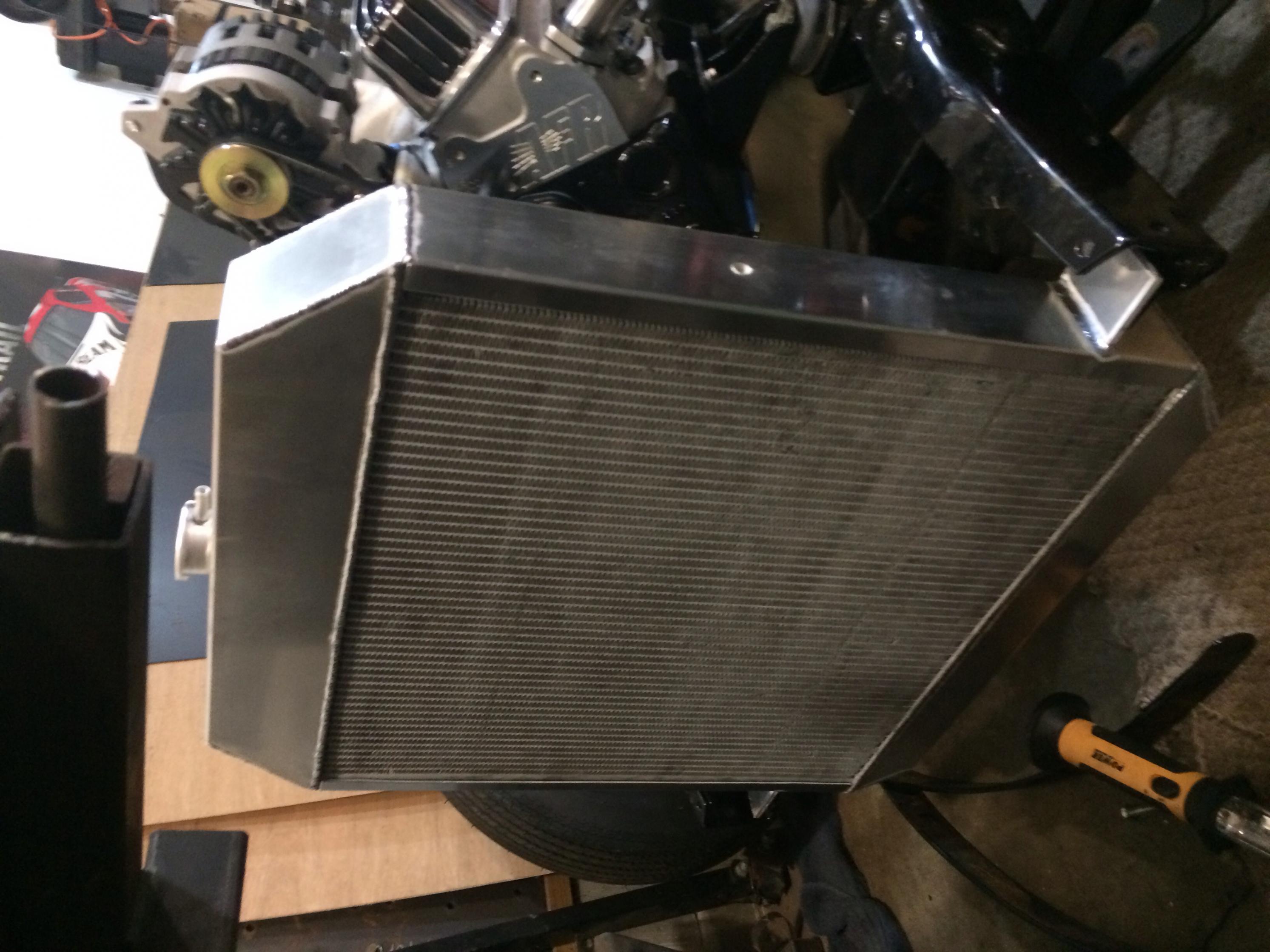

  18. Russco
    Joined: Nov 27, 2005
    Posts: 4,329
    Russco
    from Central IL
    Got the radiator from Brice Thomas yesterday man it's really nice. The core is thicker than a normal 4 row radiator. I can't imagine this not being able to cool the 383 even with the an
    A/C condenser in front of it.
