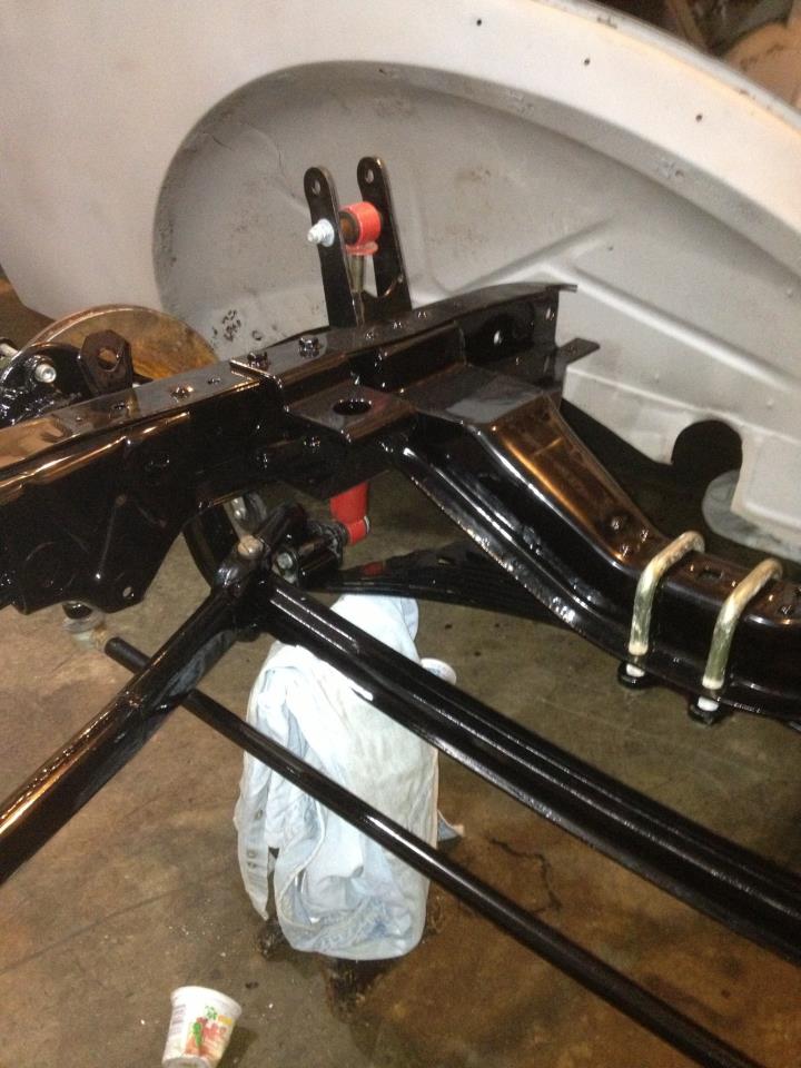

    Yes ,you will need to notch the frame a bit for clearance. I did both sides on mine just in case I needed the room for a low mount alt or something.
    PONTNAK123, LOU WELLS and Hombre like this.
  4. That looks good Russco! Thanks for the responses guys, since I am welding challenged I'm leaning towards the hurst mount. I wonder if spacing it out an inch will cause any other clearance issues with the balancer, or ?

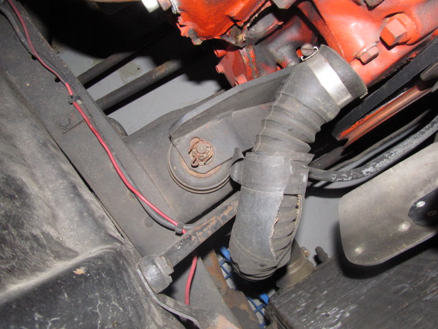

  6. Deuce Lover
    Joined: Feb 15, 2009
    Posts: 1,054
    Deuce Lover
    Here is a pic of a SBC in my 36.Hurst mount hit the spring clamps so cut it as you can see.Maybe the 40 crossmember dips further down.The front of the oil pan is 1/16" from the crossmember.Had to put 1" spacers.I'm using an elec fuel pump.I think even if you move the mount forward the crossmember will have to be notched to clear a stock fuel pump.I used 56 Chev 265 log exhaust manifolds.

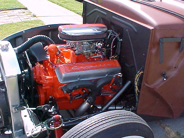

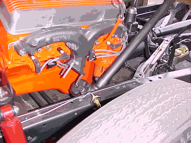

    I used the Hurst mount in my 41 pickup. Had to use an electric pump.
    Use rams horn manifolds from an early pickup which will get you past the steering with ease. I also used original running gear, Hurst mount makes it easy, just like putting a flathead in.
    -Brent- likes this.
  15. Thanks for the pics 41picup, I think that is the simplest way to go, hurst mount + electric pump. I'm on the lookout for one of those curved manifolds.
    Your motor is the look I want, those finned vette VC are my favorite SBC covers, and also, I just happened upon a dual 4 setup. I wasn't looking for one, but the price was right.

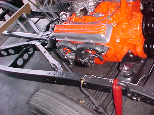

  24. Russco
    Joined: Nov 27, 2005
    Posts: 4,327
    Russco
    from Central IL
    I have those on mine as well. (I think that's what they all have for the left side mount from CE) Like I mentioned earlier the CE stuff is as good as it gets for well thought out and ease of installation and actually fitting and working. Either the exhaust manifolds or block hugger or fenderwell headers will work for exhaust with stock steering gear. There is no way around running the mechanical pump with out notching the crossmember but its not really a big deal. Either run electric or notch it. Here is a pic that shows the area between the steering mounting point and the motor mount position without the engine in the chassis. Search for threads from "Olscrounger" on here he has some really good info posted. He has done a lot of 40 builds.
