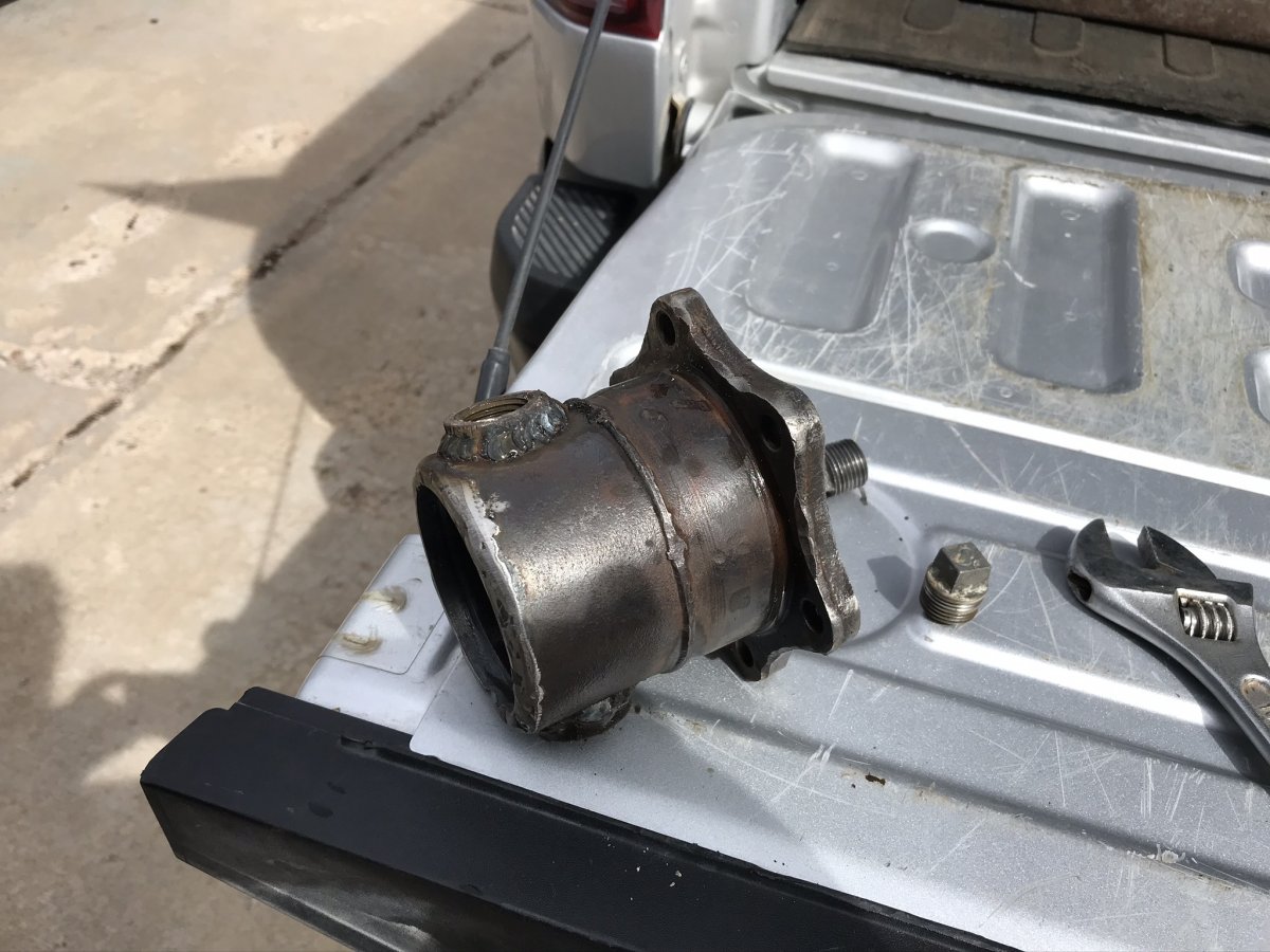

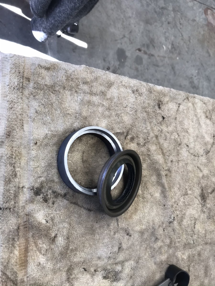

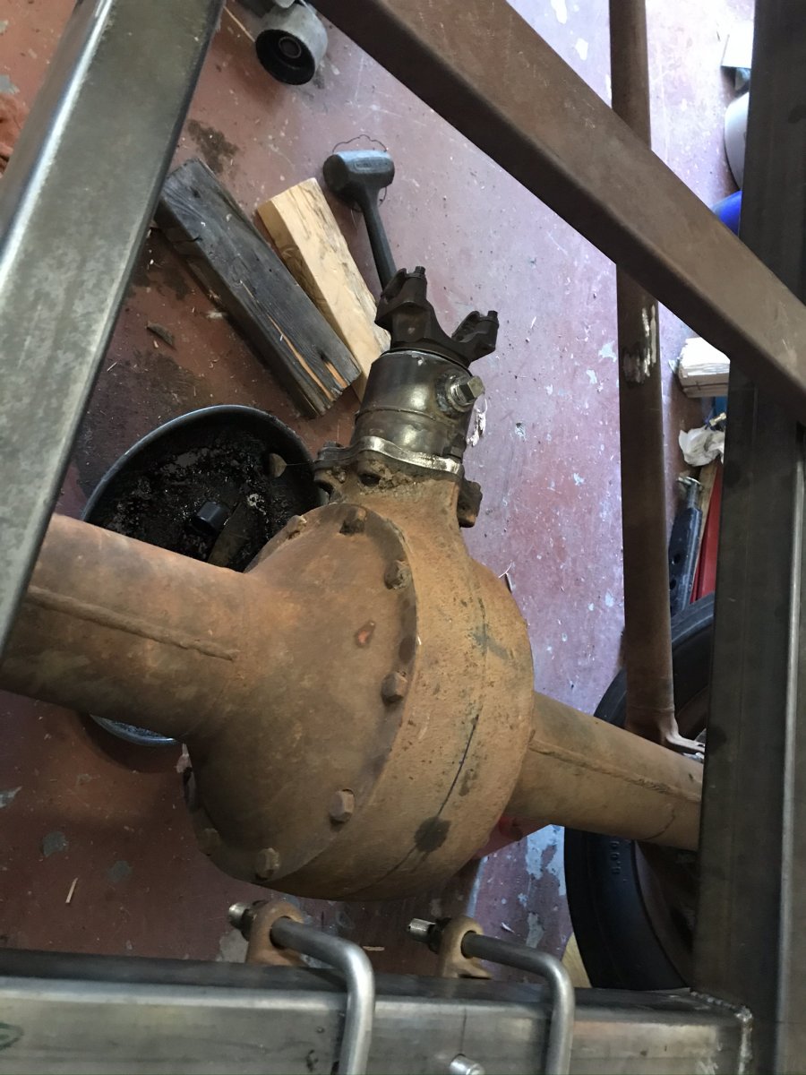

    I recently completed the conversion following your guidance. Thank you for the information and for the write up, it was pretty easy to follow along.

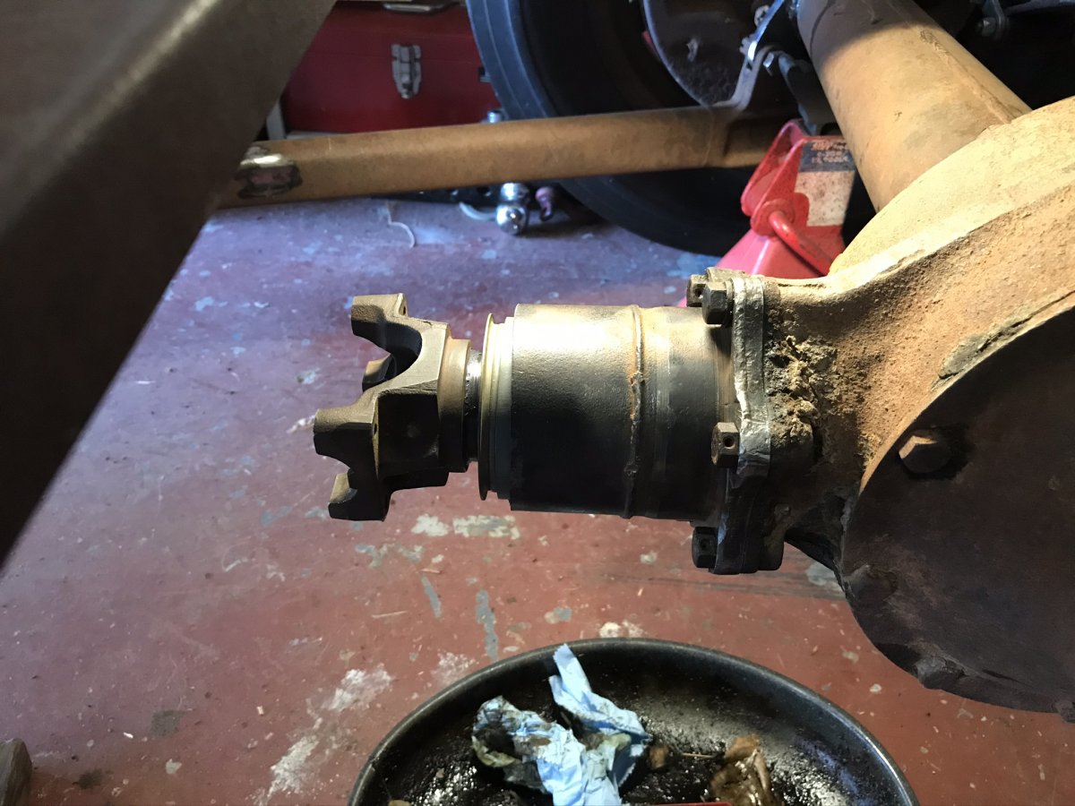

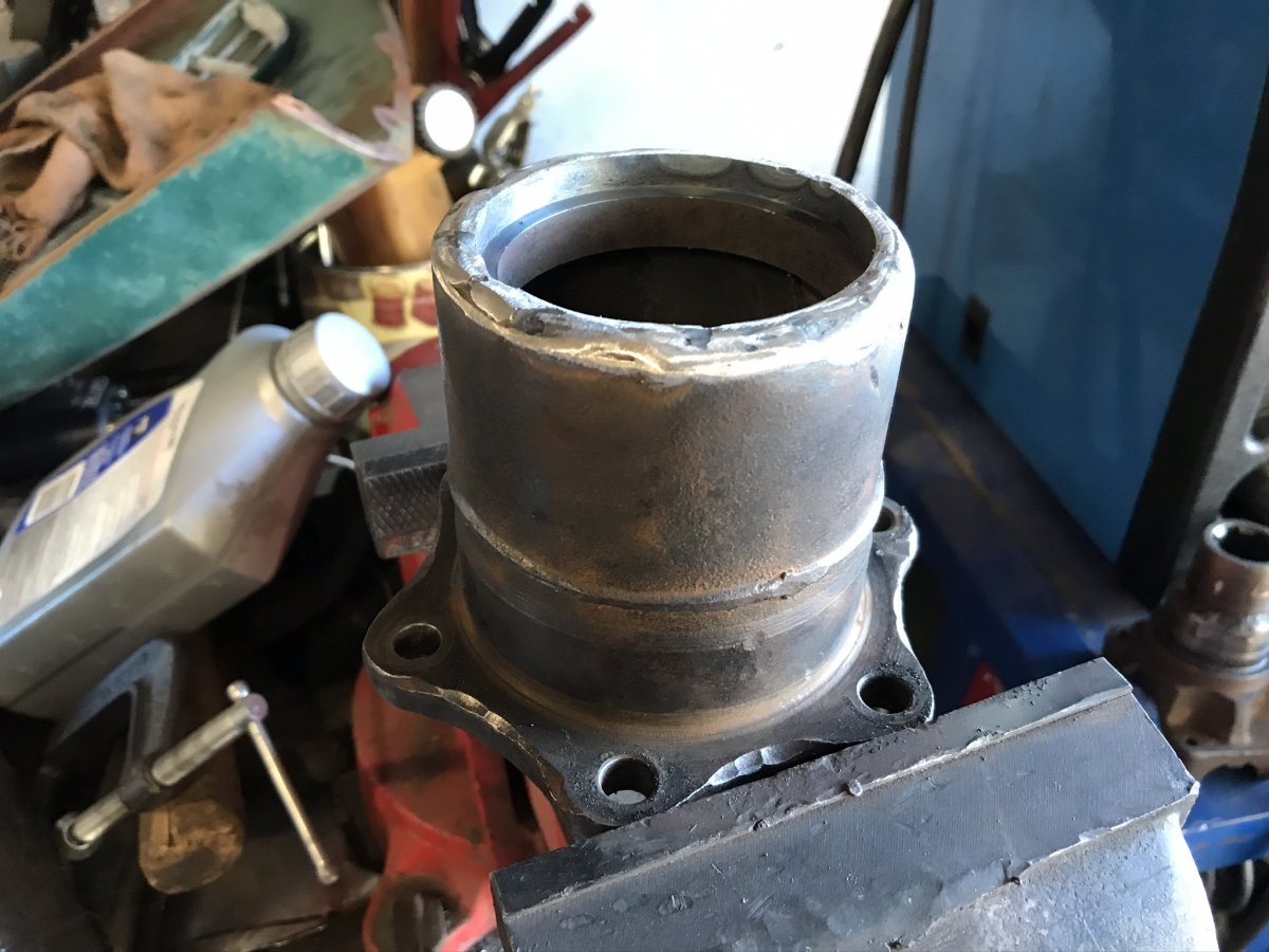

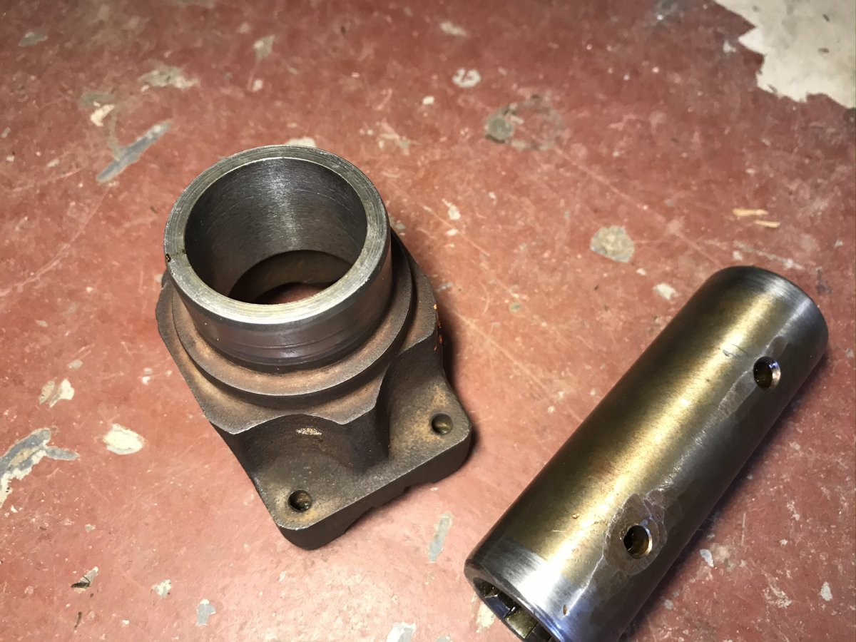

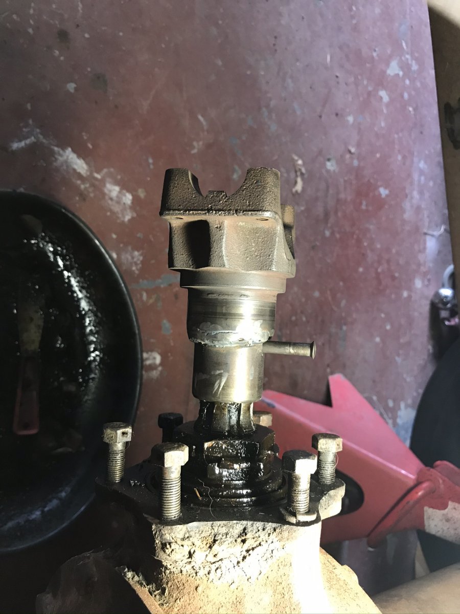

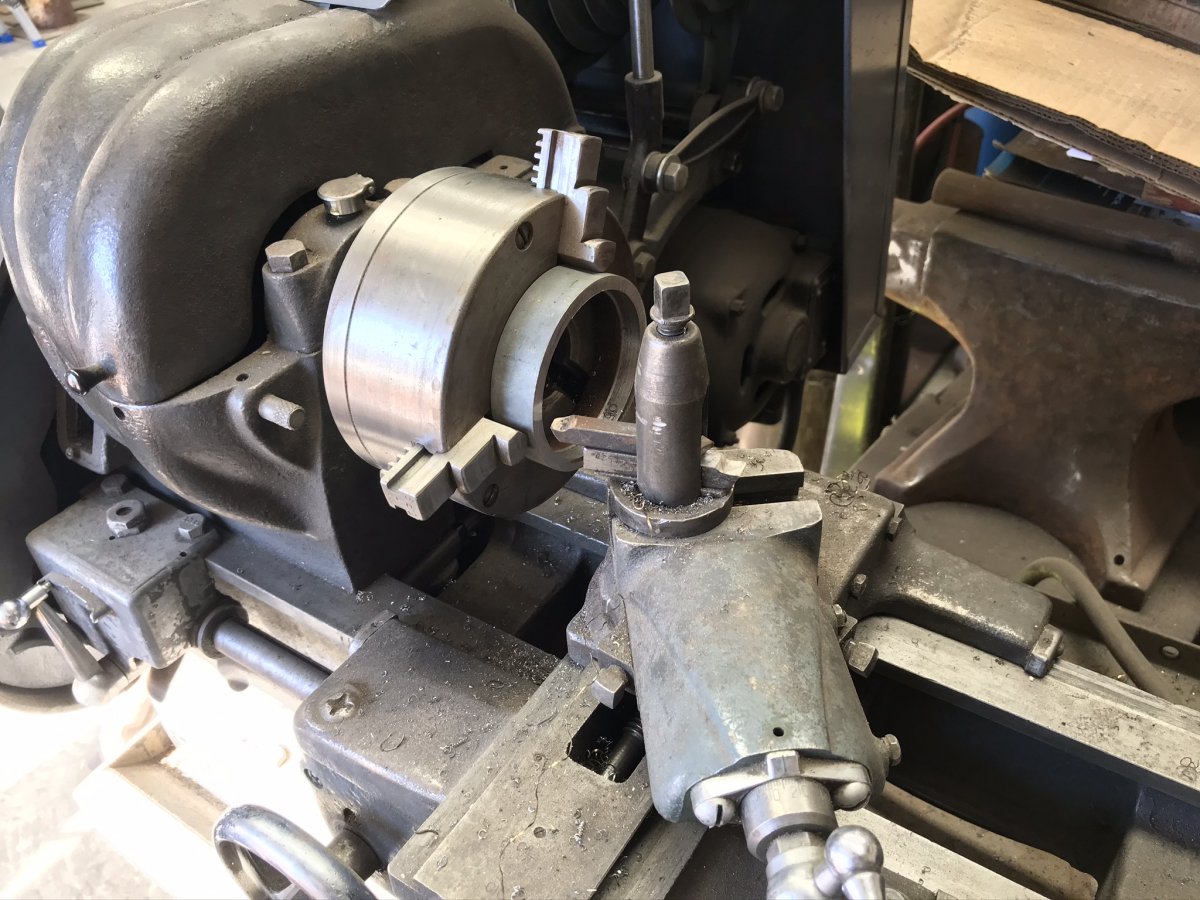

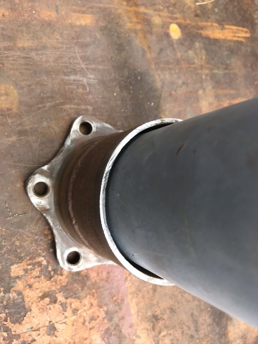

    I used a yoke from a Dana 35 differential and the lip seal that matches the yoke. I had the splines machine out of the yoke so that the original 6 spline coupler would fit. I borrowed a friends lathe and machined the DOM tubing to fit the lip seal. In my case, the DOM tubing was a loose fit in the cut off part of the torque tube. So, to center it I bolted the torque tube to the banjo, put the lip seal (not all the way seated) in the piece of DOM, then inserted the yoke through the seal and onto the splines figuring that the lip seal would hold the DOM centered in the torque tube. I rotated everything a few times to make sure then tack welded the DOM to the torque tube. I pulled it all apart and welded it on the bench.

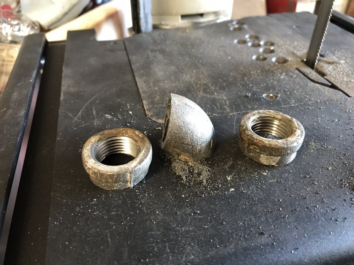

    I added a couple of 1/2" pipe plugs on either side of the torque tube so that I could access the pin.
    All in all it wasn't that hard of a conversion.
