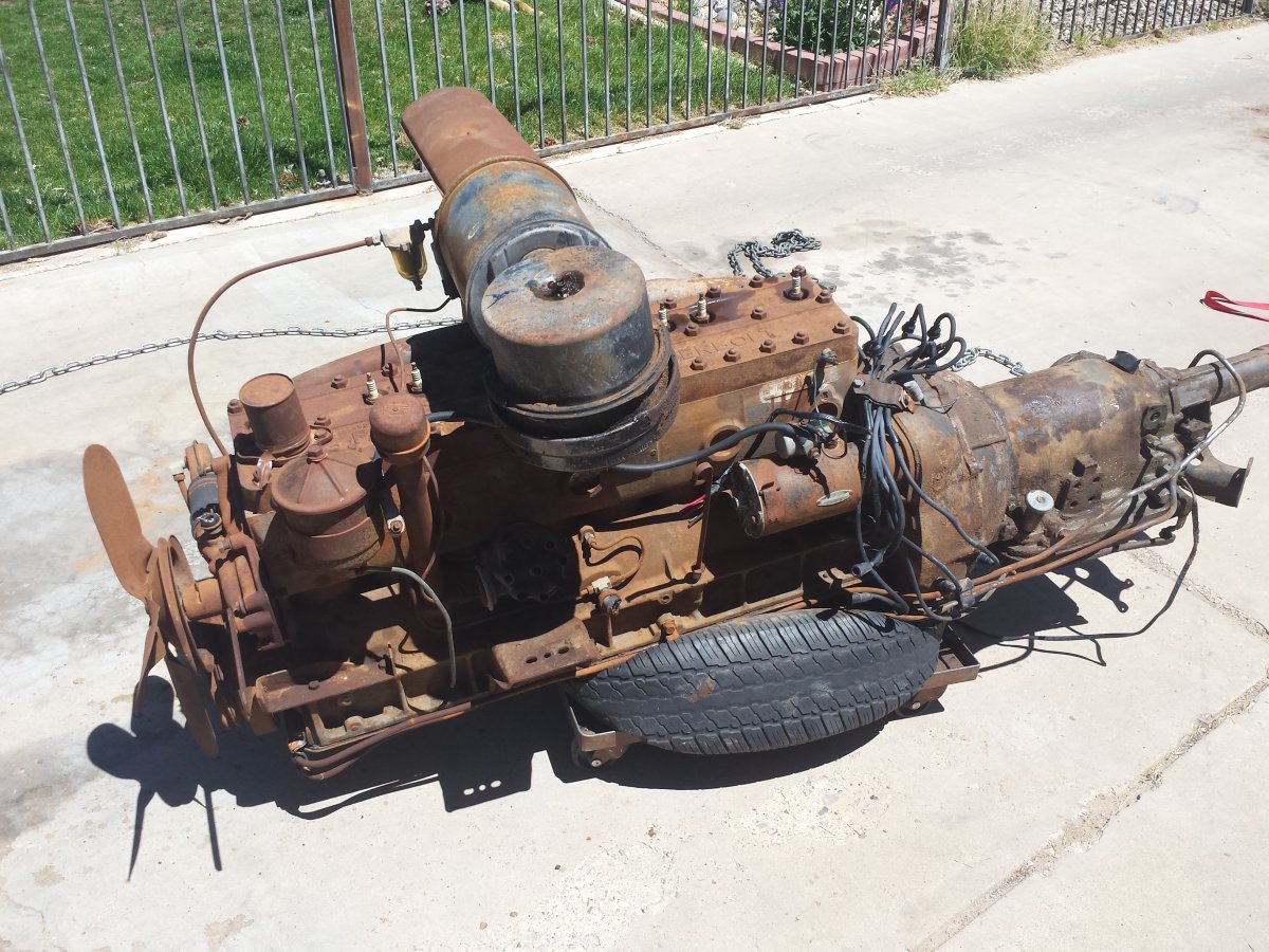

    While scrounging around for parts I managed to locate a 1953 Packard 327 straight 8 that was pretty complete (only missing generator and plug wires. The car had been sitting for 25+ years. I drove from Albuquerque, NM over to Lubbock, TX to pick it up. Before I pulled it from the car I made sure I could turn the engine by hand. Long story short, we made the drive, spent the night, pulled the engine/trans and drove home. The engine was pretty clean. I did some light cleaning, put a little ATF in the cylinders, cleaned the points and put some plug wires on it. The engine is a 327ci with a 4brl intake. The butterflies on the carb were stuck. I managed to locate a replacement and we fired the thing up on my garage floor;
    https://redirect.viglink.com/?forma...bytnm/Packard/20160518_210942_zpsbtd2bpdu.mp4

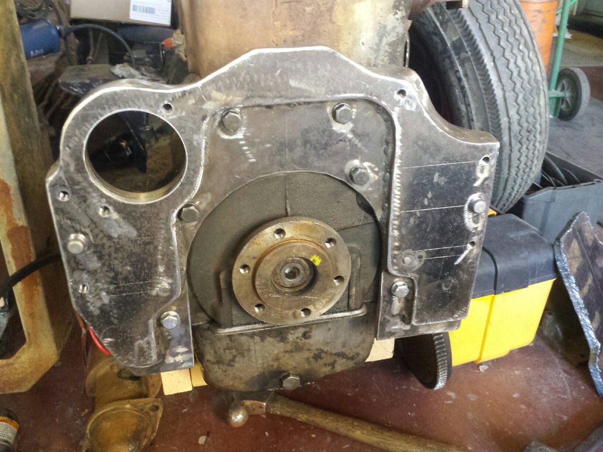

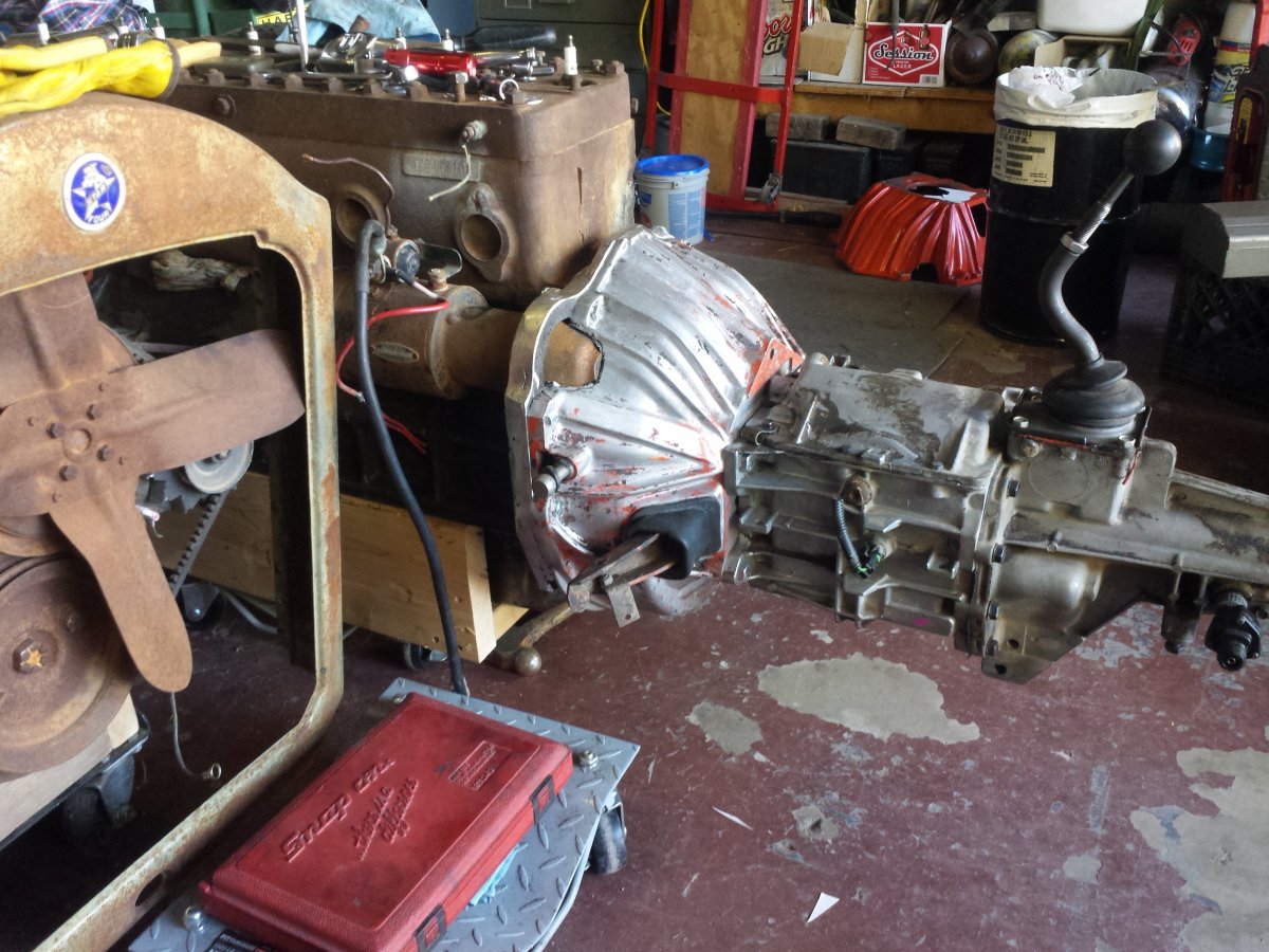

    So, now that I knew I had a decent power plant I figured it would be safe to move forward with trying to come up with a rolling chassis.
    I was working on a Model TT frame but the old guy won't budge on it. I contemplated stretching a Model A frame but quickly ruled that out. I ended up buying a couple of joints of 2"x3"x.120 rectangular tubing.
    My idea was to build a basic ladder frame similar to a Model T or TT. I used a Model A front x-member and notched the sidewall of the tubing to accept the x-member.

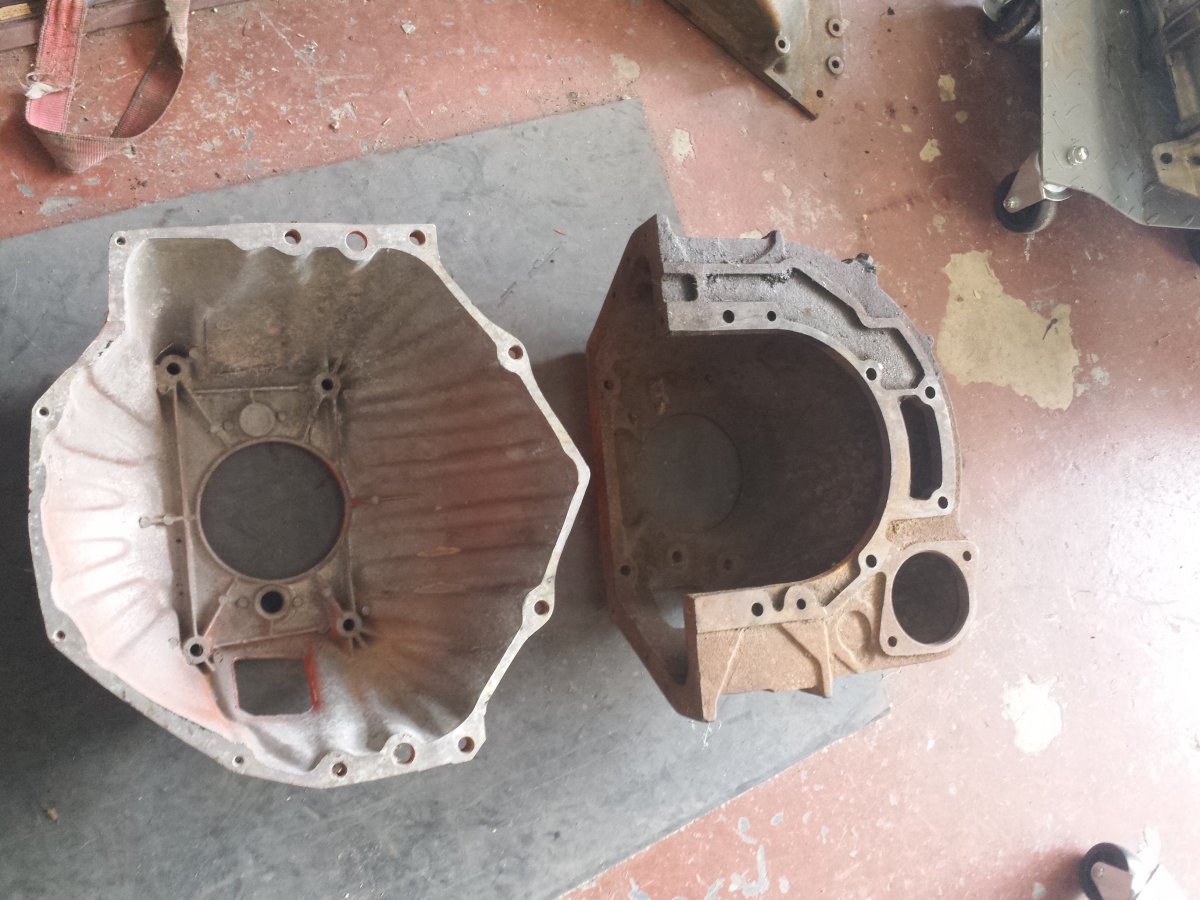

    I decided I didn't want to use the Ultramatic trans that is bolted to my Packard. I was searching around for a Packard 3spd trans and then decided I could adapt a T5. I pulled a T5 from the local pull-a-part and started looking at dimensions. Basically I fabbed an adapter plate that lets me bolt a GM bell housing to my Packard engine. I used to sheets of 1/2 plate. I measured, measured, measured, and measured, and then measured some more to get the layout for the Packard bolt holes and alignment pins. I downloaded an engineered drawing of the GM bellhousing bolt holes and alignment dowels. Then I measured, measured, measured, and measured and made a template. I did that several times before I was satisfied and transferred the dimension to my steel. After some cutting, drilling and welding I had a 1" thick adapter and my T5 mounted. I still need to redrill the Packard flywheel to accept the GM pressure plate but its basically done. 20170211_112557.jpg 20170228_183718.jpg 20170301_204700.jpg 20170306_190530.jpg 20170319_162125_resized.jpg 20170319_175201.jpg

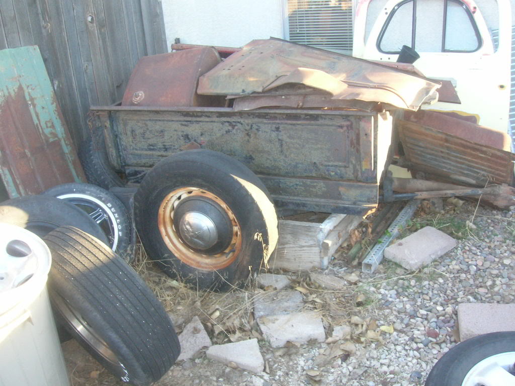

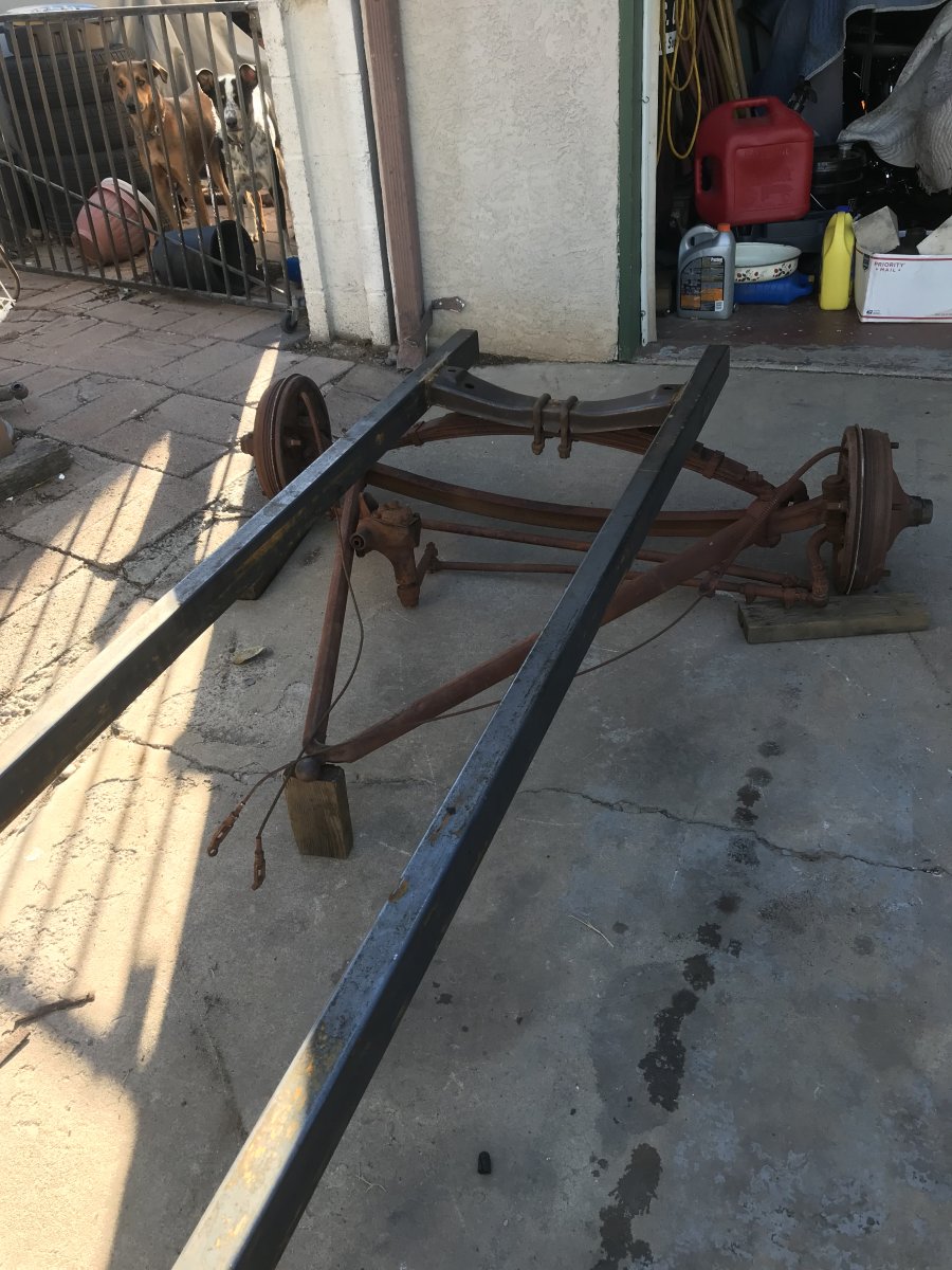

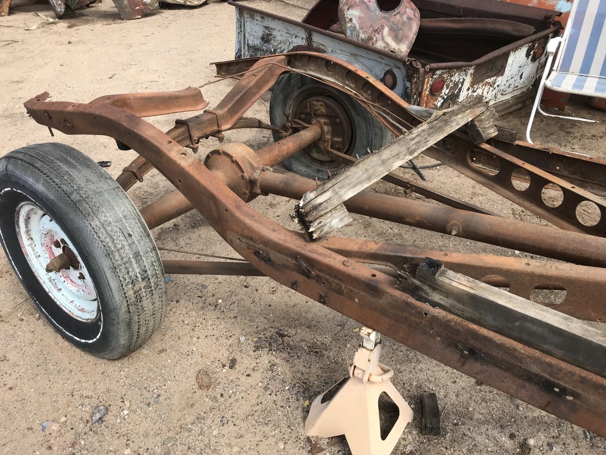

    I don't have too many pics of the bed from when I pulled it out of the desert. Someone had made a farm trailer out of it. It is bolted to the rear axle with U-bolts and wooden blocks. Luckily the sheet metal wasn't buried in the sand, only the tires and tongue (front of torque tube). The actual bed and tailgate are in pretty danged good shape.
    I'm going to run the 38 Ford front suspension completely stock, well, I may remove a leaf or 2 from the spring if needed. Initially for the rear I was going to go with a parallel leaf rear suspension. As I was scrambling around looking at different vehicles and shackles I saw an ad on Craigslist for a complete 40 Ford truck chassis. After some wheeling and dealing I drug the chassis home. This gave me a complete transverse leaf rear suspension and a banjo diff with hydraulic brakes (I'll have to swap my wide 5 drums onto it). So know I'm going to run the transverse rear spring.
    I'm also thinking that I'll take the ball mount off of the spare 40 Ford front wishbone and adapt it to the rear wishbones and fab another x-member with a ball mount for the rear.
    I got the 40 Ford chassis cut apart. Now I need to find a buyer for the flathead V8 and trans.

    This is going to be a good build to watch, nice work on the transmission adaptor. Bob

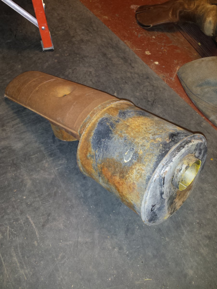

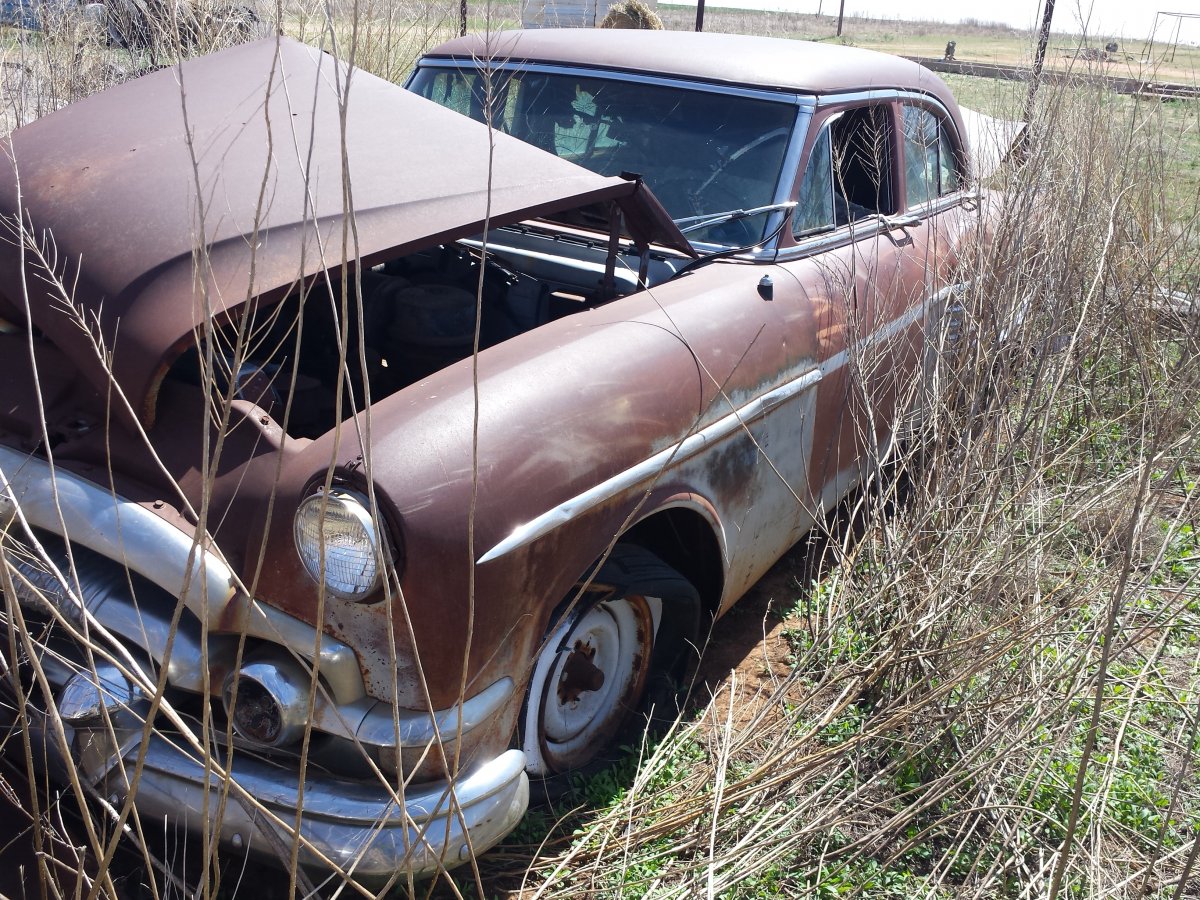

    So, I have a couple of these Packard straight 8's. The first one was given to me. Its a 288ci and its still sitting in the car (I'm waiting for the guy to get it pulled-he was going to scrap it). I ended up buying another 288ci at the swap meet for $100. Both of these engines are incomplete and don't have carbs, distributors, starters, etc.
    While talking to a cousin of mine out in the Lubbock area I located a 327ci Packard still in the car and complete. Its pretty handy having the incomplete 288ci engine hanging around. I can use it in my mock ups and not worry about damaging anything on my good engine.

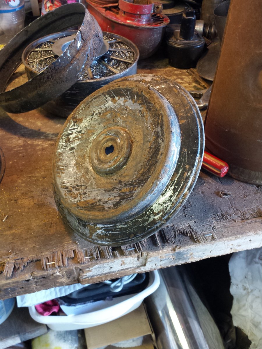

    The original air cleaner on the 327ci engine is huge. It appeared to have a resonator or silencer type area between the actual oil bath area and the carb. I was just going to leave it be and run it like it was but then decided to cut it apart and streamline it a little bit. I basically cut it down a bit, used parts of it to make and end cap and found a paper filter I could make work. I then used some screen to make a cover for the paper element. Here's some pics (I cant find the finished pic with the screen) 20160315_132818.jpg 20160315_132826.jpg 20160423_100943.jpg 20160424_123921.jpg 20170104_163619.jpg 20170104_165017.jpg 20170122_142727.jpg 20170129_151636.jpg

    EXCELLENT work on mating non-traditional inline flathead to traditional aluminum bellhousing and T-5 tranny!:cool:Very cool build, don't stop now!

    great job on the bell housing adapter , using basic tools thats real hotrodding i really like the big packard mill to id love to use one in a T bucket , keep posting your progress im liking this build

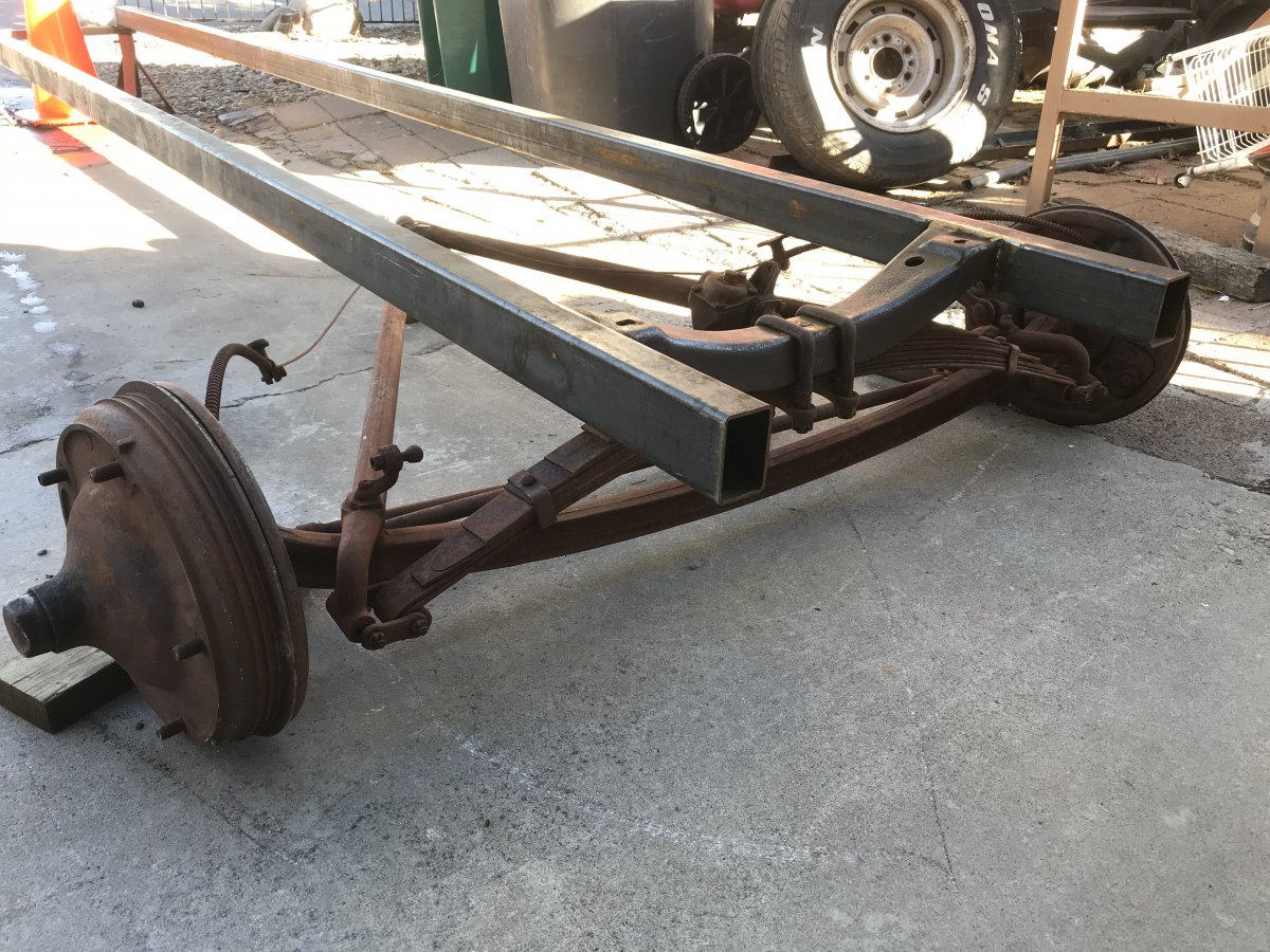

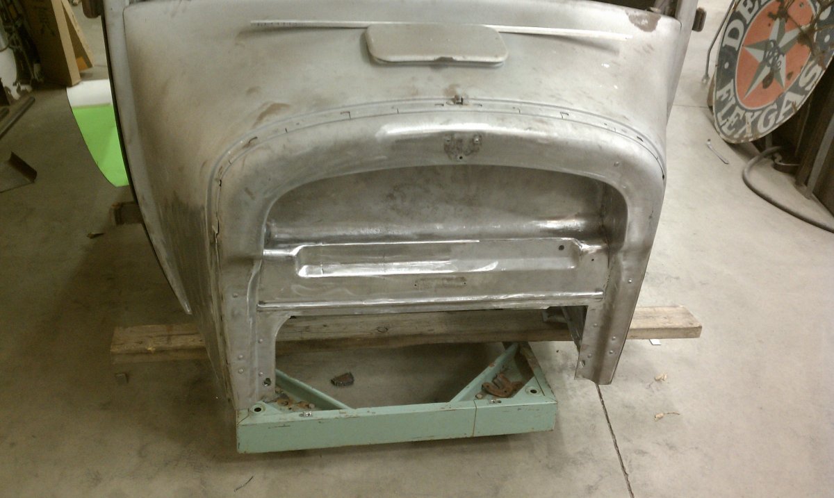

    So, here's where I'm at today. I've notched my frame rails and installed a front x-member so that I can bolt my front axle in place. At the rear I just have a temporary x-member welded to the rails to hold the width. Once I got the rear axle cut from the donor frame I couldn't resist rolling it under my rails. Naturally I had to set the body and grill shell in place to see how things were looking. And, yes, once that body was sitting on the frame I did crawl inside and sit in the drivers area and make silly little vroom, vroom noises.
    My plan now is to hang the engine between the frame rails and rough in some engine mounts. Once I know where the engine needs to live then I'll know where the body mounts need to be, which will then tell me where the bed needs to be mounted. Once that is known, I'll know where the rear axle needs to be located and I can start fabricating a rear x-member and spring mount......whew. I also need to determine where the front wishbone ball mount needs to be and rough in a x-member and ball mount.
    IMG_0085.JPG IMG_0087.JPG IMG_0090.JPG IMG_0161.JPG IMG_0171.JPG IMG_0176.JPG

    Thanks for all the kinds words so far. This site has been very helpful and I've learned tons from reading and seeing what others have done.

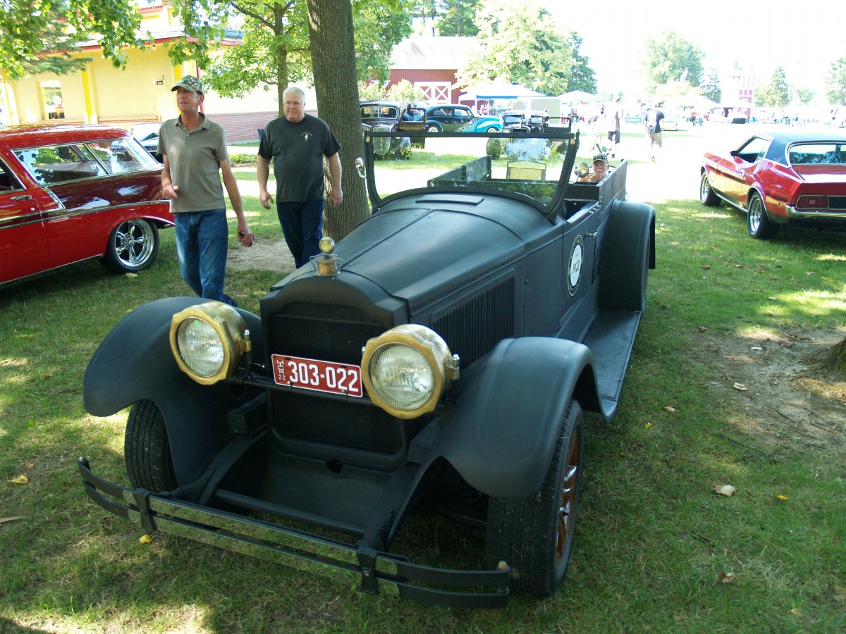

    this build reminds me of a Packard pickup I saw this year. He said it was made for use in the Packard factory for running parts.

    Here is what I did with my T firewall to help provide a small amount of extra engine bay space.
    It is just a simple reversal. Some times an extra inch is worth working for...

    I dont know if you want ideas on the firewall.
    But on my build i reversed the upper half to save some wheelbase.
    Most of the bellhousing went under the angeled floorpan so it dont take up
    much space inside the coupe.
