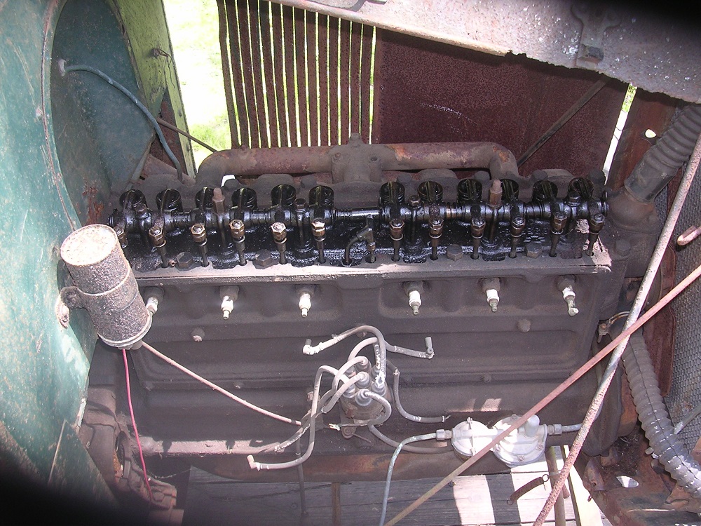

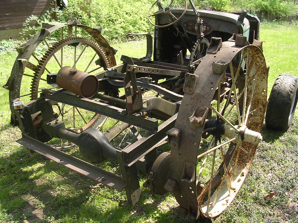

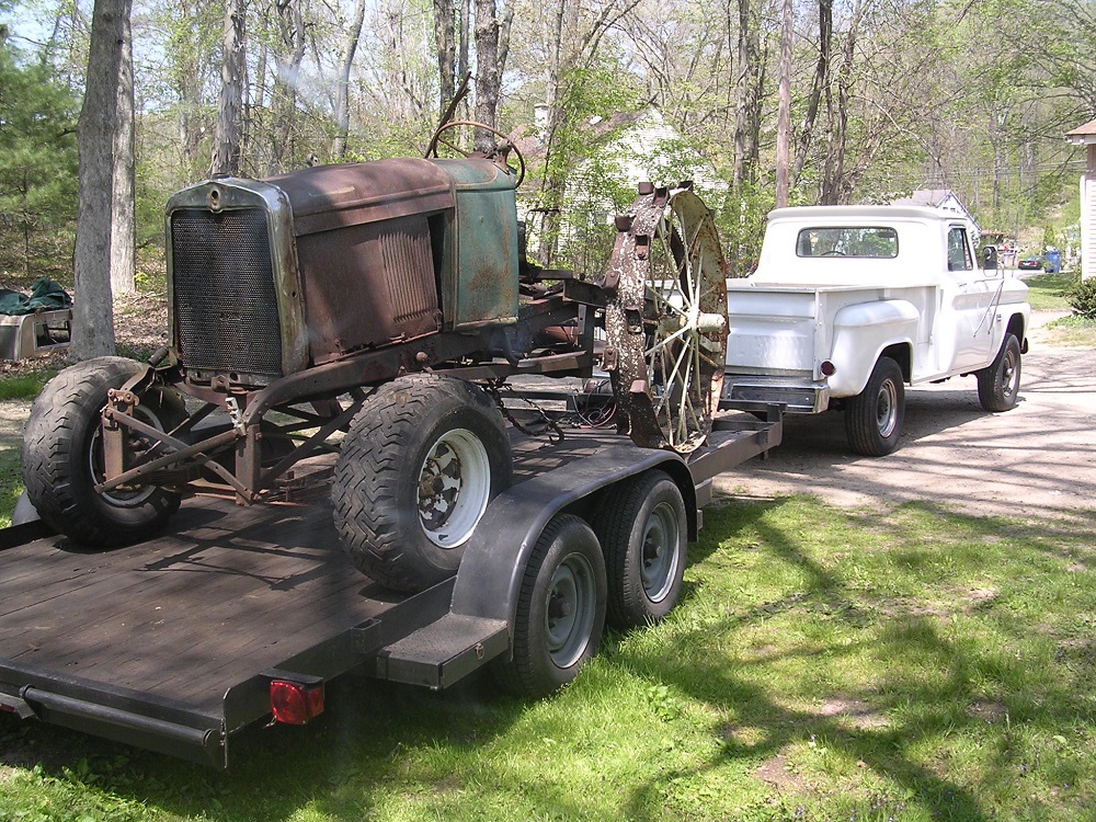

    I've had a odd illness for over a week; some days could not walk or move my arms. Yesterday I felt good enough to drive to the scrapyard/metal recycle place for some fab steel.
    Well, 4 weeks ago when I went there with my son, we saw this 29 Chevy, but they said it was sold....my son was happy because he said that I have no use for it anyways :)
    Yesterday it was moved back into the "for sale" area, and the owner said "sleep on it". I did, and went to get it today. LOL
    I don't know if it is a Sears kit or Montgomery Wards, or another brand, but it is quite unusual to see a kit made for the Chevys. Most all survivors are Ford A and T. These kits had special gear hubs to fit the stock car rear axles, to drive the 41" big gear. The rear wheels are 4.5 feet
    Not sure what I will do with it, but I also have an old 50s channeled 30 Chevy roadster pickup, so I don't think I'd try to put it back to a roadster or roadster pickup unless I got very lucky to find a rear body and doors.
    The motor is not stuck, but the yard scrapped the generator and starter for the copper :(
    Does anyone know how many years of starters would fit the 29 motor?

    My new Hemming mag has an article about all Chevy starters and the interchange. 29-34 Standard six is what it states.

    '32 & later downdraft intake & exhaust manifolds will fit so you don't have to deal with the updraft. I'd pull the pan & check the rods & mains for acid etch.

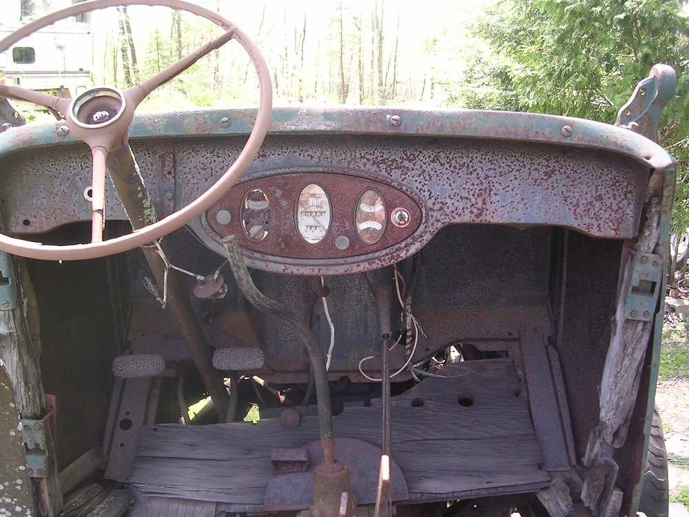

    Patmanta; I spoke too soon. I now see the boltholes for the starter have not had a bolt in them for years, so the starter maybe was taken off for storage by the old duffer. He must have oiled the valves once in a while, because it is wet with oil, and plugs are finger tight, so he oiled them too. The carb was likely put in a shed, because there is an old oily rag in the manifold hole. So, the only part cut off at the yard, was the generator
    Thanks for the interchange, I am sure I will find one local, now that I know which ones fit. The motor has a casting date of March 1929, so I know it's ID

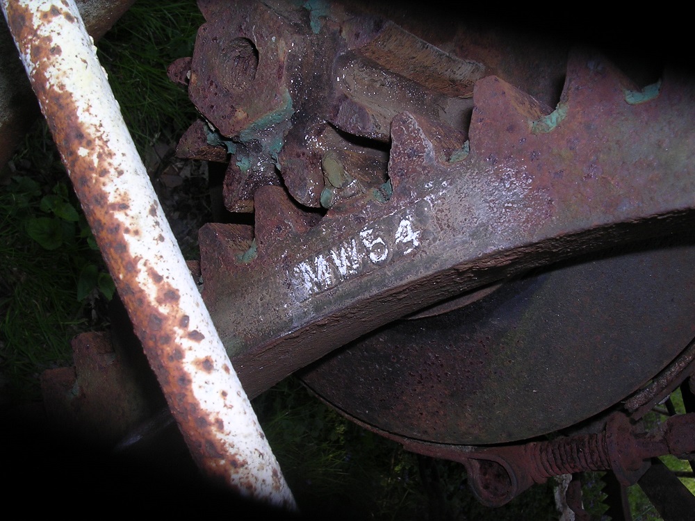

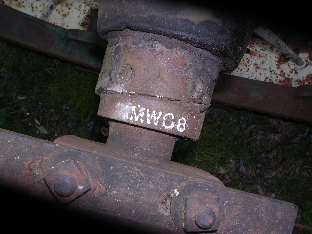

    Tractorguy; take a look at two casted parts with MW part numbers. One is the big gear, and other is on the inner big wheel hub. I suppose other casting companies could use MW, or is it a good sign that this is Montgomery Ward kit?
    Speaking of ingenuity, that large added rear frame pivots on the axle of the big wheels....like a teeter totter. The back of that frame is the drawbar for attachments. When you need to lower or raise that drawbar, you reach over to the tall handle, pull the release trigger, then either use first or reverse gear, which makes the drawbar "power up, or power down" as the small gears climb up or down on the big gear! I think that is very clever, as that tall handle is not in a great place to try to muscle the lever by hand.

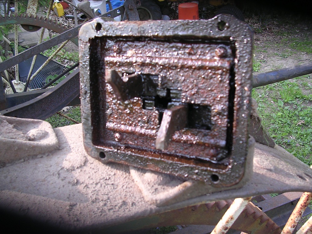

    Last pic shows the only rusted stuck thing on the moving parts. This is the shift tower, and I did get the rails freed up today. The rails slide in that tin box. The trans gears all look good and the sliding gears are not stuck.

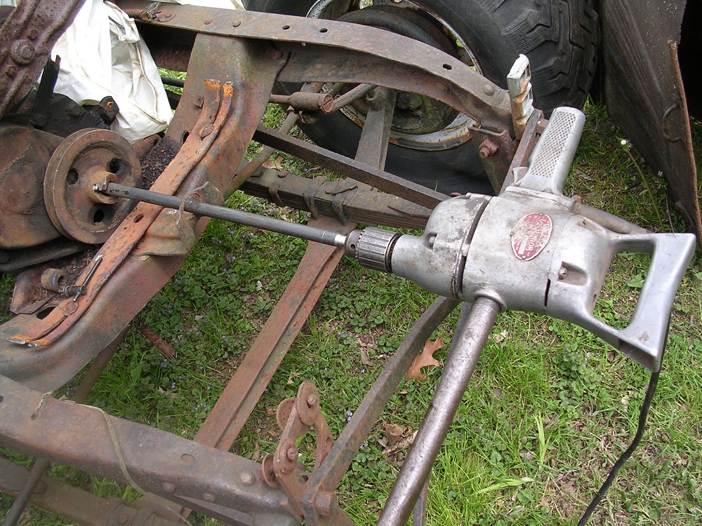

    So, I should have it running/driving in a day or two. I will use an ancient huge 1/2" drill motor to spin the crankshaft, where the hand crank fits. I've done that before with decent luck

    Well, I think I have a nice Model A carb here, so I'll try that one. On the pan, yes I already was thinking how bad the sludge might be. The worst one I've seen was a 1920 Reo last run in early 50s, and it was honestly like peanut butter consistency. I did just check the Chevy dip stick, it is normal blackened oil at the full mark, and is not stiff or gummy. I may just drop the drain plug, and fish around in there with a wire looking for solids.

    I will turn this thread into a "how to start a barn find" to keep it hamb friendlier. I do this kind of work for a few people who want a barn car to be able to run and move, so they can sell their cars easier.
    There are usually other "sticking points" besides just getting them to run; you sometimes have stuck clutches, brakes, whatever, but you normally want to get it running first.
    My old friend is looking in his stuff for a starter today, so I went to "thumb test" the compression by turning the front crank hub with big channel-locks. I had Zero on all 6 holes. All the valves had lash and all are moving, so I knew it needed to spin awhile with oil in the cylinders.....that always helps bigtime.
    So, I found a piece of 5/8" hot rolled bar, turned it down to 1/2" on the lathe, drilled a hole for a piece of 3/8" grade 8 bolt....and chucked it into my Dad's old Thor 1/2" drill. He had a shop in the 50's so it must be pretty old.
    I spun it a bit, but still had zeros, so I used a blend of ATF.Acetone, and used motor oil in each hole.
    Well, after spinning it a few times for 30 seconds each, I had to get creative to hold the drill and still be able to reach all 6 holes for another thumb test for compression. I have compression on all except number one. I don't bother with a gauge test, because you can tell if there is enough compression on each, to be able to fire.
    If you have a lot of dead holes at this point, it can help to do a smack with a rubber hammer on each valve to let it snap back hard against the seat....to knock rusticles off. At TDC, or just have one valve down all the way and smack the other one on that cylinder.
    Time to either clean points and fix plug wires, or find a small carb. The carb most likely will be a lawnmower carb for now.
    But after cranking up the compression,.... look what was pulled up by the flywheel teeth. I got a good hint that the clutch disc will be stuck .LOL

    Frank, Are these parts unique to Chevy or are the same conversion parts used on the Ford chassis? Poked around on the web and found this MW number on a rear wheel. Bob

    "tractorguy" posted that he also found some pics like that on a Ford. You would think that the big wheel and big gear would be used for Chevy, Ford and Dodge, to save manufacturing costs? The small gear would definitely be different on all three kits. At this point, we don't know if that MW means Montgomery Ward or if it's a coincidence, but seems likely it is Wards
    I thought I read years ago, that they offered tractor style all-steel front wheels for these kits; maybe optional?
    And lastly, this Chevy has a "lift kit" on the front springs. I don't know for sure, but the pieces might be factory kit parts. It would sit way too low in front without a lift kit
