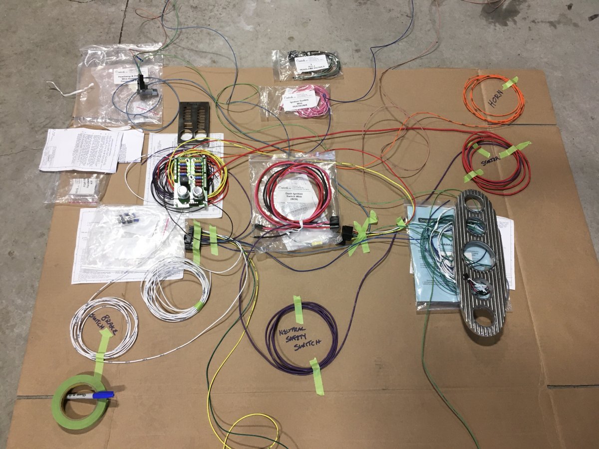

    I bought a kit from Centech, but I did lay it out before install.

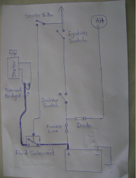

    Here's one,
    Trying to help a fellow HAMBer 12000 miles away
    wiring a 58 Chevy Truck with a 283 engine swap
    This one is how we wire a race car using a Ford Starter Relay and a low amp switch as a Battery Isolator/Disconnect

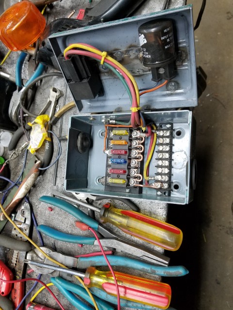

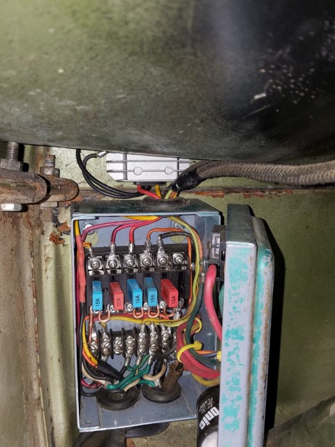

    Bought another 29 Tudor last year about this time. While everyone was hiding from the "bat bugs" in March and April I was going over my new car. One of the improvements I made was switching to 12 volts and adding circuit protection.
    I rooted around in my jun..., uh, inventory until I found a suitable box to hold the fuse panel and make my terminations. Turns out it was the original on/off switch from my dad's Powermatic table saw that he bought new in 1970. Has sort of an art deco look to the cover. I filled the screw holes and the hole for the toggle and hinged the lid.
    Figured I'd better make a map of what I was doing to fold up and store inside the box. That may save me a lot of hunting around with a flashlight for the problem while parked along side the road some dark and rainy night, haha.
    I used a relay to heat up most of the panel so the ignition switch would turn off everything but the lights and I wouldn't need big amperage right up against my gas tank.
    Flasher and relay are in the cover. Apparently I didn't take a picture with all the wires installed, but here's one that shows most of them. Those are self resetting breakers. 20200525_173944_resized (Small).jpg

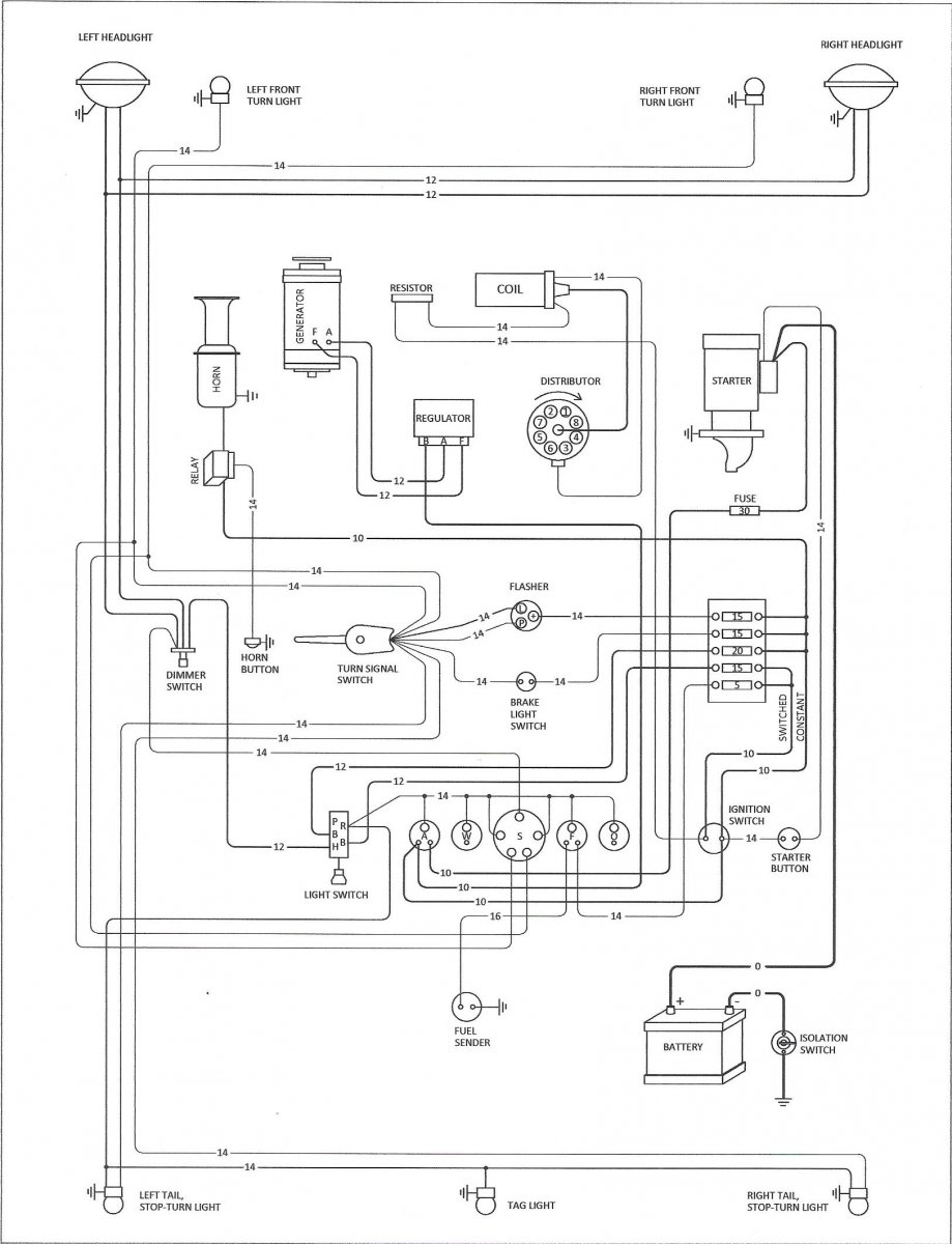

    'drew this one in CAD
    with the help of the HAMB
    when rewiring a friend's car.
    'tried to make it look "old timey"

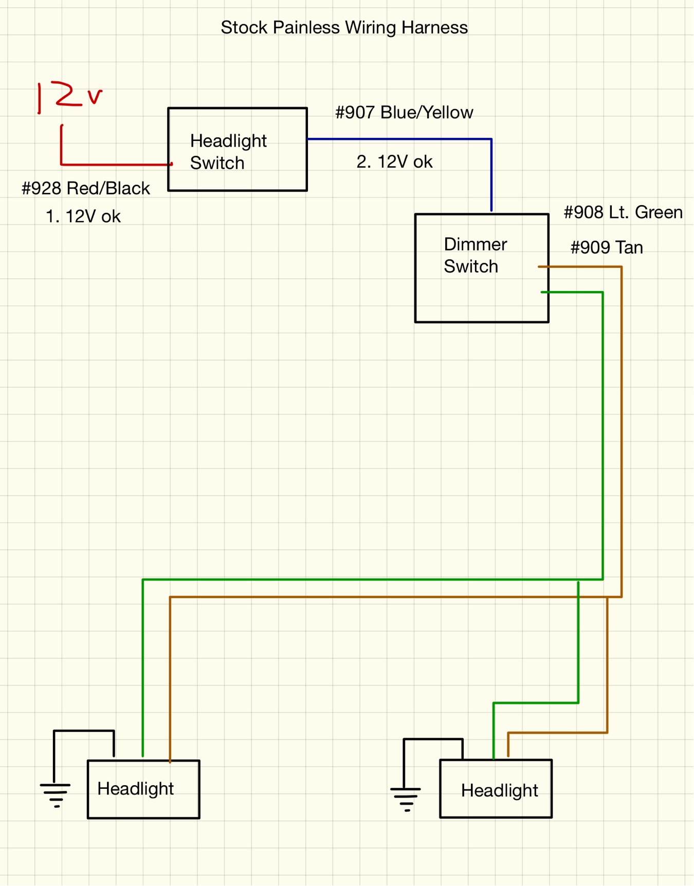

  21. 16052141519695968862839677073050.jpg simple lighting system. Power comes from fuse panel, and have since added a relay...

    Could explain to me why you have “ switched” and “ non switched” voltage going to your light switch? Thanks.

    Headlights require Ignition on,
    Parklight/Taillight circuit can be left on with the car locked.
    There are 2 separate power feeds in the switch
    Sometimes the interior Dome light is also powered from the Parklight/Taillight feed [with a dimmer]

    Maybe for the interior lights (aka dome light). The "P" terminal on the light switch is not connected in this diagram. Been a while since I worked on older American stuff (mostly Bluebird school buses and IH light trucks).
    EDIT: I like Mimiam's answer.

    Thanks!
    I like the fact that somebody can read wiring schematics enough to question this.:D
