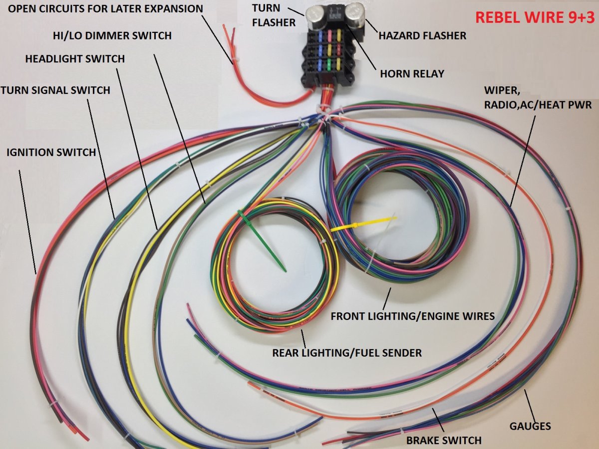

    Here's a picture of our Rebel Wire 9+3 kit. This kit will cover: lights (high and low beam/running lights), signals, gauges, wiper power, ac/heat power, horn, brake lights, radio (keyed and constant power), plus 3 open circuits that can be used later (1 constant hot and 2 keyed). Wires are bundled into switch bundles and labeled every six inches, printed on the wire. The fuse panel is prewired with the horn relay, turn signal and hazard flashers installed. 9+3 with bundles.jpg

    So your Rebel Wire kit (and other systems) are going to have circuits made up of constant and keyed hots. Your constant hots are full time battery hot and the others are controlled by the ignition switch. So that's where the power comes from. The ignition switch has a constant battery hot running to it (ignition switch power in our case) and the heavy wires coming off of it (ignition switch accessory & ignition switch ignition) send power from the ignition switch over to the fuse panel to power the rows of fuses. From the fuse panel the power runs into different switches (headlight switch, wiper switch, heater switch, brake switch,...) then the switch distributes out power depending on it's operation. From there the power runs from the switch searching for a ground. If there's no ground, there's no power!
    So coming off of the ignition switch you'll also have the coil and starter solenoid wires. The coil wire is going to need to be hot when the key is on and in the start position. The solenoid wire will normally need to be hot in the start position only.
    (in the exception of using a starter button, the start wire may need to be hot in the ON position and then run through a starter button to send power on to the solenoid)

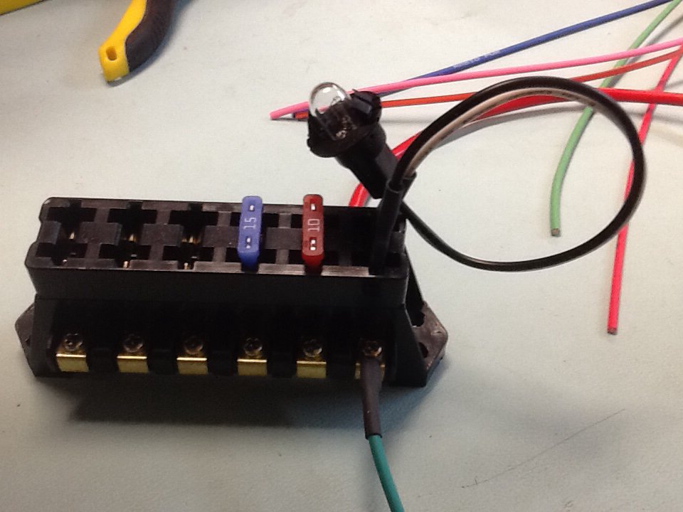

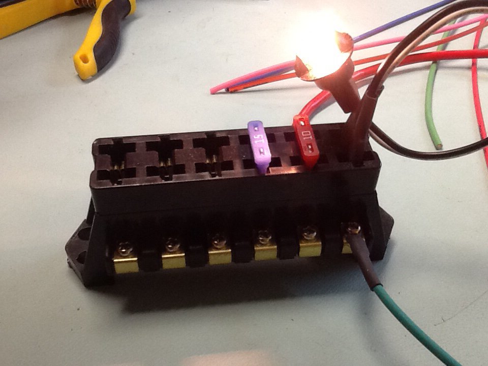

    Speaking of shorts and blowing fuses. Here's a little trick to help find a short to ground using a little 2 wire bulb. You just pull the fuse that's blowing, and plug in a 2 wire bulb in it's place. Since one side is hot and the other side is shorted to ground, the bulb will light up. When you find the short and disconnect it, the bulb will go out. Also saves a lot of fuses! IMG03 (4).jpg IMG02 (7).jpg
