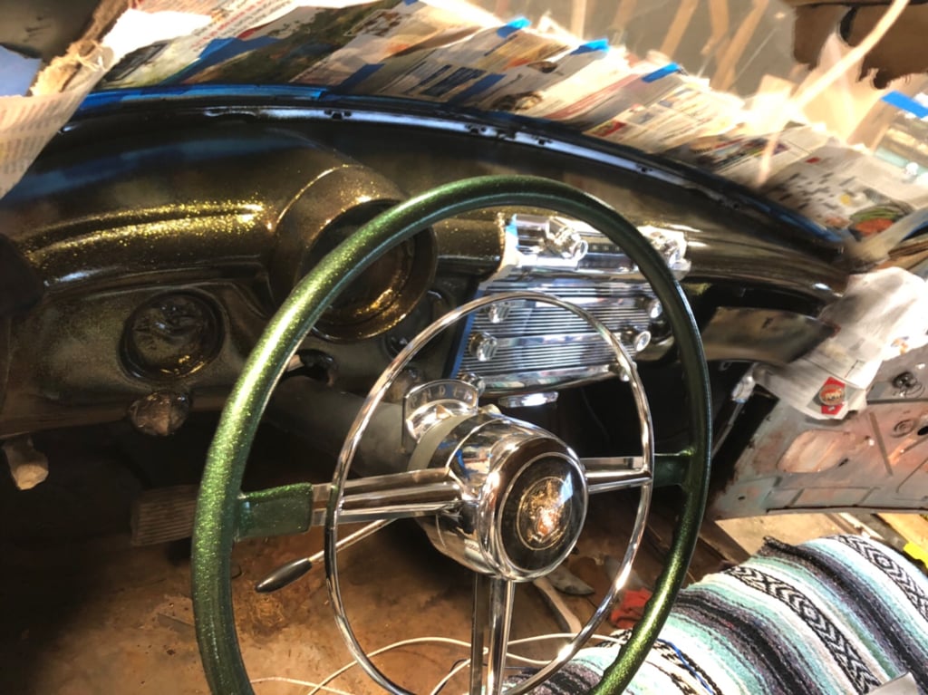

    1. Okie Hambers
    51 Buick wheel I restored used plastic filler only not its trying to come apart lol gotta redo it and use that epoxy for sure [​IMG][​IMG][​IMG]
