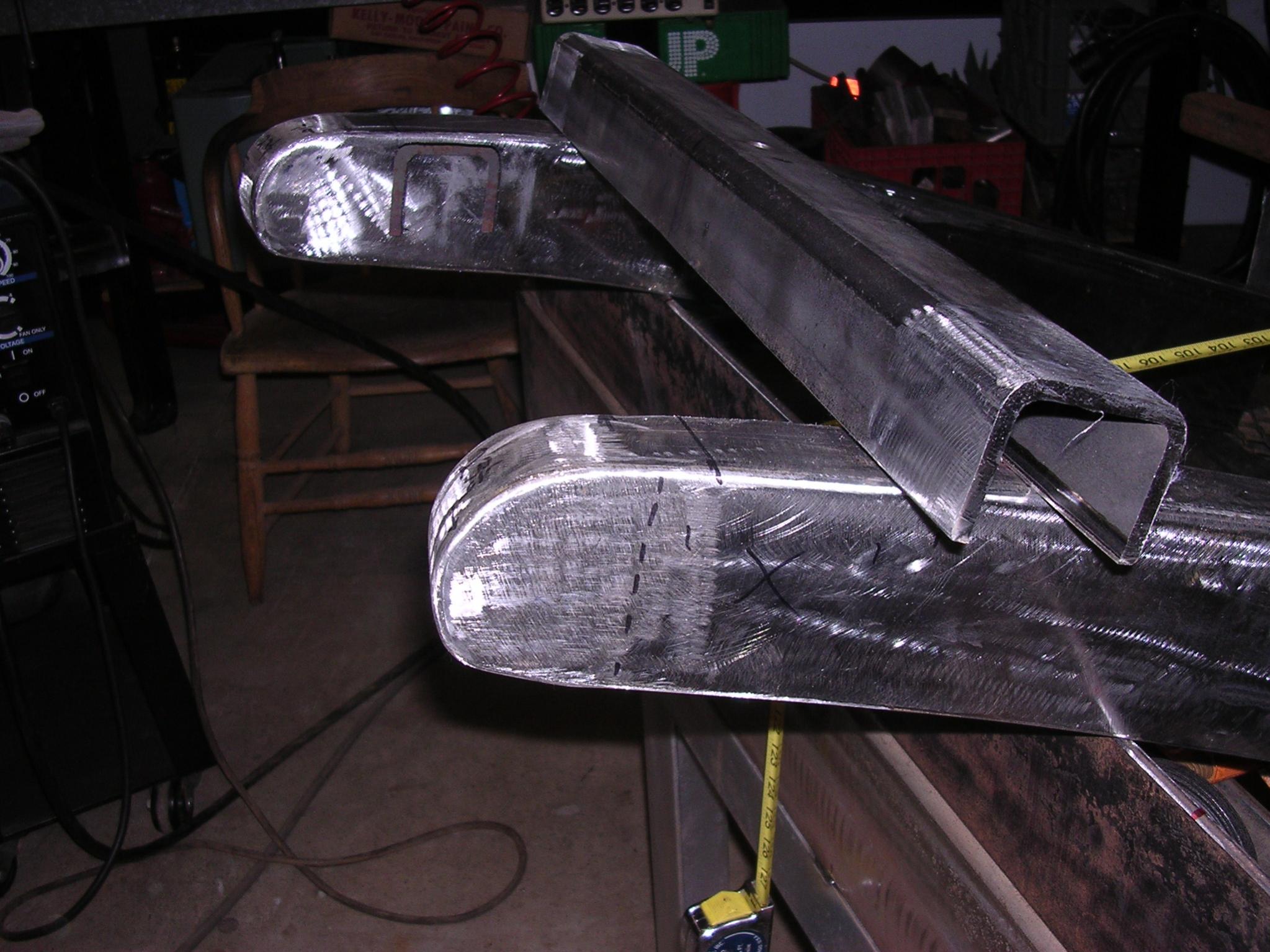

    The 4 X 2 tube is laid down as a crossmember, and the grey primer marks the weld joint. You can even tip it to get the 7* caster angle if desired. Circa 1973...home built tradition...

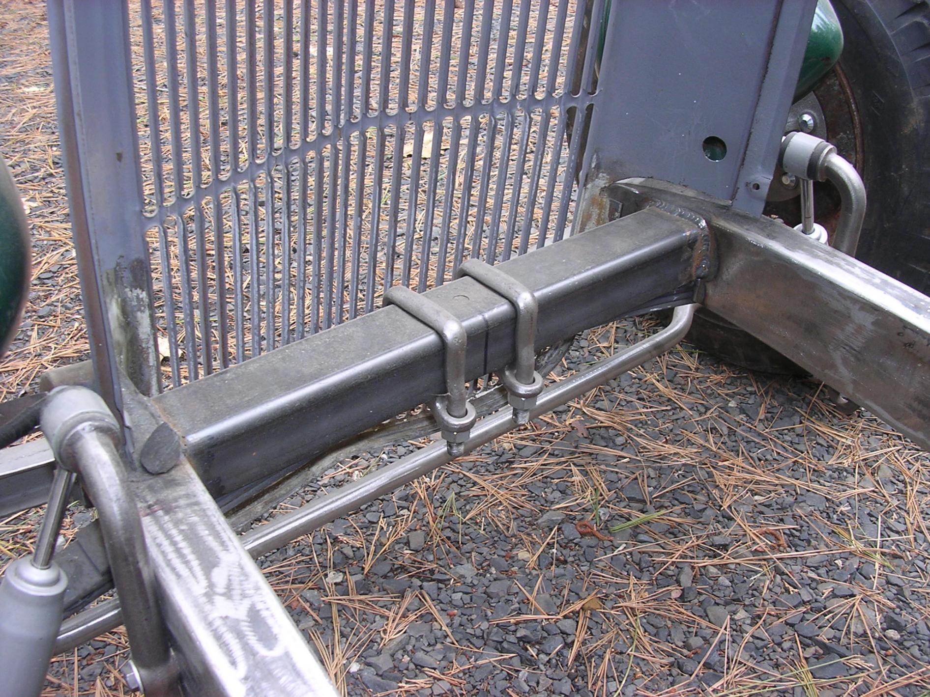

    I used a piece of trailer hitch receiver tubing. cut out one section to make a channel. the front spring fits in just right, strong as heck! and a flat top to get a little more in the weeds. also the spring clamps fit perfect.
