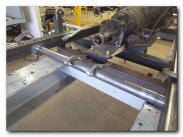

Old 12-19-2008, 11:36 AM   #11
WelderSeries
Alliance Vendor
WelderSeries's Avatar
Join Date: Sep 2007
Location: Cambridge, ON
Posts: 582
Default Re: Welder Series Model A Frame
pic 1
This is just a shot from over the driver side frame rail showing the tapered rear side of the crossmember. We have also attached the frame horns. The bottom of the frame rails had to be pie cut to match the height of the frame horns.
pic 2
Moving on to the motor mounting phase, we're trying to keep both pans above the bottom of the frame rails.
pic 3
The motor is sitting lower than in most cars, but with the frame so low it really looks like it's hanging out in the middle of nowhere!
pic 4
When your mocking up bars or brackets, it's a good idea to leave one half of the bushing out. This way, you still get the correct width and center, but it's way easier to disassemble later.
pic 5
We started by bolting the tubular mount to the block. This is the shorter of the two lengths we make.

Posts: 582
Well, it's not exactly the front end like I said... similar only different
pic 1
Here's what needs to be mounted next. We needed to decide a few things before going ahead and getting the mount we wanted. First, the transmission had to drop straight down. While not completely necessary, it's handy. Second, we tried to allow for growth. If a crossmember tube is directly behind the tailshaft, it's hard to change to a larger transmission without doing some major surgery. If you're married to a particular tranny, give'r.
pic 2
This is a kit from a great company I know called Welder Series. The tailshaft bracket attaches with two bolts; two on the back (you can see one), and two on the bottom, in the original mounting holes. A GM insulator is used between the tailshaft bracket and the crossmember bracket, which bolts on to ears that are welded to a 1-5/8" tube. This is the crossmember bracket kit, and here is the tailshaft bracket. The little reinforcing tab should be on the store shortly.
pic 3
Here is the trans mount mocked up on a 1-5/8" tube.
pic 4
Grant is using a carpenter square (I didn't know anyone other than a carpenter used this tool so often!) to measure for some reinforcing tubes.
pic 5
Strong, removeable, and lots of room for growth.
I should ask if people like this format... pictures attached, or would you rather have the images as a part of the post?

Subscribed to this thread. I am really learning a lot about laying out a frame. Being 3/16", this frame should be able to handle about anything you throw at it.
Also, I didn't realize you were from Canada. That gives us Yanks a better shake with the exchange rate as you point out.
I use the carpenter's square a lot as well, I figured everyone did. Between that and the Skil saw with one of those C-5 carbide metal cutting blades from Harbor Freight, you'd think I was a carpenter.

Those bends sure make life a lot easier, Never seen anything like them in the U.K.
