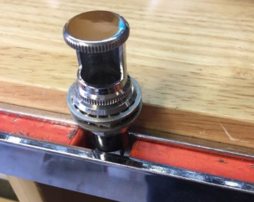

  2. Used to see a lot of panel lights similar to these on old engine and equipment panels. Same idea as a Model A panel light; but on a much smaller scale.

    I had something like that in my mind and yes I recall seeing them now as you said on Model A dashes...Thanks Rich.

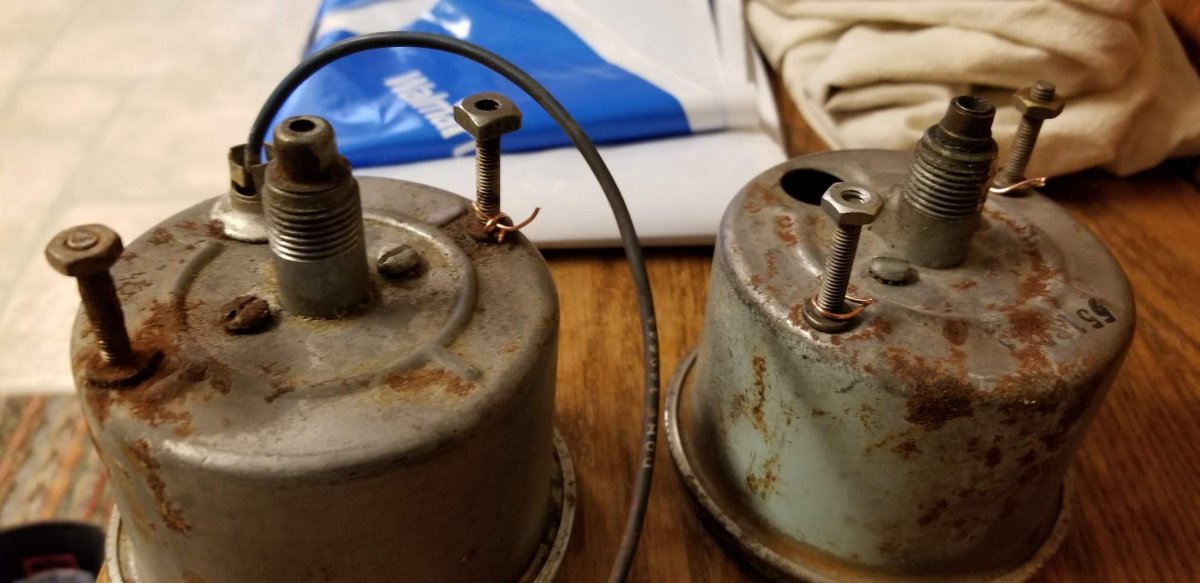

    Here's a Stogy...:confused:...gauge moment for you...I was in a huge local Antique haunt and asked about old car stuff and the Owner told me where to look so I sifted through many items and found 2 SW mechanical tachs $15 a piece...took them both kinda thinking I found some Hotrod gold...;)...I thought I would offer them to Hambers as I didn't need them...
    Low and behold when I got home I was looking at the RPM and I think I bought Tractor or Boat Gauges...:eek:...So now Stogy's stuck with a couple of paperweights...I know a few of you will get a chuckle out of this...I felt a little bit of a Dumbass myself...:D

    No-that was fate telling you that you needed to buy a new tractor and boat for your gauges!

    This is exactly why I snagged them as Alchemy pointed out that Riffs Tach is a Sun so if he wanted to change it out to a complete set of SW and what I had was applicable I would basically sell it for what I paid for it...but again I think these are not for a small block application and they would have to match period. One might the other has to much color. As you can see they have chrome issues as well BUT they are authentic...;)...and no I am not buying a boat or tractor...:D

    Riff I'm still chuckling at myself and I'll bet the antique guy was Real Happy to see me...he even wrapped them nicely in paper before he placed them in the bag...:D
    I will say you do have all the necessary bases covered in those gauges in the dash plate.

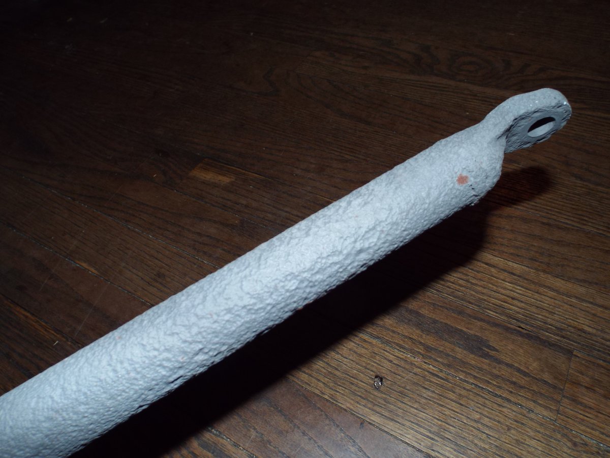

    HAMBer Duece found some rear bones for sale, but after looking at all the photos they looked very pitted towards the ends. Am I right in identifying this?

    The bottom one is pretty bad. These 35/36 arms all have a couple of factory holes where water & humidity can get in and then stay wet for decades. The rust inside can often be worse than the outside, as the piles of rust flakes stay wet in there.
    That pair likely came from a car sitting on dirt with no wheels. I would avoid those for sure. .

    That's my kitchen floor! Bones are blasted and unprimed. Here is another shot of the bottom one I took 5 minutes ago. Bob
