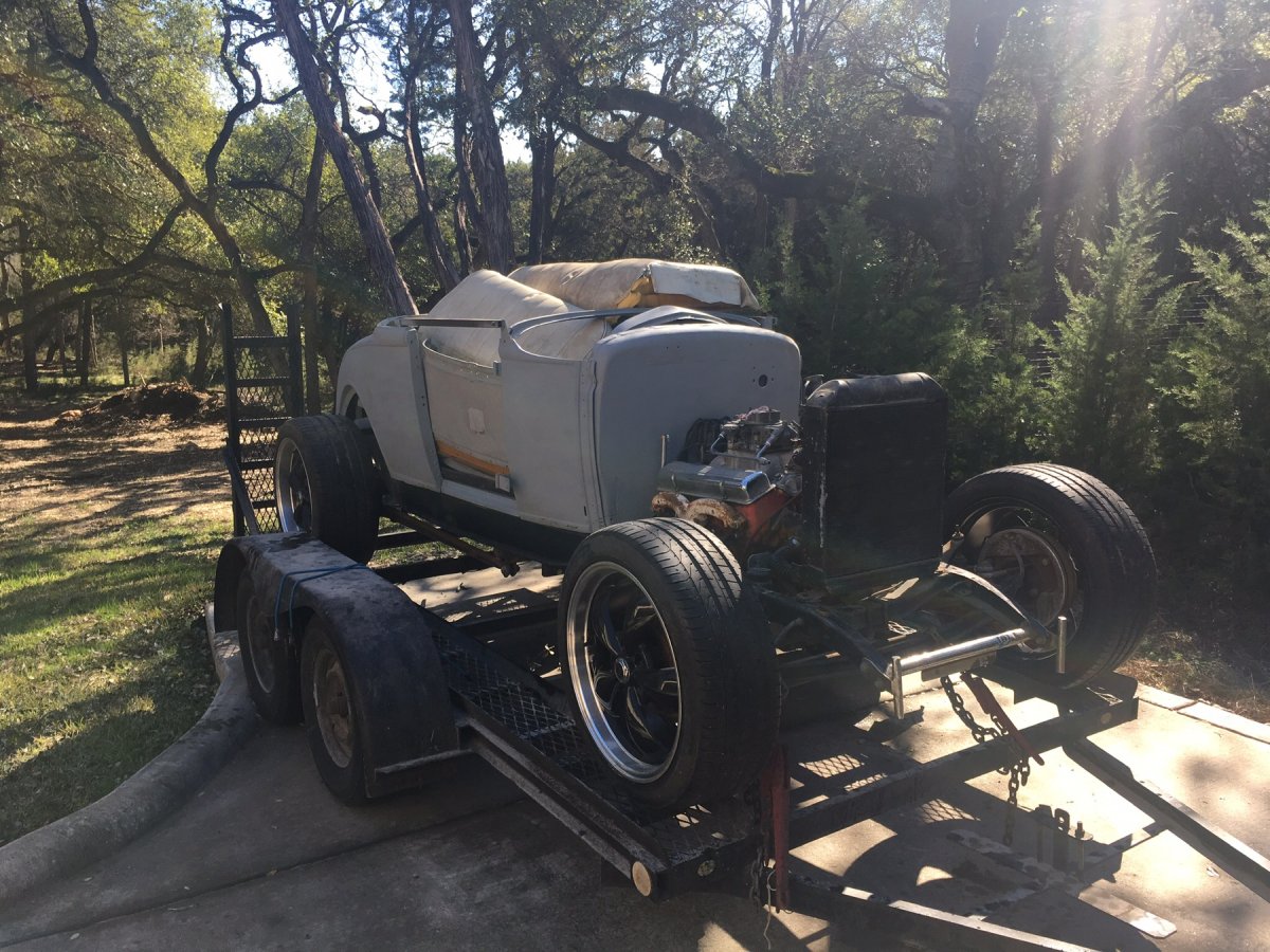

    The Riff Raff Roadster is back on home soil, all pieces accounted for, waiting to see if our preferred builders (Rexrods) are interested in taking on the project and can fit us in after the Roadster show in CA. P.S. wheels and tires shown are temp roll-arounds only. Also, its on the original trailer that came with the car back in 1970 Amarillo. I’m considering having that fixed up as well.

    Just an observation on the firewall it seems to have been modded smoothed and perhaps angled in for the smallblock or even something prior to that. This is a Stock Roadster below...This is of course just an observation and not to be negative. Its talking along with you observing what has been done along the way since it popped out of Henry's shop

  10. flatford39
    Joined: Dec 3, 2006
    Posts: 2,625
    flatford39
    Stogy...please be a little clearer. It sure looks like a roadster cowl to me. I have a 31 myself and I don't see what you see.
    RiffRaffRoadster and Stogy like this.
  11. Stogy
    Joined: Feb 10, 2007
    Posts: 16,737
    Stogy
    It looks smoothed and tapers down towards the bottom of the cowl...if Riff takes a closer pic we will be better able to see it...I'm going to look back in the thread I think he had some other pics...Maybe its the primer and my eyes...:confused:
    I snooped back and couldn't really see it in the other pics clearly...and I also know there was a lot of pretty quick and dirty mods going on back in the day...just look at Kookies cowl behind the stainless. Its just something I noticed much like the taillights...she has her clothes off now for all to see...:eek:

  12. flatford39
    Joined: Dec 3, 2006
    Posts: 2,625
    flatford39
    The firewall has certainly been modified in an interesting way but I am talking about your reference that you think it is a coupe and not a roadster. The cowl looks just like my 31 roadsters except for the modified firewall.

  14. RiffRaffRoadster
    Joined: Dec 24, 2018
    Posts: 422
    RiffRaffRoadster
    Stogy-you’re right. The main part of the firewall looks like it was cut out and replaced with a new piece of sheet metal. I’ll see if I can find a better pic...

    For all we know it had a Hemi in it once...Thats an interesting mod...
    To all the Model A Pros Riffs Roadster has bumps for the Cowl Band is that a Deluxe Model indicator?

    Is this taper unusual?
    Stogy likes this.
  18. Stogy
    Posts: 16,737
    Stogy
    There were all kinds of mods done to Hotrods even wood was put in place of steel...it is just another clue to its past...It was done for a reason...these cars had 4 cylinder engines stock but technically the firewall was good for a flathead ford engine.
    Who knows they may have felt it required when they switched to the 32 frame.
    By the way its looks fairly well done...;)...and the patch for the gas cap looks pretty clean too.

  21. flatford39
    Joined: Dec 3, 2006
    Posts: 2,625
    flatford39
    No they all had cowl bands in 30 31.

  23. redo32
    Joined: Jul 16, 2008
    Posts: 1,684
    redo32
    That looks like 3/16" plate for the firewall. Probably won't need reinforcement for the clutch pedal.
    Stogy and RiffRaffRoadster like this.

  25. RiffRaffRoadster
    Posts: 422
    RiffRaffRoadster
    Stogy-I’m thinking that tapered firewall mod has meaning, and the only reason I can think of was that it had a larger motor at some point?
    Stogy likes this.
  26. Stogy
    Posts: 16,737
    Stogy
    It does, every change was due to a certain dilemma. As Redo said your Hotrod probably had pedals hanging off the firewall and the heavier metal was added partly for that reason. It may at one point had a large area of the original firewall cut out to allow a engine setback for a race application...then to return to street they put what is there now in. I believe when adding a small block you do have to mod the original firewall for the distributor and tranny.

  28. low down A
    Joined: Feb 6, 2009
    Posts: 291
    low down A
    that firewall hack job was probably done when it was on the A frame there is no reason to cut the firewall of an A when it's on a 32 frame you gain a couple extra inch's in length. this car obviously has gone thru several reincarnation's. with the best part that original paint being gone build it how you want
  29. X-cpe
    Joined: Mar 9, 2018
    Posts: 975
    X-cpe
    I thought one of the reasons to build an A on a 32 frame was not to have to mod the firewall because the 32 wheelbase is 3" longer than an A. I built my own frame with an A wheelbase and had to recess the firewall 3" to clear the whole back of the engine (SBC), not just the distributor. (Although I guess some some people do use other engines. LOL)
  30. Stogy
    Posts: 16,737
    Stogy
    Honestly this thing as has been alluded went through a walk in hotrod history. That change could have been like many in a prior period under a previous frame or it could have been just done without any forethought or knowledge that it wasn't even needed. This Hotrod did carry itself well it seems and was far from a hack job in my opinion. It even sat pretty nicely on that 32 frame along the filler strip area to boot.
