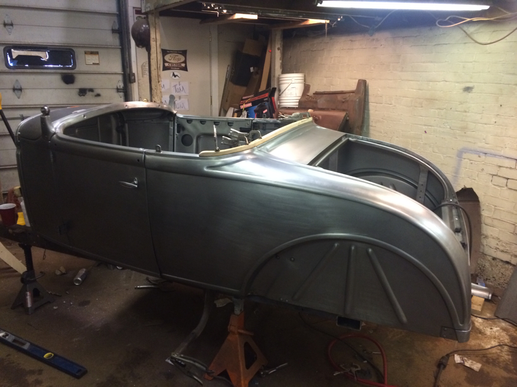

    putting together a 31 brookville body . heres how it goes .
    its in there somewhere
    they were nice and assembled the cowl for me
    mmmm fresh metal
    subframe on wood blocks and bolted down . floors pans screwed in ready for rivets
    door 1 hung . gaps addressed .
    a real nice fit
    she needs love
    mucho bettero
    nice gap on the door to quarter as well .will need finesse once its solid
    other door also hung
    cars going together well
    more progress as it come .

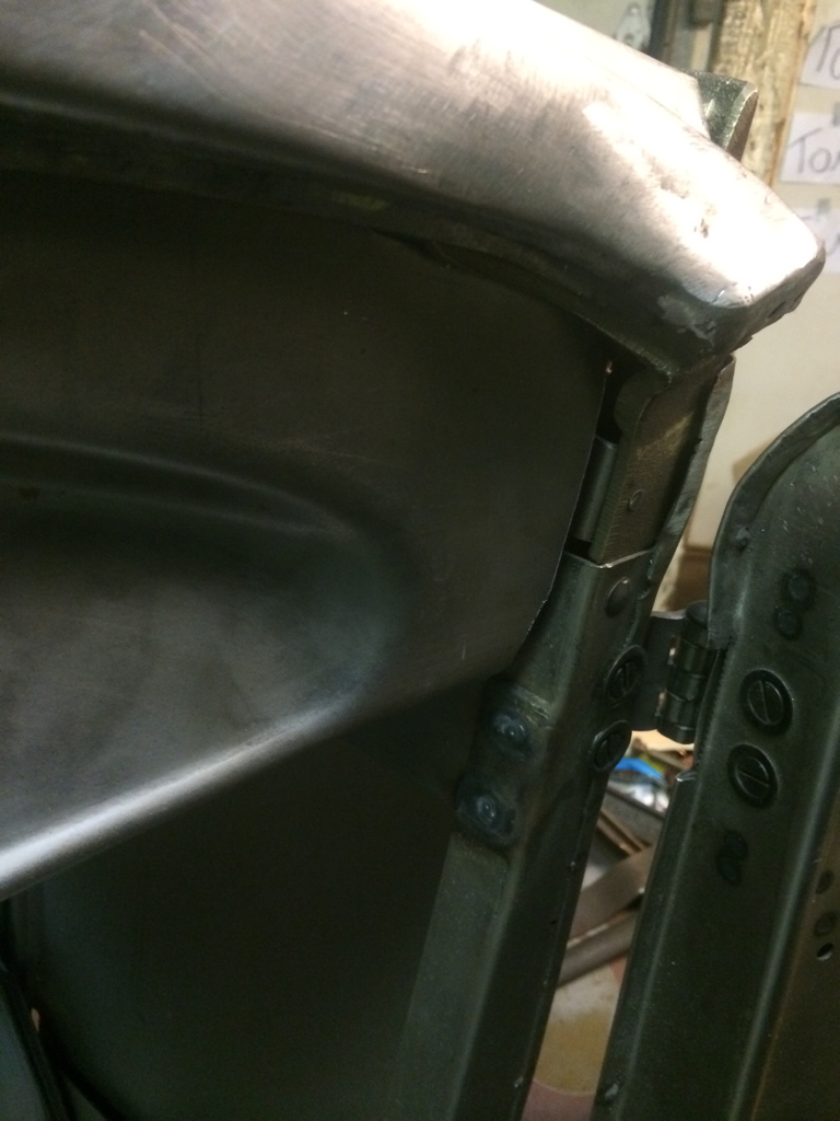

    ImageUploadedByH.A.M.B.1452861951.608170.jpg what a pain finally got it and sitting proper .
    Gaps are addressed later
    Stanchion fit
    Lots of detail work here .
    They don't just fit
    After

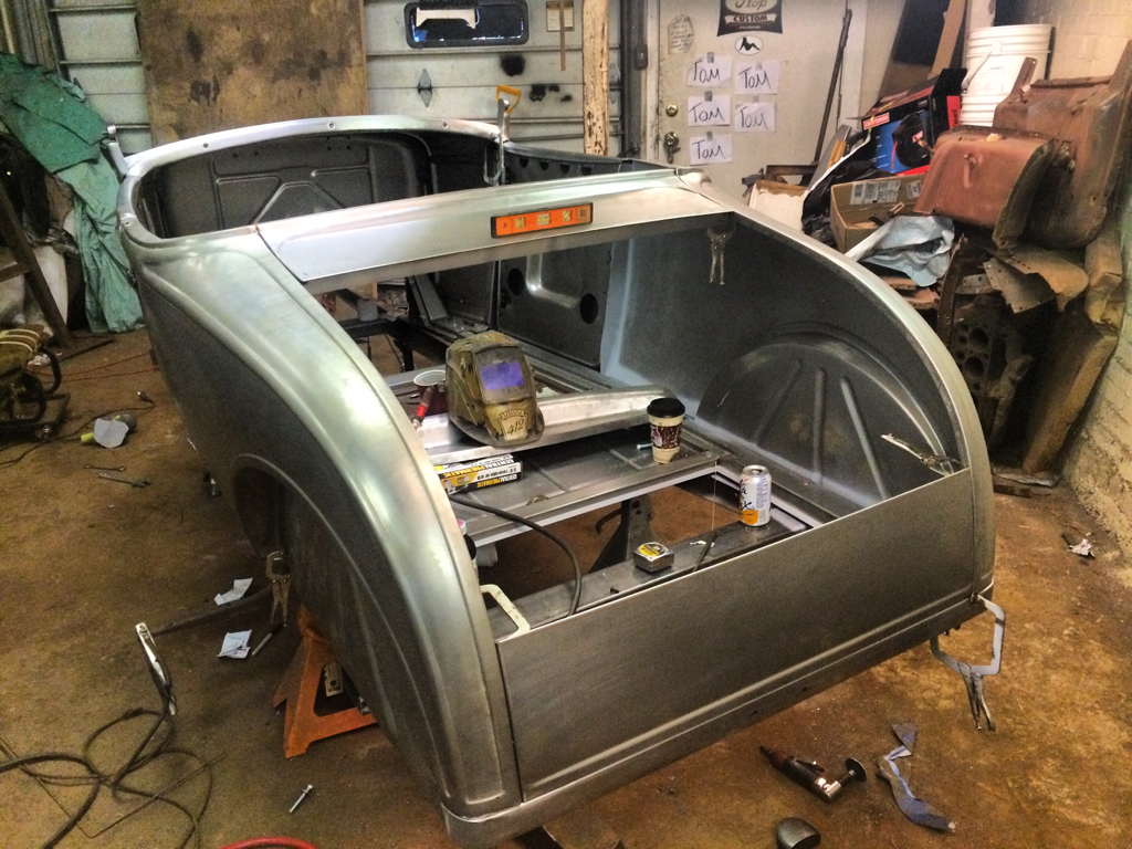

    Quarter time
    Properly shimmed body requires no downward force on the door keeping nice gaps up front .

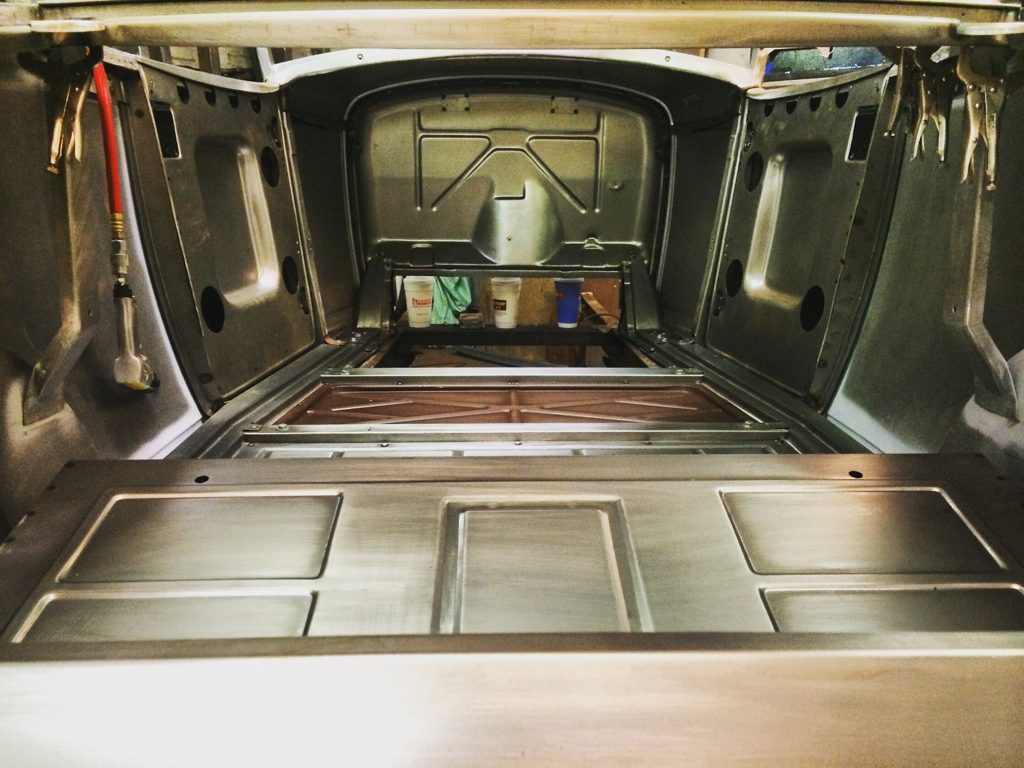

  12. Flop
    Joined: Jun 8, 2006
    Posts: 3,886
    Flop
    Time to get things bolted in in the back .

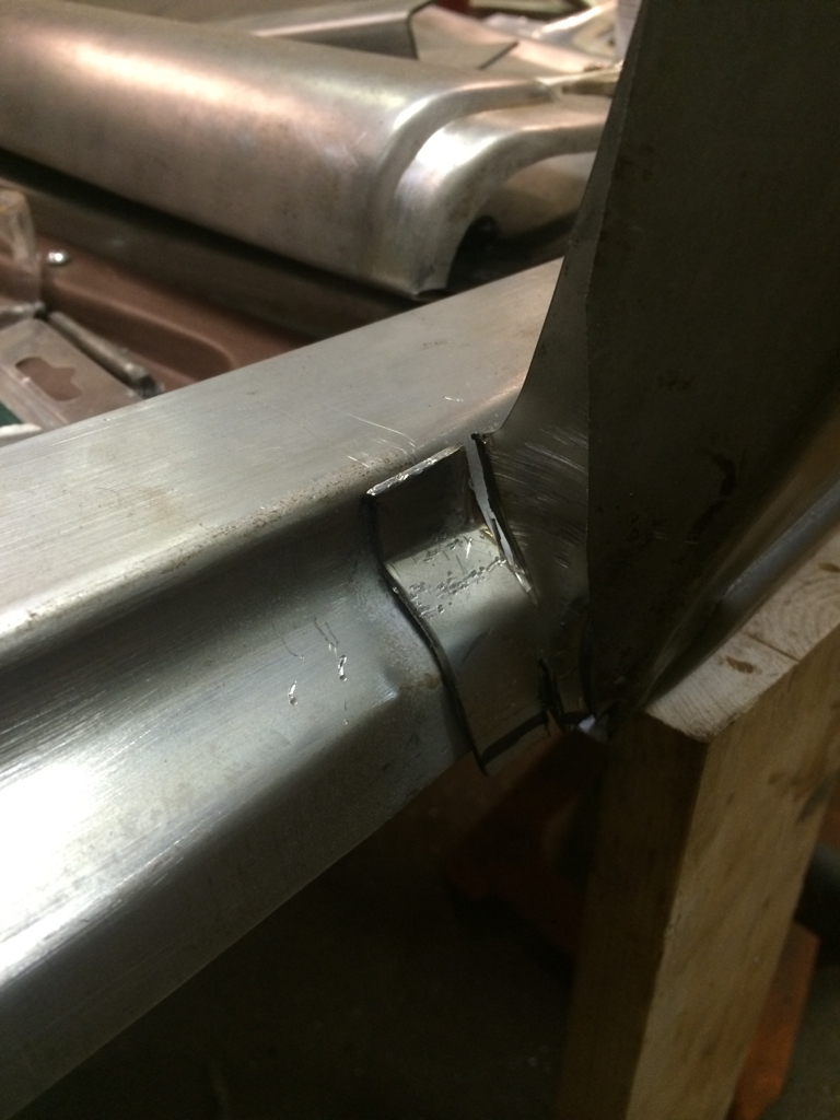

    Chopped stanchions
    It drew the blood !
    Didn't fit so we before
    Had to put the reverse curves in and tighten up the gaps to the body
