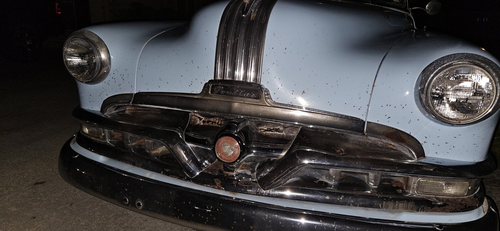

    bchctybob
    Don’t you just hate the damn bugs? Out here where I live the poor car gets pelted with bugs all year round and sometimes it’s just crazy how many bug carcasses you have to scrub off the front end.
    PhilA and loudbang like this.
  5. In FL during luv bug season the car would be black in about a half hour if you were running to the east coast across the swamps. Have to stop half way and get the first layer off the windshield just to see the road. Baking soda and hot water would remove them quickly so long as you did not let them bake on in the tropic sun. Fun times!
    bchctybob, PhilA and loudbang like this.

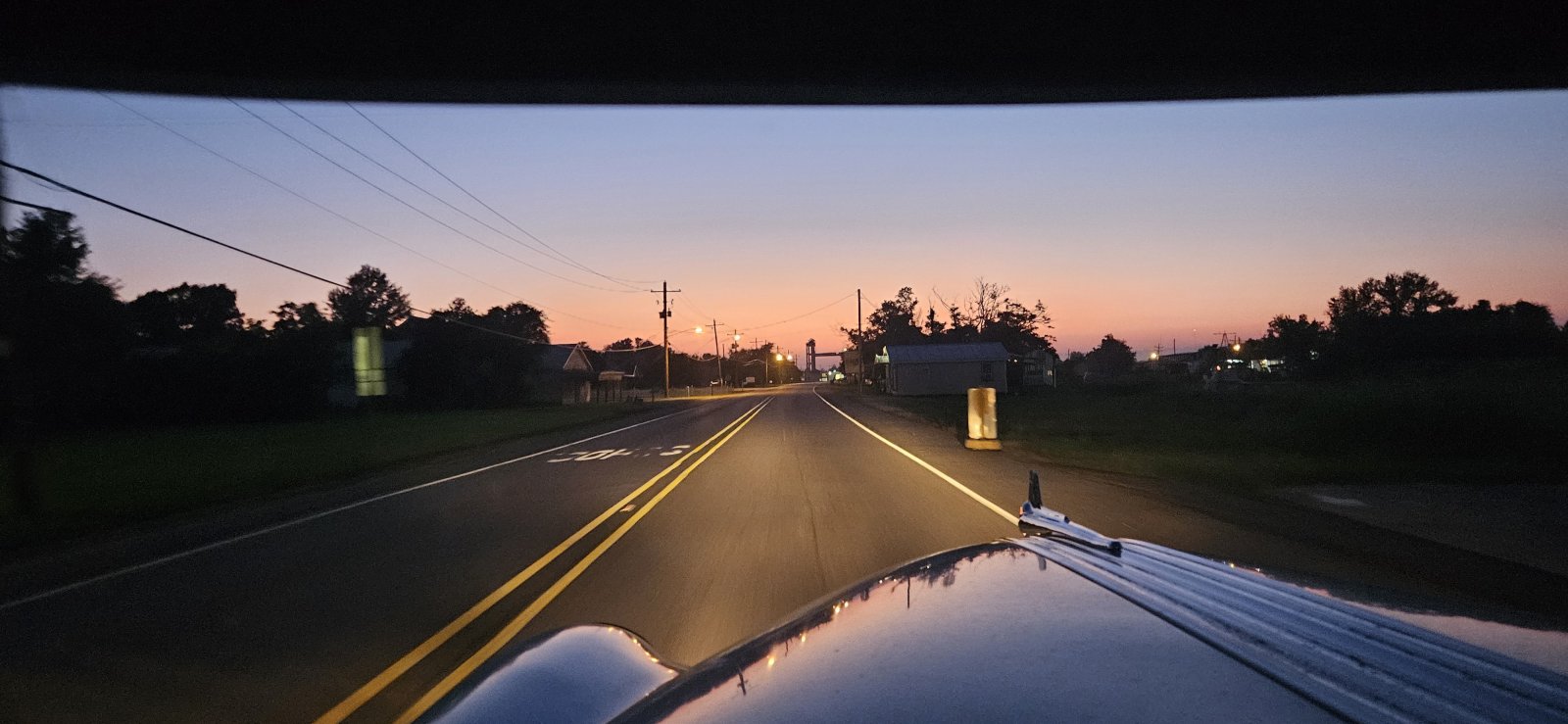

    1. Hydro Tech
    Hot, hot, hot.
    All the windows rolled down, out on the highway.
    Phil
    bchctybob, fyrffytr1, brEad and 4 others like this.

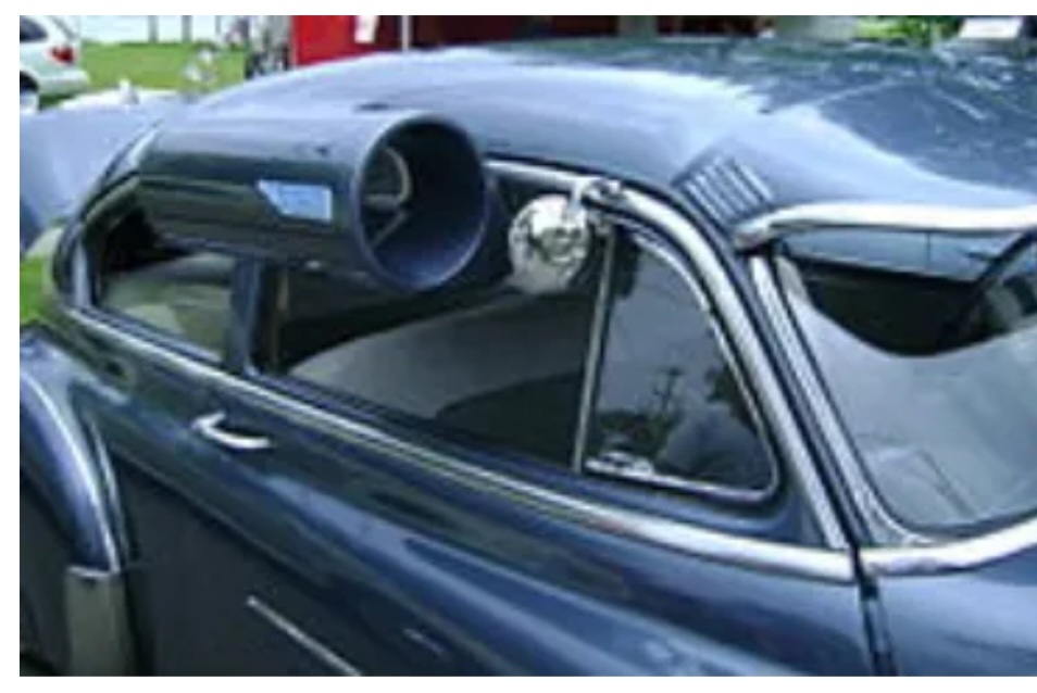

  7. Johnboy34
    Joined: Jul 12, 2011
    Posts: 1,653
    Johnboy34
    from Seattle,Wa
    fyrffytr1 likes this.
  8. TrailerTrashToo
    Joined: Jun 20, 2018
    Posts: 1,407
    TrailerTrashToo
    Evaporative coolers only work in dry air. Phil is on the coast, the air is already saturated with moisture.
    brEad, PhilA, Woogeroo and 1 other person like this.

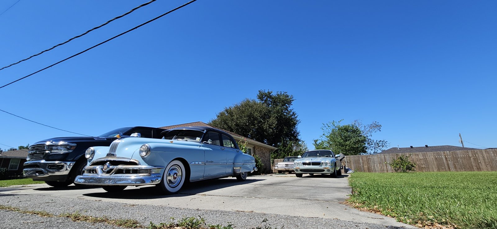

    PhilA
    1. Hydro Tech
    Coaxed the starter into life. Really need to do something about it.
    Went get milkshakes. It's running okay but it's definitely grumpy from being sat up.
    Still, looks good sat on the driveway. Currently managing an eclectic collection (the green one being the reason I've not been posting much here, it's been taking to the time and money).
    Phil
    bchctybob, Mtn Goat, Ford52PU and 5 others like this.
