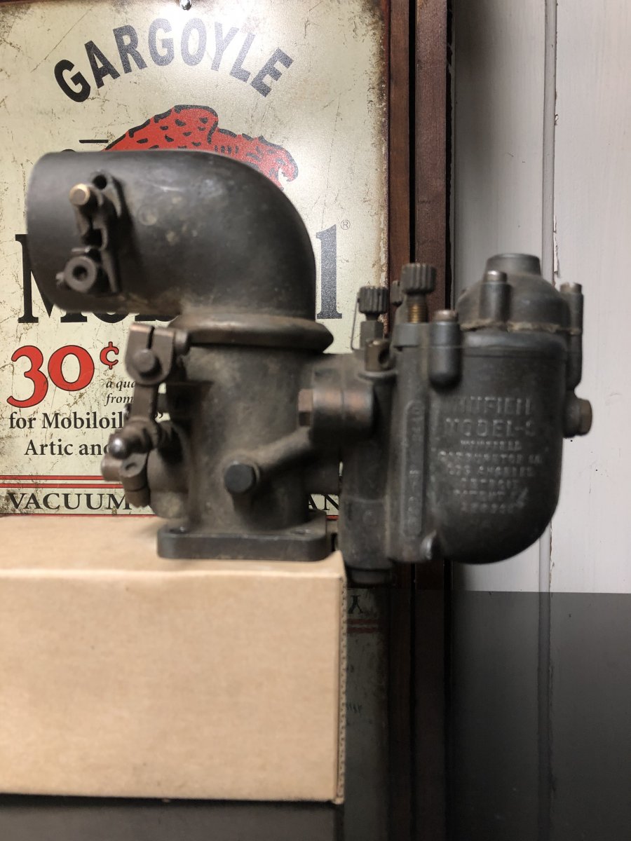

    Gents. Got my Winfield S-B carb! In the process of cleaning it up and putting new gaskets. Had a question ; can i do away with the choke or should I keep it. If I got rid of the choke elbow I was going to adapt a pipe to the flange and put a filter or stack. Just a thought
    Dannerr likes this.
  11. I'd keep the choke and it's elbow. It very well might be a part of "The Flow" of the carb!

  13. You could look for one of the SR chokes. Those don't have the elbow. I run a Winfield and use a very fine brass screen between the choke and throttle body.

    @waxhead that looks cool. I’m guessing you’re running a fuel pump since I see a line going up and down. Is the tank not high enough to gravity fuel to the Winfield ?
    waxhead likes this.
  21. waxhead
    Joined: May 11, 2013
    Posts: 1,173
    waxhead
    from West Oz
    I was running a low pressure fuel pump and regulator with this set-up. Do you have the manual to set up these carbs?? I am pretty sure it mentions fuel supply pressure in there somewhere. I can dig it up if you want me to, but I am sure that the Winfield would run without a fuel pump also.

    I recommend keeping the choke. I use mine every time I start it cold. I have the SR-B carb. For a filter, I picked up a cheap old stainless steel curved kitchen strainer, trimmed it to fit and safety wired it over the top. It’s still there after over almost a year. I also don’t run a fuel pump and keep the fuel at least over 1/4 tank.

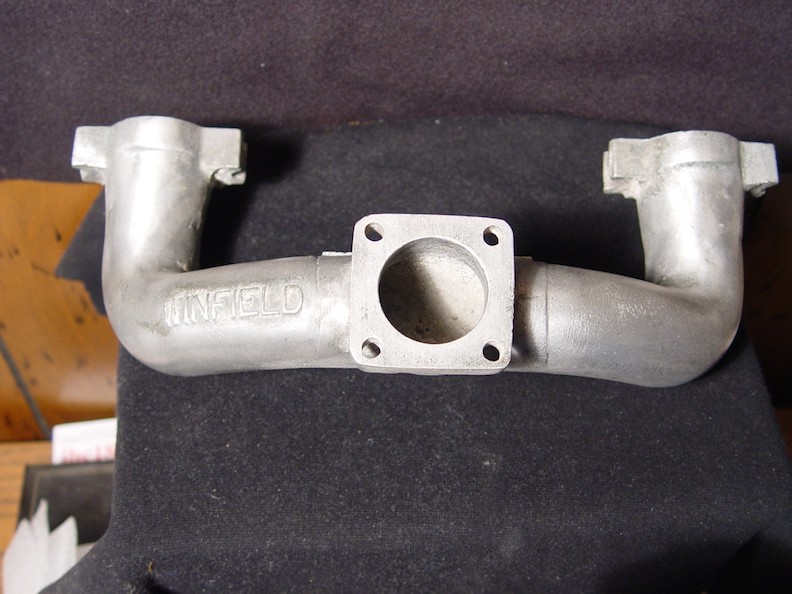

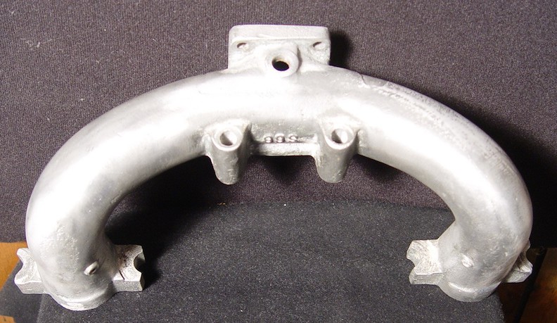

    ghalperin-is that a modified stock intake manifold? I can't quite figure it out. Nice set up!

    Original Winfield Manifold painted Ford green! Neat!
    My, I wonder how that would fare at the Dirt Drags?

    That is a Winfield intake.
