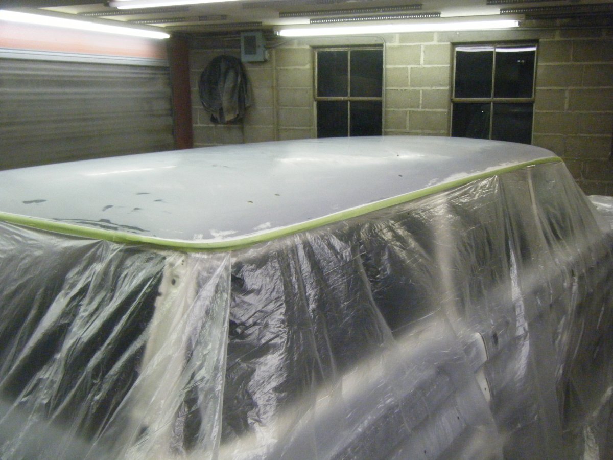

  5. on this wagon i taped off the car and painted the roof first, this allowed me to lean/kneel on the car so i could reach over. DSCF0001-1.JPG

  21. I agree with tb33anda3rd.I used to shoot cars in 1 shot. Now that I am older {64} and having more aches and pains I always shoot the roof 1st even if it the same color, then let it harden for a few days and then tape off the roof and paint the rest of the car. Sure its a pain in the ass but I want the car or truck to come out decent looking. GOOD LUCK with the job. Bruce. 001.JPG

  23. What kind of station wagon are you painting there? Thanks Bruce.
  24. 001.JPG LOL. Bruce.
