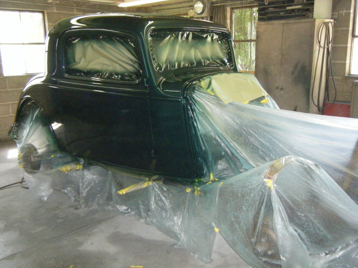

  4. Taping
    the chassis and windows have been taped off. this is for two reasons, one to keep paint off of the inside of the car and the chassis and two, to keep any dirt/dust from the inside or chassis from getting in the final paint. DSCF4005.JPG

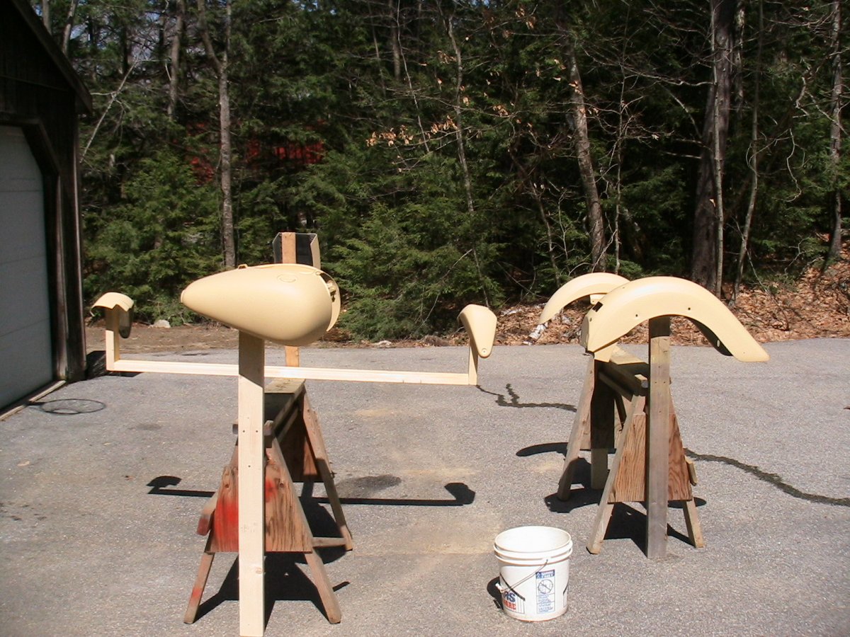

    Here's some paint on two-wheeled devices, getting ready for primer on 3 different bikes. Note the "trees" designed to hold the Harley half tanks for 100% paint coverage all while remaining perfectly still...
    Fenders have brackets made on tripods using simple rods through the factory mounting holes, again we'll have 100% paint coverage in one sitting..

    Not as nice as Robert's above, but here's my home made bike parts stand I threw together to paint my stuff. It ain't pretty, but it works!

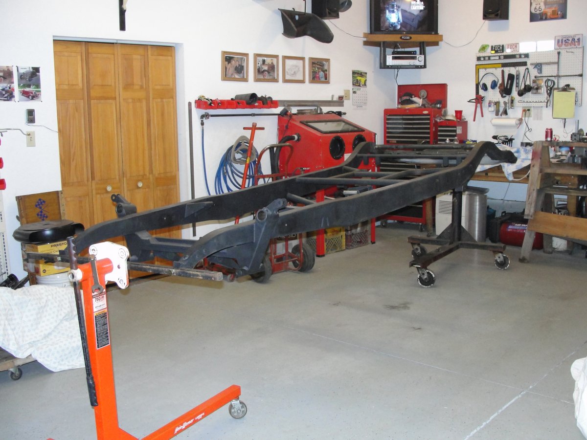

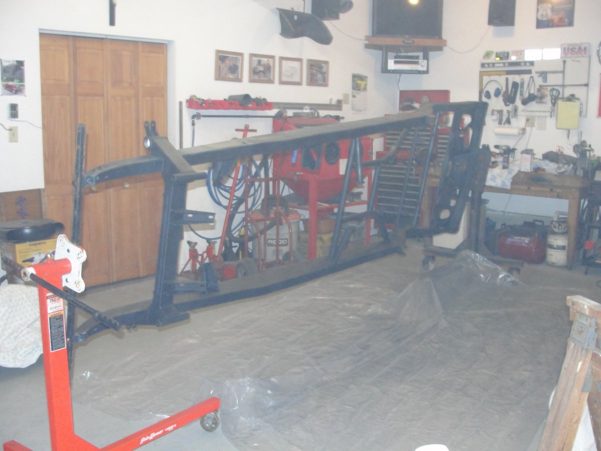

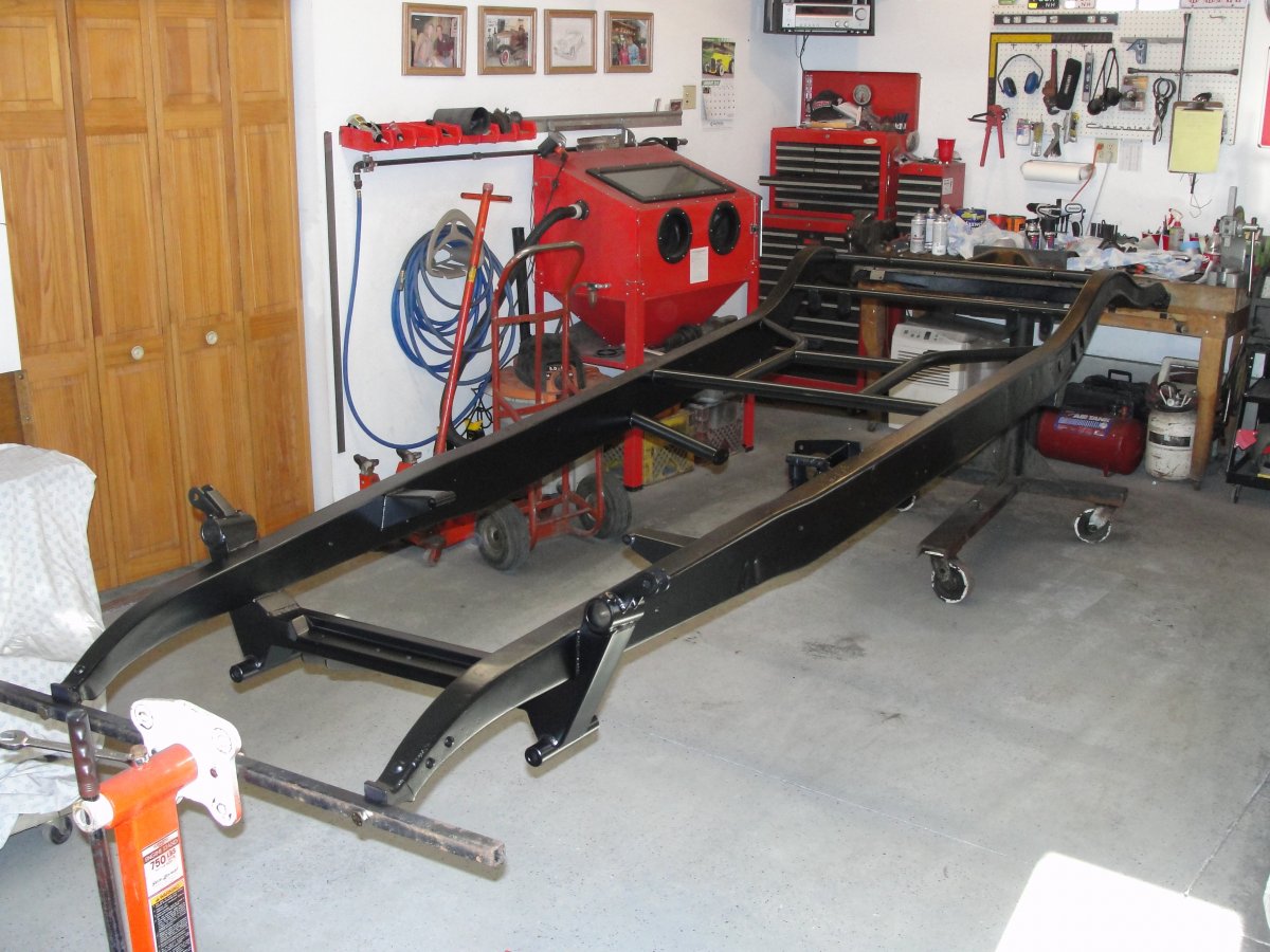

  17. I didn't have a chassis rotisserie so I use two engine stands and some square tubing to mount my chassis to. That allowed me to rotate the chassis and paint it in my home garage DSC06308.JPG DSC06310.JPG DSC06318.JPG .
