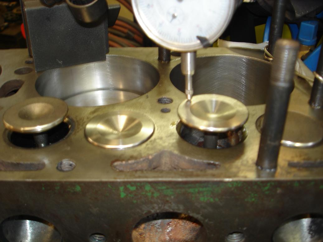

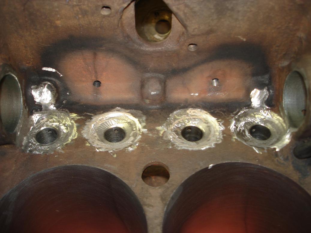

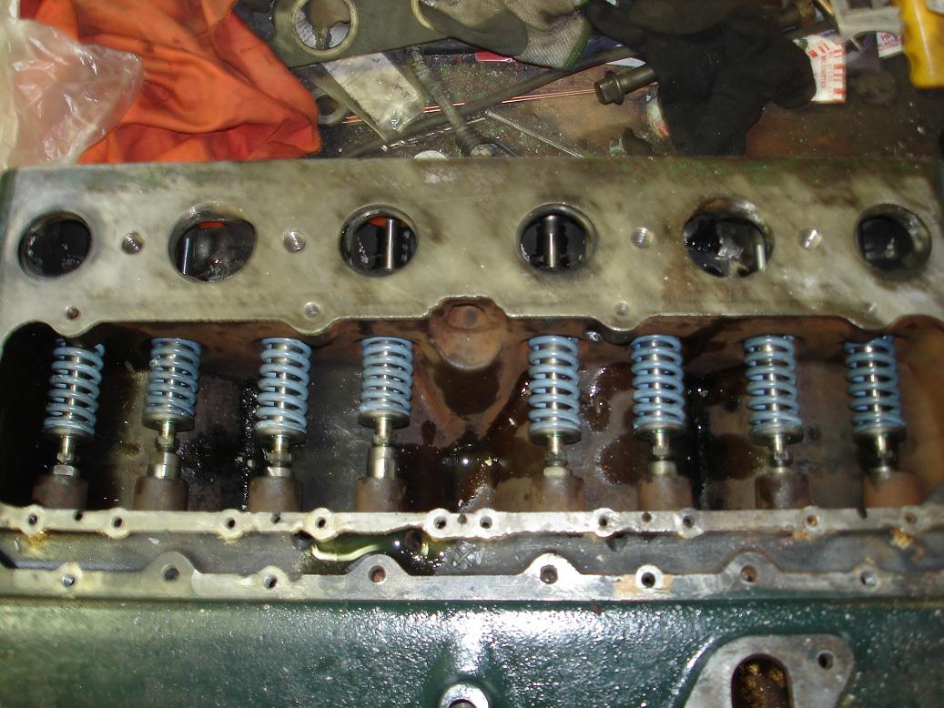

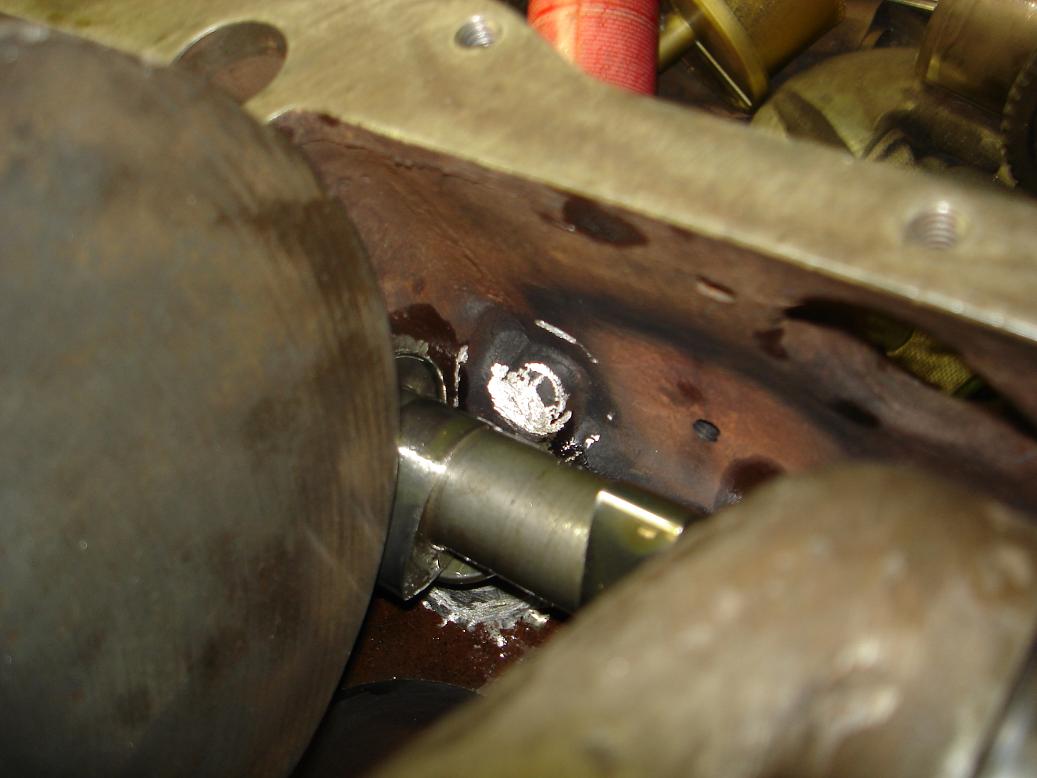

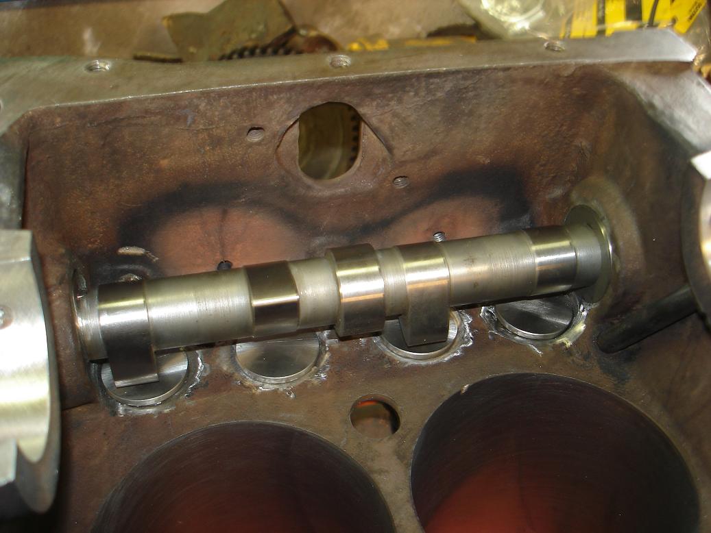

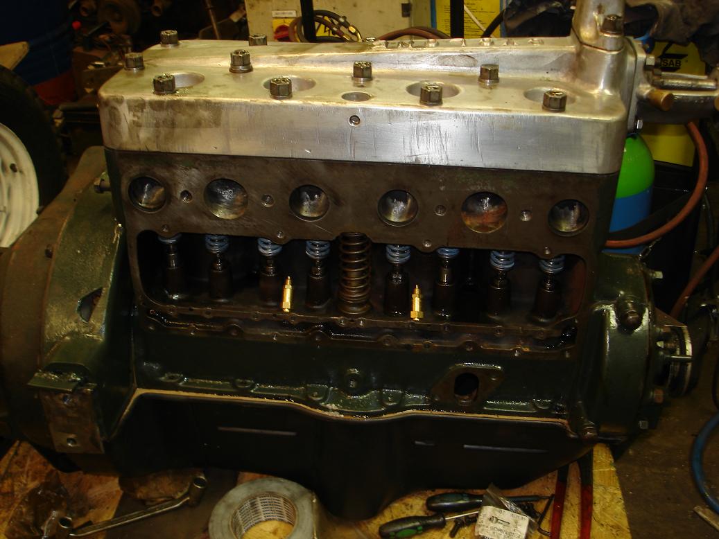

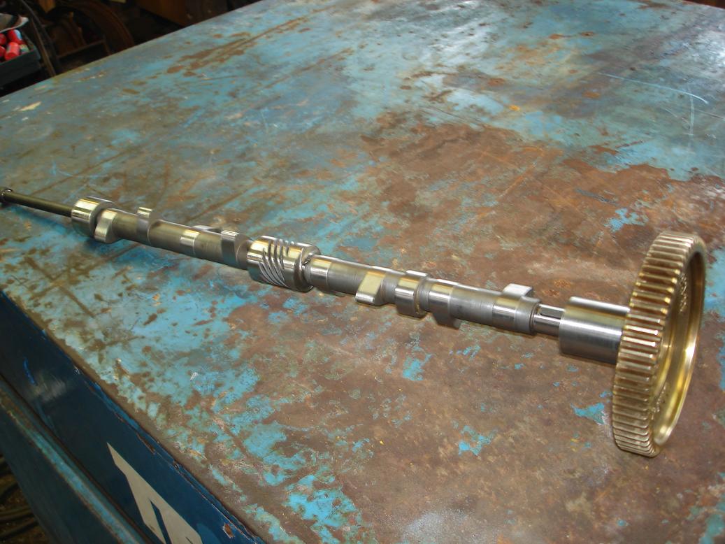

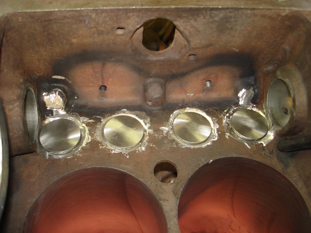

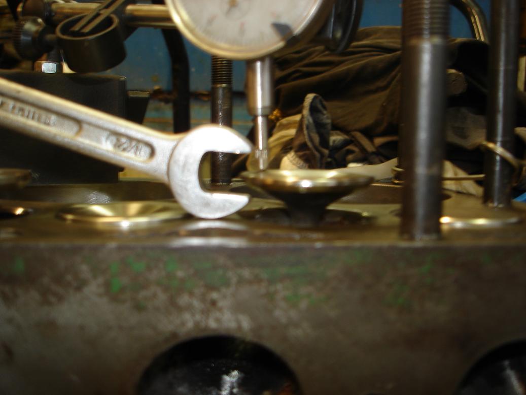

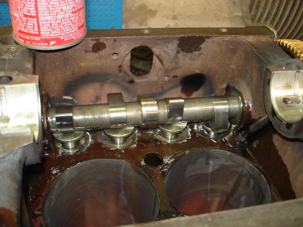

    This is a little post about my latest engine build. Only a year or so delayed, but now it's running, or at least it was. Ths build has taken some time, I've changed my mind a few times and I've had loads of setbacks.
    The base engine is nothing spectacular just a normal build, but I did most of it myself. It's a model B fully pressurized including drilled crank of course. I modified the oilpump with a relief valve. I also have two relief valves in the valve gallery. Insert main bearings, inserted Gerber rods, 1.7" intake valves, stock exhaust valves, Isky flathead valve springs. I'm running a Cyclone head with combustion chambers mimicking the Harley Davidson KR. Forgot to take any pics after they were machined. For induction I run 2 Stromberg 48's on a Tornado intake and for ignition I use a Scintilla magneto.
    What makes this a bit special is the camshaft. I'm running a specially made 4 piece camshaft with about 0.472" lift and about 265 degrees duration. It's made in pieces so it's possible to even mount it without machinig the cam bores. Due to the profile I needed to use some 30's Mopar tappets. They've been mentioned here before. I did have to take some material out of the underside of the valve chamber floor due to the high lift cam.
    I have the engine in the coupe now and I have drivven it 200-250 miles so far. It runs pretty good. By far the best banger I've drivven. It has the most aggressive idle tone I've heard from a banger :D It pulls really hard and I did have it up to 65 mph in 2nd gear (model B transmission) and it still wanted to rev more. I have not had it above 75 mph since the front tires starts to bounce bad, but it really wants to go way faster.
    As I said I did most of it myself, only things I could not do myself was line boring the mains, boring the cylinders, grinding the crank, machining the top deck and doing the rods. I like to do things myself and challenge myself to see if I' able to get it done.
    I've had some setbacks and the biggest one is the connecting rods. I think I went thru 18 stock rods before I found 4 good anough for machining. But they were still a bit thin so I pulled the trigger and bought a set from Dan Eubanks. Beautiful, lightweight things... Except they are twisted more then 3 degrees when compareing the crank pin to the piston pin. The caps have nothing that aligns them to the rod. The caps can be pushed 4-5 thousands side to side so it's no way to line them up on the crank pin. The bore of the caps are about 2.5 thousands larger then the bores of the rods, as they've sprung out after machining. Also you can see by naked eye that the actual rod is not straight but a bit wavy. That would probably not be a problem, but it does not add up to a better impression. After ventilating some of my concerns about these rods I heard it was a known fact that Dan had some rods machined with a twist in them. Thank you for selling them to Sweden. So I now have some really expensive paper weights and Dan refuses to answer my e-mails. I can not recommend buying from Dan Eubanks. I'd much rather had him send me some blanks to machine myself. Sorry for the rant and exposing Dan, but I did send him lots of e-mails and I did tell him that I would post my experiances here.
    Anyway, I'm happy to finally have a good strong engine and I have already many new ideas for the next engine and the one after that... and so on.
