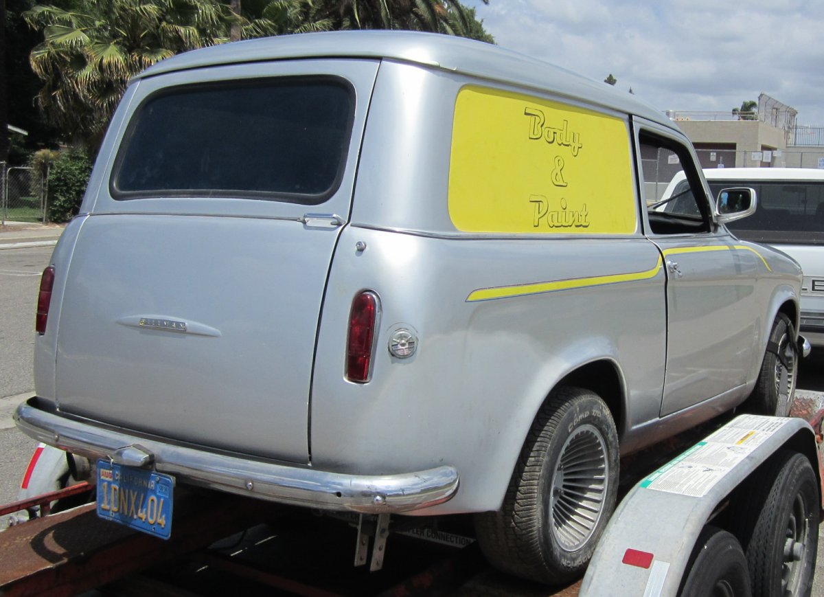

  1. Ok, I have no accuse this time......I have a problem with cars and parts......I think about them, I dream about them, I keep buying them when funds permit. I'm a sucker for odd makes of cars and I've been holding myself back....I guess not anymore. The Studebaker, a Panel truck and now a Hillman.....there's no turning back now :D. I’ve always had automotive A.D.D, I can’t narrow it down to “the one”. Because of that I've never really been into going fast as that would take funds away from another purchase.
    Anyhow, I seen this a few years ago but it was priced out of my range.....fast forward to a week ago I seen it for sale again and a slightly lower price. I made a "keep me in mind for the future if no one buys it" type offer and he said "okay" :eek:. So I picked it up, luckily it's small and fits in the back yard, I've been hitting Pick A Parts to find parts I need (which I haven't done in a decade.....lucky to find 1 80's car).
    The car is a 1959 Hillman Husky, it's running a 2.3 ford with a C3 trans, a stock rear end and stock front brakes.The interior has been redone sometime and is in great shape. Really a solid, running, driving (but not stopping) car.
    The plan is to keep the 2.3, add a T5, a different rear, swap front brakes (either drums or disc), remove the stripes, paint the yellow side panels white, stock chrome mirrors, steel wheels, different carb, new wiring harness and run it.

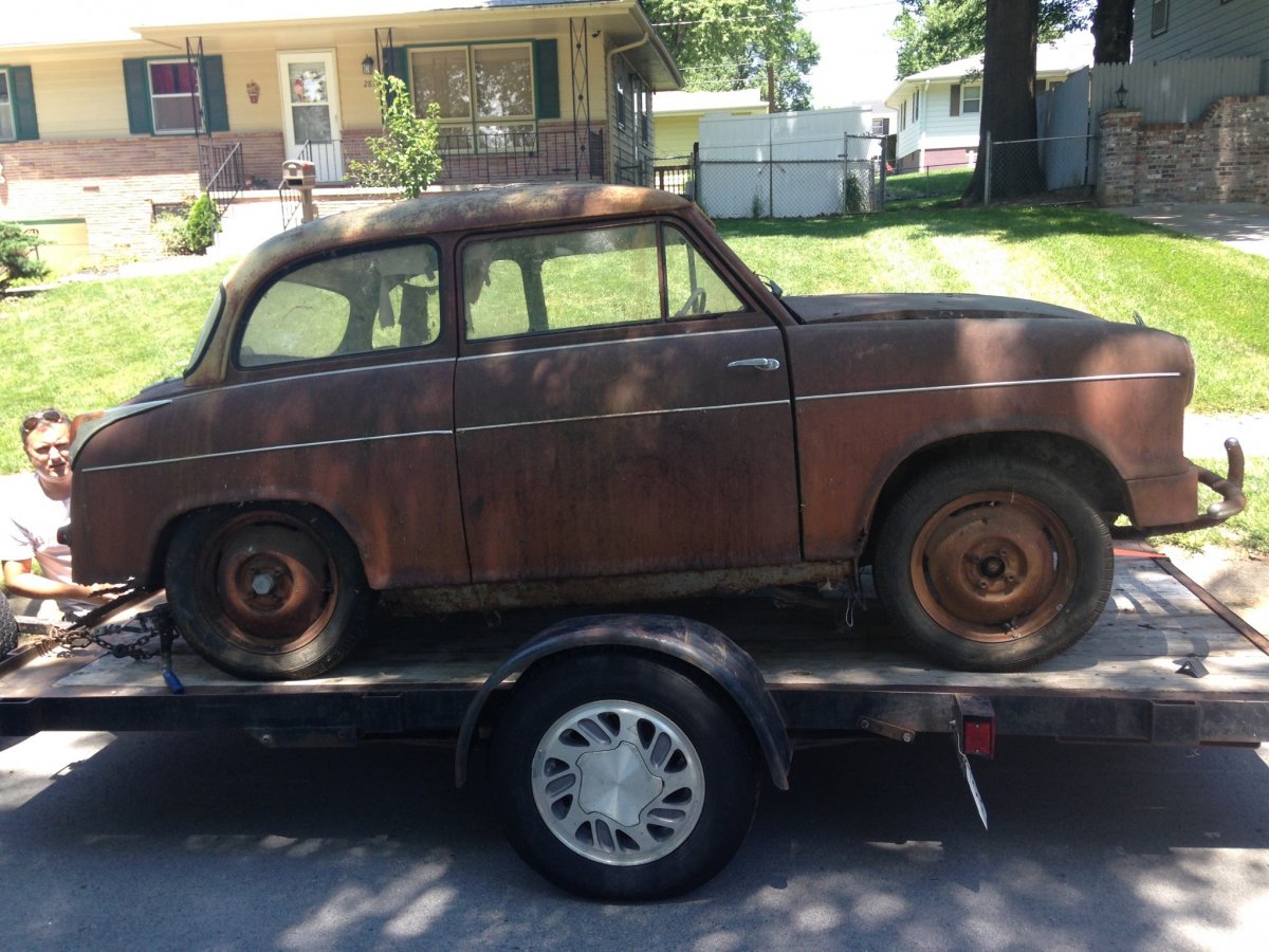

  11. Ok, it was in a TIGHT garage so I couldn't check all of it out, but what I could see looked ok (rearend, floor, frontend) as I let my camera be my eyes. Now the rearend swap got a little more interesting, I pulled the rear wheels to get an overall measurement.....51 1/4" and then pulled off the front wheels..........
  12. Ok, now I know I'm skating the line here and to make it worse.....does anyone have a clue what brakes these are and what bolt pattern are 4 on 4 1/4" (108mm). The calipers say Girling, which I've seen on old MBZ, Saabs, Volvo.....I worked at some weird places in the past :).

  14. According to the internet it's a Sunbeam Alpine suspension and brakes......now I need a rear to match.......and 14" or 15" steel wheels.

    for 4 1/4" wheel bolt pattern, '60's early '70's Mopar small/intermediate had that wheel bolt pattern and wheel diameters in that range.. There are others as well.

    The fox platform Fords of the late 70's-early 90's used the 4on4.25" bolt pattern as well so Fairmont, Mustang, Cougar, Thunderbird, LTD II etc. Im not sure about the Mustang II or the Pinto but I would suspect they are the same although they could possibly be the larger 4on4.5"

    Nice Hillman. Leave the 2.3 in it. Putting a V-8 in there will require many hours and dollars. Just fix the brakes and look for a Mustang 2 rear end , has the right bolt pattern and should be close as far as width.

  24. Lovely little car. Euro 1970 Ford Capri is also 108mm. Those turbo style wheels look Ford Capri as well.

    Those brakes are standard 63 - 67 Hillman or Sunbeam disc brakes. They came out on the Hillman Super Minx and Sunbeam Rapiers etc but are a bolt on to your suspension. It's a good swap. The only additional boost you could do is add a brake booster to the system. This was a popular swap many moons ago
