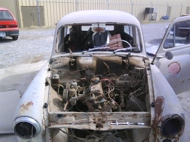

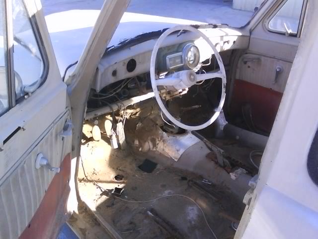

    I've been trying on and off to put a 1957 Chrysler 392 hemi in to a Hillman Husky. Figured I'd get it up on here to document what I've done so far. You can see additional photos of this and other Rootes cars (Sunbeams, Hillmans and Humbers) on www.dougscars.com
    My project started out with a 1959 Hillman Husky. I quickly found out there would be many challenges getting the 392 in there. The 59 has a rise in the frame that would interfere with the exhaust manifolds so I began looking for alternatives. I'm not that experienced so my skills limited what could and could not be done. What I can't do was farmed out to local builders or fab shops.

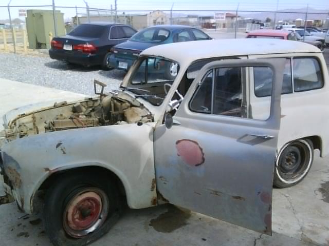

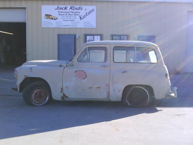

    Here are some photos of what I started with. The ultimate goal is not a trailer queen but a car I can drive anywhere and not be worried about it getting a scratch or ding. Current plans call for the body to remain as is with faded paint and primer showing through the worn paint.
    These pictures are of a the 59 Husky body I started with. Found it just north of San Francisco.
    100-0004_IMG.JPG 100-0008_IMG.JPG 100-0009_IMG.JPG 100-0010_IMG.JPG 100-0011_IMG.JPG 100-0012_IMG.JPG 100-0015_IMG.JPG 100-0017_IMG.JPG 100-0020_IMG.JPG IMG_1495.JPG IMG_1496.JPG

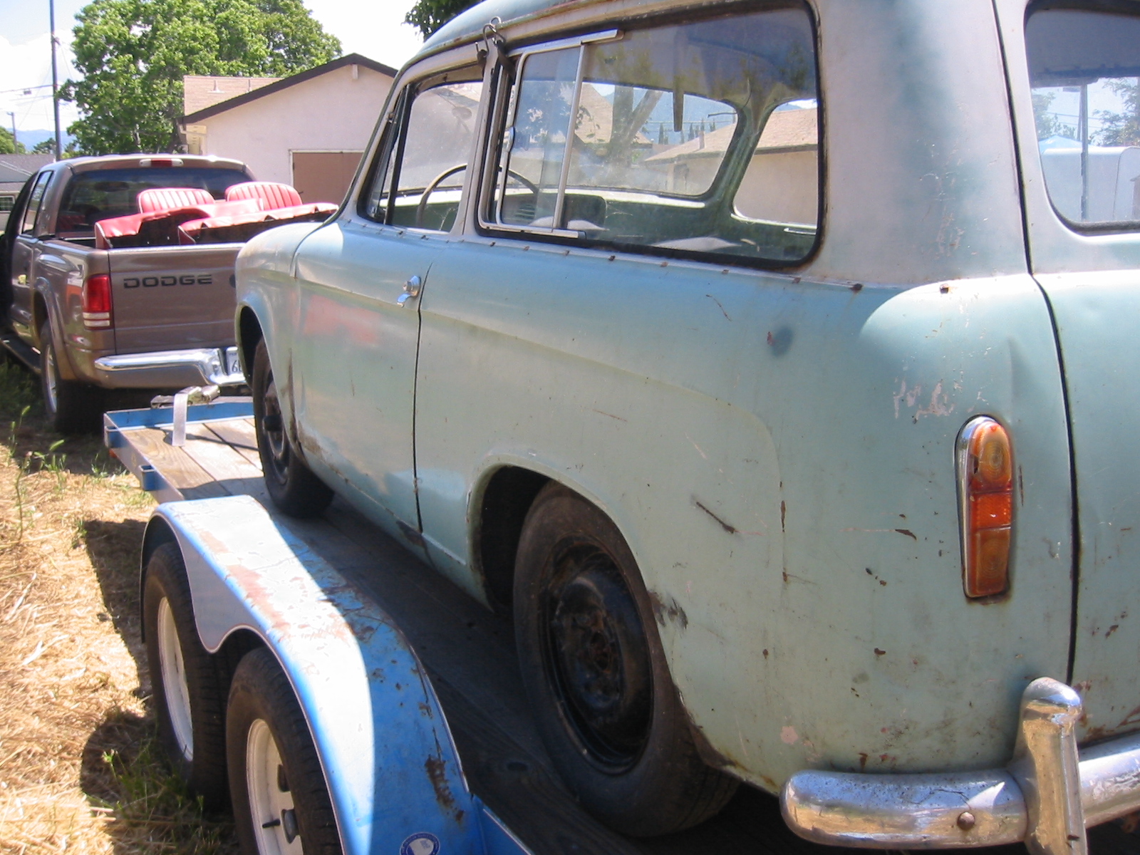

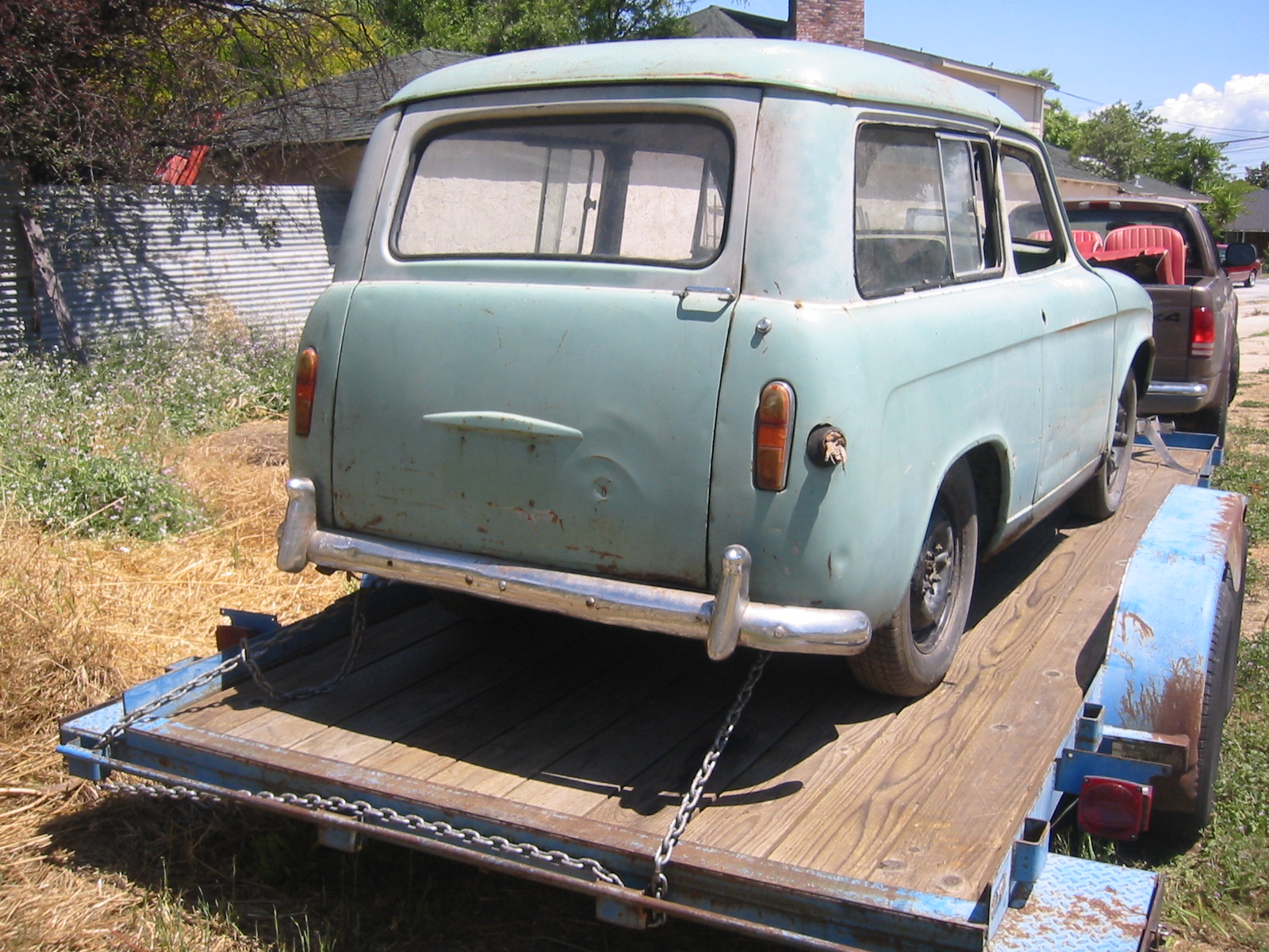

    Since the first body was too rusty I began the search for another. I found one in Fresno. This was the panel version so it was extra cool. It had been in the same family since 1968. I soon had it on the trailer on the way home to Morgan Hill. I love the steering wheel.
    IMG_6803 Towing to Oakland.jpg husky 2.jpg IMG_3397.jpg IMG_6806.jpg IMG_3405.jpg IMG_6809.jpg IMG_6811.jpg IMG_6812.jpg

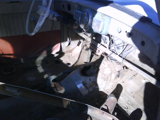

    I got the blue Husky home and started taking inventory. It was full of junk. I found out why it was off the road…..there was a large hole in the block. The more and more I looked at the car the more I realized that this one was no better than the previous Husky.
    IMG_6814 bringing home.jpg IMG_6822.JPG IMG_6862.JPG IMG_6863.jpg IMG_6821.JPG IMG_6818.jpg

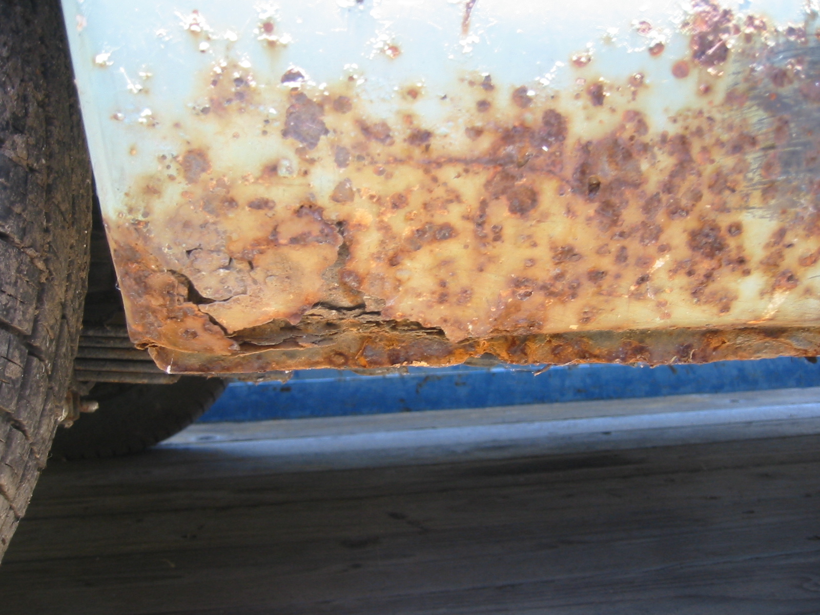

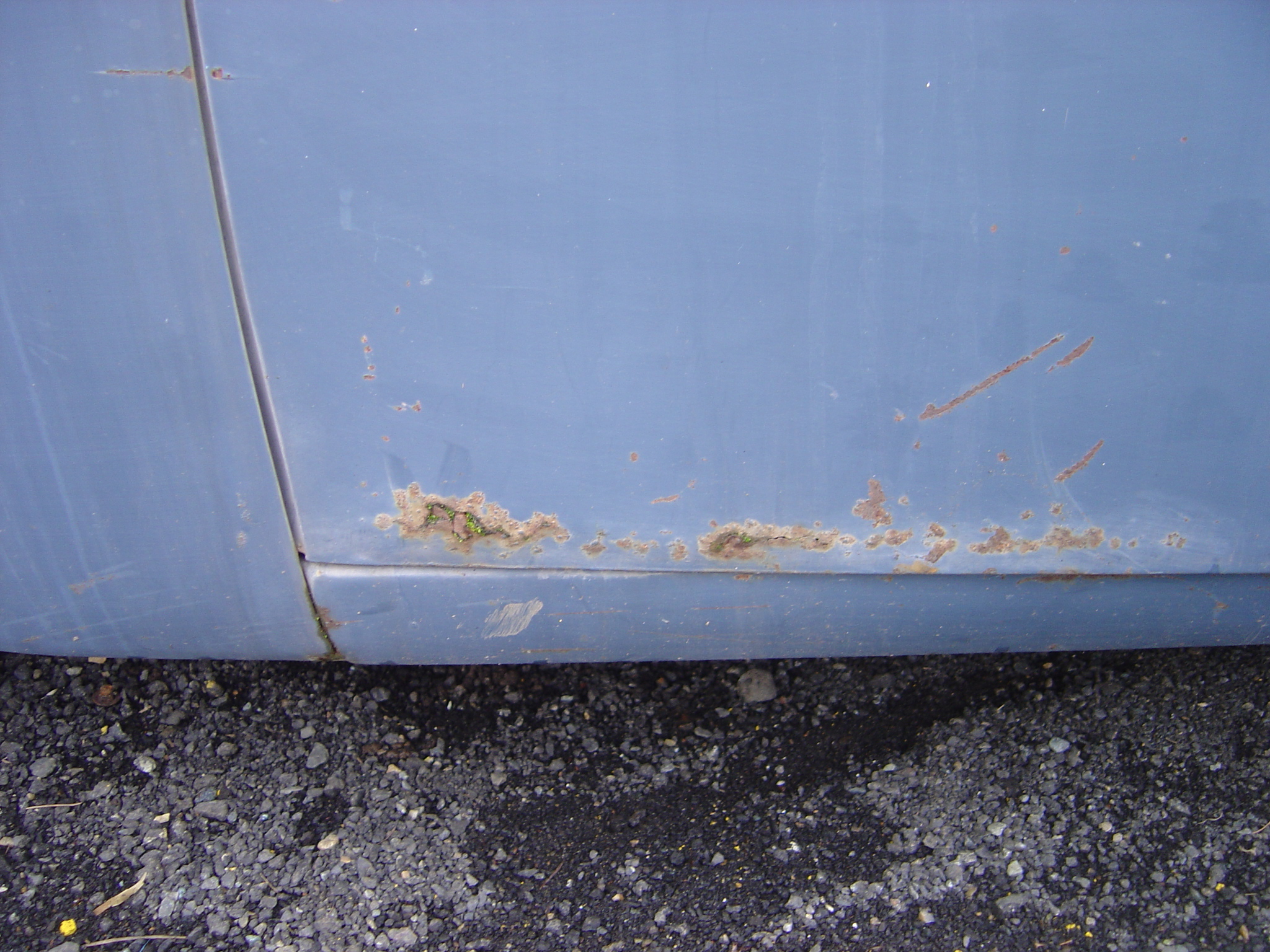

    This was the level of rust I was dealing with. The gas tank was gone. So was the area around it. That pile of debris on the floor was a lot of rusty metal. It was time to find a new body.

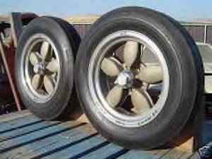

    I know it's not traditional but I found an IFS for the front and soon found the 15 x 6's wouldn't work. The 15 x 8's wouldn't work either because I was going to use an IRS and didn't want to have to tub the wheel wells. I gathered all my spare wheels and worked a trade with Greg Shelton. I think I traded 10 wheels plus cash for 4 good wheels.
    Greg had a set of 15 x 4 American Racing 200S wheels that were perfect for the car. He also had a set of 15 x 7 of the 200S wheels for the rear end.

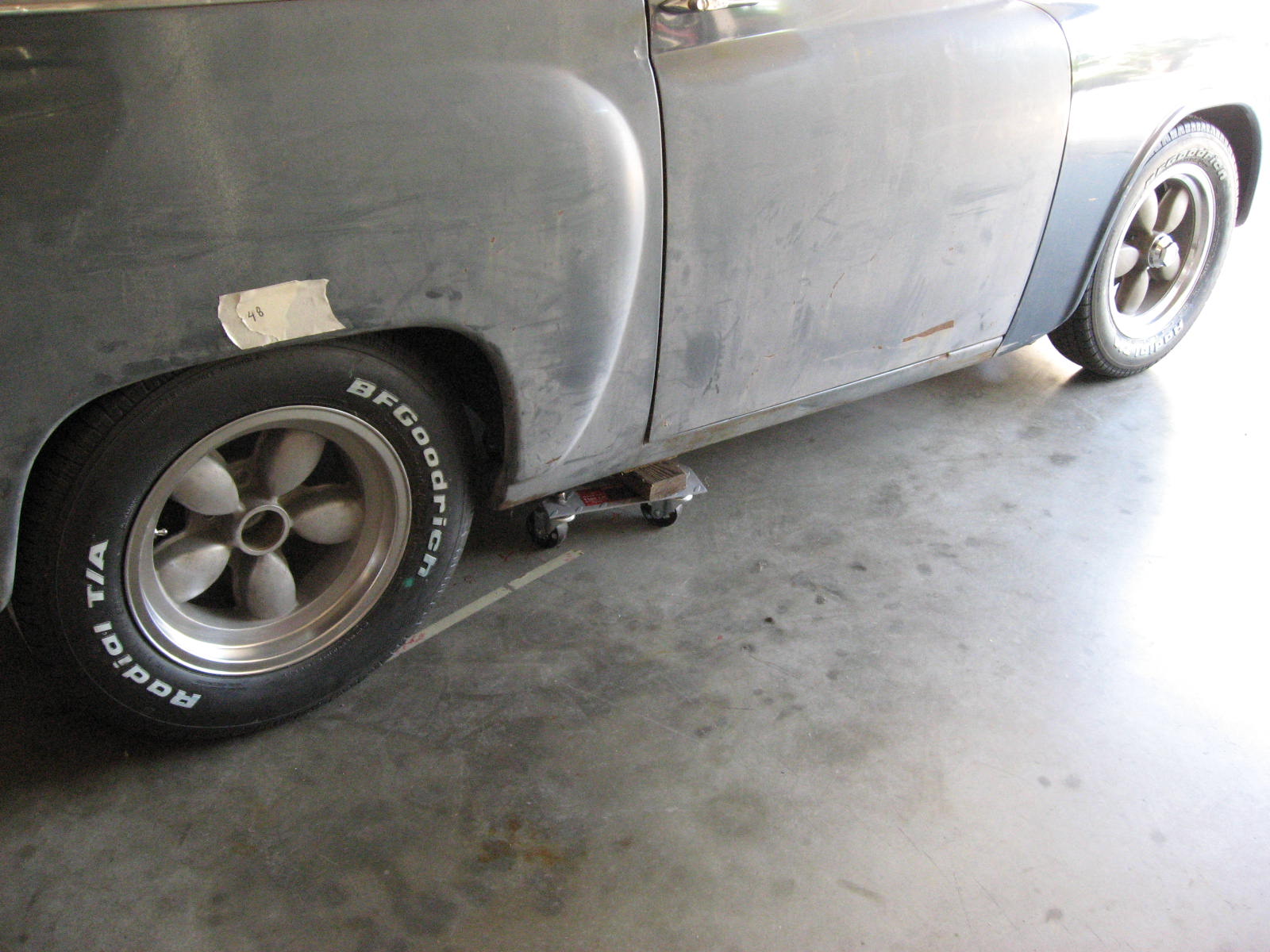

    I learned you start a project with the wheels you intend to use. That way you can figure out how much everything gets narrowed. I started taking measurements of where the original wheels were located so I could put the AR wheels in about the same spot. This meant I also had to get measurements of where the fenders were. I used the garage floor to make all my markings. It seemed to work.
    IMG_7858.jpg IMG_7860.jpg IMG_7862.jpg IMG_7863.jpg IMG_7864.jpg IMG_7865.jpg IMG_7866.jpg
