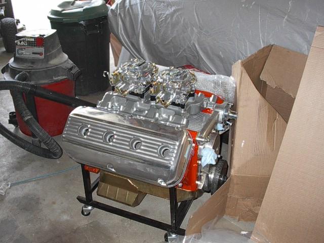

    I used the 340 hi vol oil pump modified to fit the 392 it uses the std intermediate drive and gear. I used the hotheads spin on verticle oil filter adapter but there was a clearence problem with the trans adapter so I had to use a smaller oil filter to gain clearence. As for the oil pan I used a 7 quart rear sump Milodon pan. Also the oil by pass plug that HH sells to divert all oil through the filter. Here are pics of the oil pan and filter adapter.

    You're pictures didn't show up (or I can't see them anyway).
    What trans adapter are you using, for what transmission? I assume this wouldn't be a concern if this were an extended block 331?
    EDIT: I see the pics now...

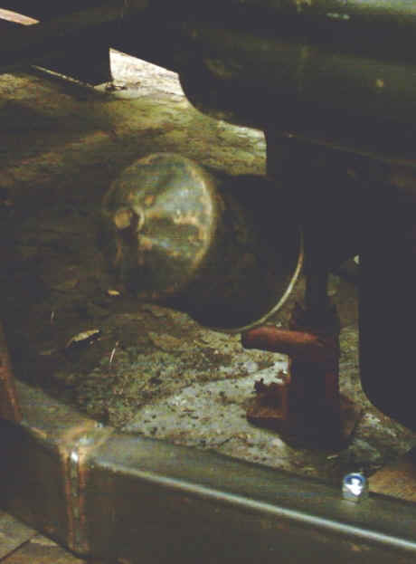

    As for the oil filter, I don't know how your DeSoto oil system works, but the Chryslers didn't filter all the oil on the first shot through the motor and now various companies make provisions to allow for ALL the oil to be run through the filter increasing the life of your motor and allowing you to get away with going more than 1000 miles between oil changes.
    As for the filter itself... I'll just let this picture of the stock oil filter do the talking for itself... do you really want this thing sticking out of your 32 Deuce coupe hood sides? (figuratively speaking)
    Try puting some lakes headers on a motor with that thing sticking out all over the place!

    I BOUGHT one of those on Ebay just BECAUSE it looks so cool.....and hundreds of early rails can't be wrong....that filter was the hot set-up for years!!!

    Really??! Why were they so hot?? Lugitimate question, not trying to be a smart ass. I haven't seen one in a long time actually being used. Haven't looked too hard either though. If you're running "lakes headers" or cut-outs do they interfere and do they interfere with early hoods?

    THAT BIG ASS FILTER YOU SHOW IN THE PIC IS AND INDUSTRIAL or TRUCK FILTER FOR 331 CHRYLSER (and others) ..... THE STANDARD PASS CAR FILTER HOUSING IS NO BIGGER THAT A STANDARD PH8A FORD OIL FILTER.
    THE ONE ON MY SPORT COUPE HAS BEEN CHROMED AND LOOKS BITCHEN STICK'IN UP NEXT TO THE FRAME RAILS.
    OHHH, AND BY THE WAY, THE DeSoto HAS A FULL FLOW OIL SYSTEM & AN ANTI~DRAIN BACK VALVE TO KEEP THE FILTER FULL.
