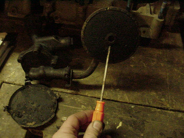

    Here's the pump I speek of. (that's not rust, it's some kind grease)
    Is this screen good to go or should I replace and/or modify it? (sorry for the dark picture)

  28. What is stamped into the little tag on the pump? The tag might designate its a replacement pump. Do the five little screws have the "DPCD" markings on their heads? I think every 331/354/392 pump I have ever seen had those markings on the screws heads.
    The "floating pickup" had the pickup screen mounted to the oilpump cover on a pivot so it can move up and down slightly. That way it stays near the bottom of the pan. The design was abandoned by 1957 with the center-sump pans, as the pickup was threaded into the pump.
    As for your pickup screen, refer to my earlier post about the bypass hole lurking beneath that screen's cover strip. You can also see the floating pickup on that 1956 oil pump.

    The earlier hemi's used a pickup that actually pivoted on the pump. It will be obvious if you have one as the rest of the pump syou can clearly see that they thread directly into the pump body. I don't think pivoted like you'd see on the race pickups where they are allowing the pickup to move front/rear to keep it moving with the sloshing oil - IIRC the factory one pivoted mainly up/down - I'd have to look at the one I have to be 100% positive.
    There's nothing wrong with a stock pickup - yours looks dirty to me - I'd want to make sure it was spic and span before I'd run it - not just on the outside bu tht einside asa well. You might give it a close inspection in and out. I got rid of the pickup on my digger for a couple reasons - first I have no suspension - things tend to vibrate when you run over a bumpy road at 130+ mph. I was also hoping getting rid of it would make things like tire shake less potentially damaging as well. Pretty much an overkill thing on my part.

    Here's some better pictures. The heads of the bolts do in fact say "DPCD". The tag is stamped "50".
    I agree it's dirty and I had definitely planned on pulling it apart and making sure that all is well and replacing any seals it might need, and what not.
