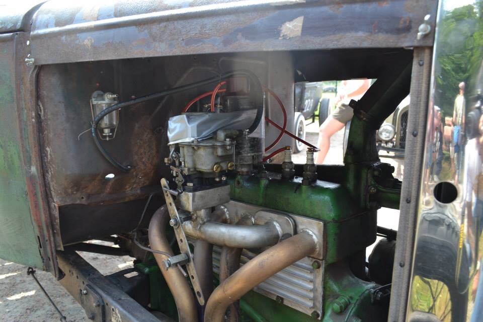

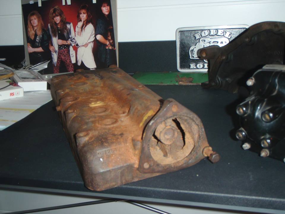

  8. I built mine with my dad when i was 16, i have had allot of fun with my stocker motor, but i do like my headers and my Holley 94 carb :) now this motor will get a touring cam and a C-head, im running a Magneto.. did not like the originale ignition.. Also, im collecting parts for a OHV build :) im 18 now.. :) 10556491_522563187843285_942006528699062886_n.jpg
    Not the best picture, but its a roadside repair.. haha.. here is my setup after a hillcklimb i did :)
    Here is the Model C head im going to mill and use:

  13. I would suggest a little research before you mill the C head. From what I have read (fordbarn.com) you don't gain that much compression and would probably be better off starting with a Snyder's head. Remember you are limited by the thickness of the casting and piston clearance. That plus you will need a new Model B water pump (be sure to get one for a '32 and not a '33-'34)

  15. Its still bether than the model A head, im going to use a v8 waterpump :) my pistons are flush ;) and what fun is reading when you can try? a snyders head is expensive toget over here in norway :) this was not :) + i like the look :)
