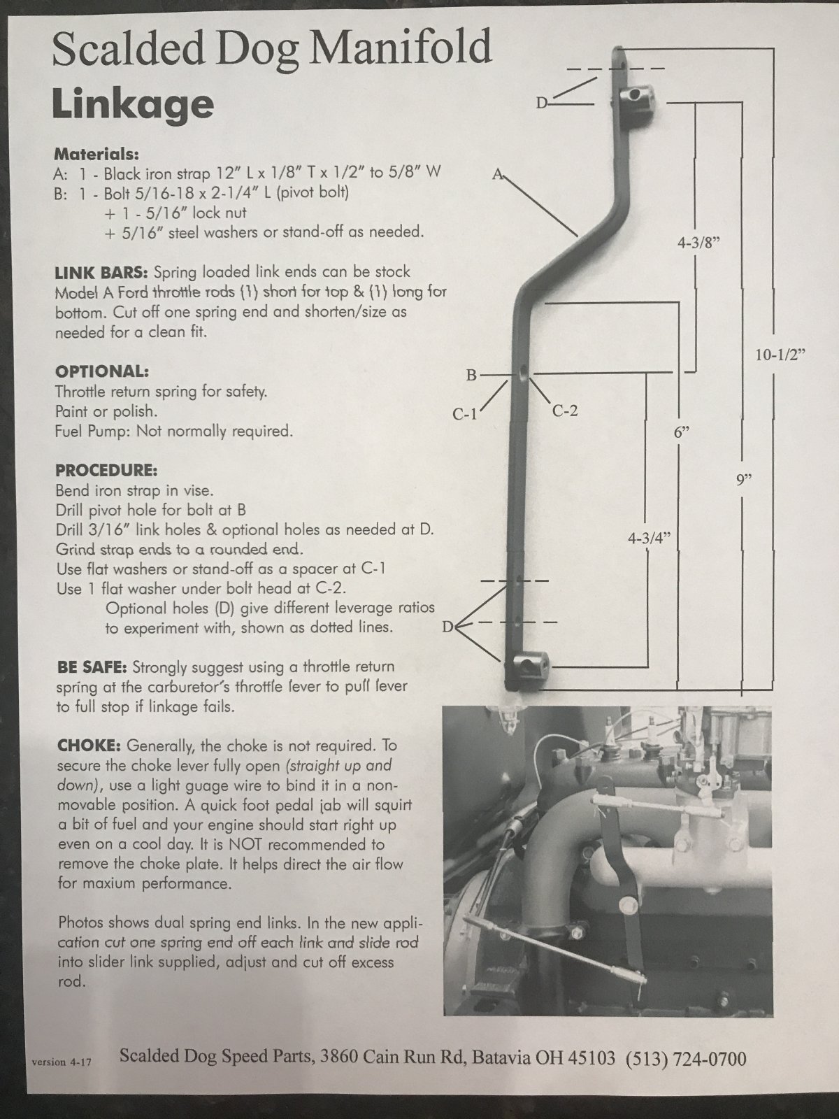

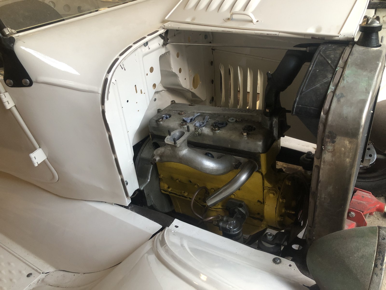

    I have just installed my equalizer intake with a pair of 97s. The intake does not come with a throttle arm and the one off my Ansen is not very comfortable on there. Is anyone aware of a throttle arm that works with this intake? Snyder's sell one, but I'm not sure if it works or do I have to make one?
    Warren

    If you can weld, it wouldn’t be too hard to make a custom length/shape throttle arm like the one you posted.
    https://www.ebay.com/itm/204199111531
    I had this one saved in my eBay watchlist for a year or two, but never bought one.
    Might be what you’re looking for.

    Charlie Yapp has a blue print for making a DYI arm

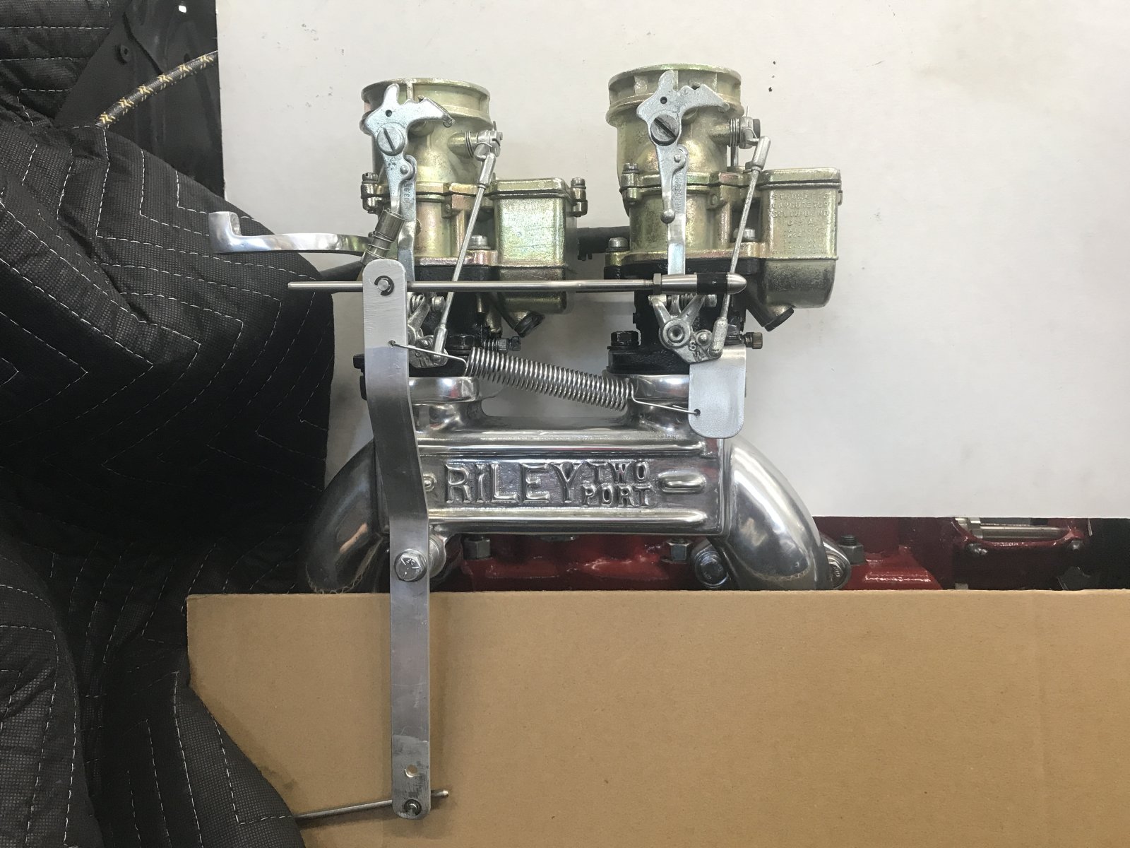

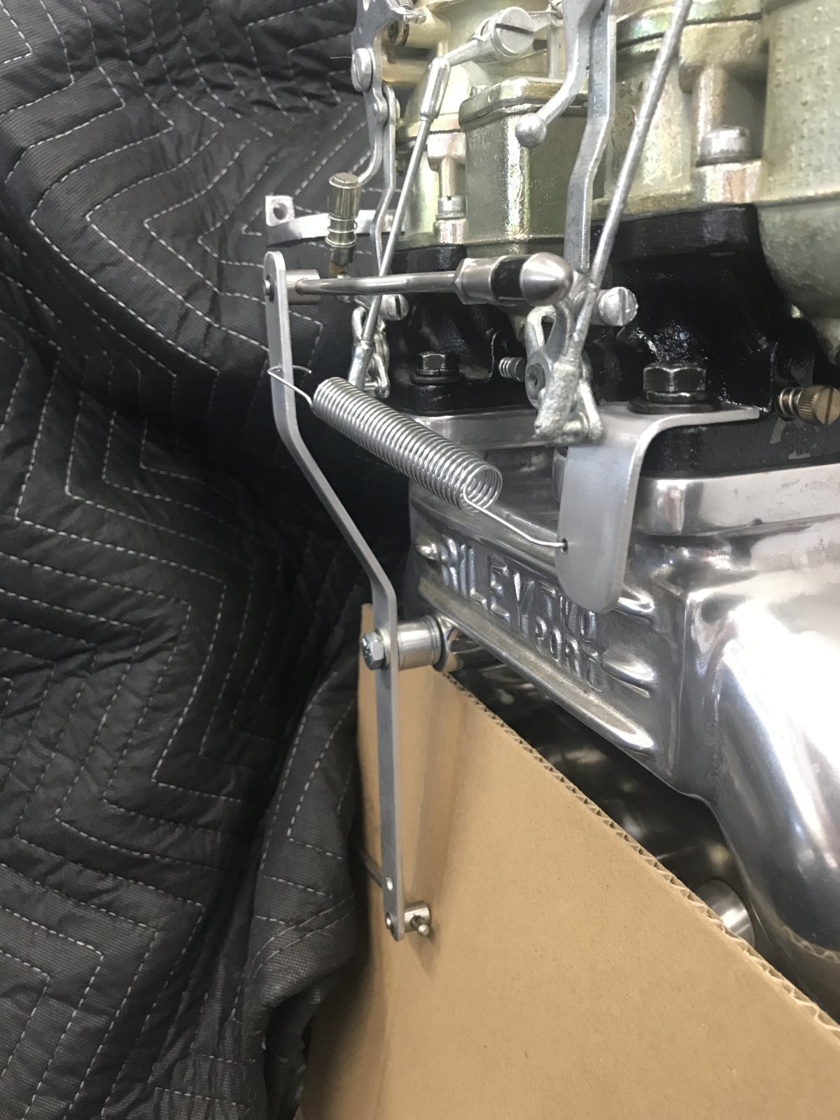

    I have that same manifold with 97’s and had same problem. Charlie Yapp originally made it for the Riley 2P program but changed to Equalizer when he sold off the Riley 2P
    There needs to be some offset in the arm so none of the standard throttle arms work . All that I tried had some type of interference. I’ve been told that Charlie had a specific arm that came with the kit, but I’ve never seen one.
    The one from Snyder’s is a similar design for most and won’t work. I’ve tried the Burns arm along with several unknown arms. None of them worked.
    I ended up making one from the pattern from Scalded Dog Speed, a C.Yapp company. I used aluminum vs steel and have no problems.
    Hope this helps.
    Hope this helps.[/QUOTE]Riley 2P
    When I asked Charlie about the throttle arm, he never mentioned the pattern, but rather told me about the one from Snyder's. I wasn't particularly impressed with that arm so I am going to make one from your pictures. Thank you for those.
    Warren

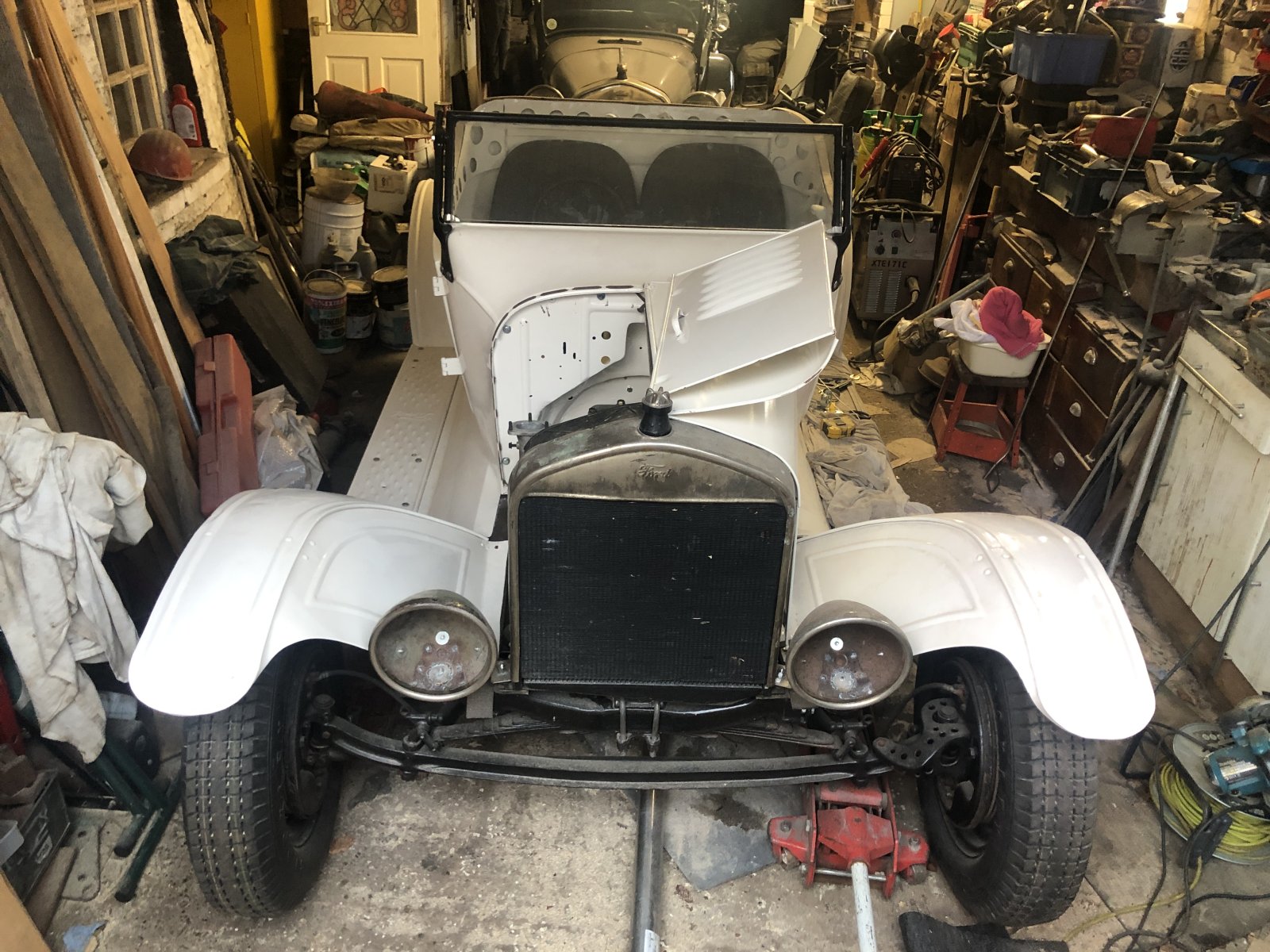

  17. 2A762B70-BC89-4F60-93DA-401516E7C5B5.jpeg B67D6802-D0A6-4C23-B89E-038FB5E5654B.jpeg Work on the cream T continues… building a stainless header at the moment.

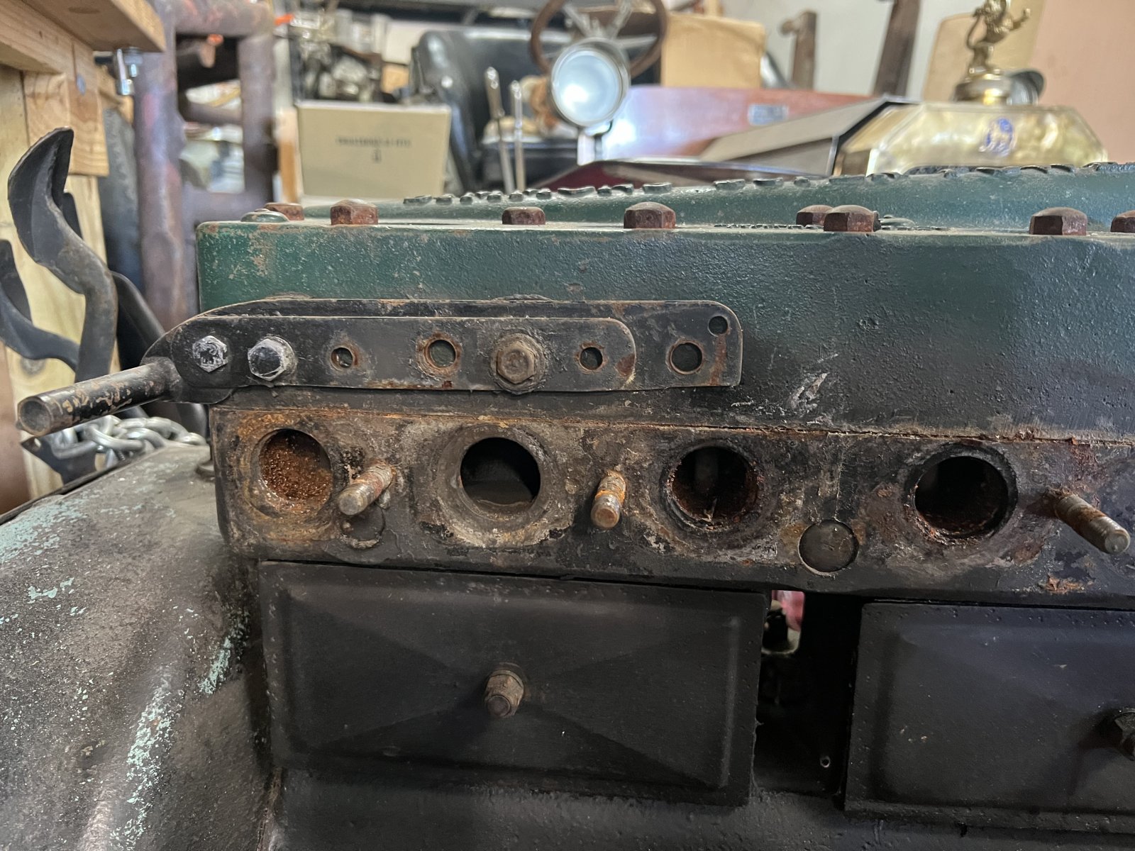

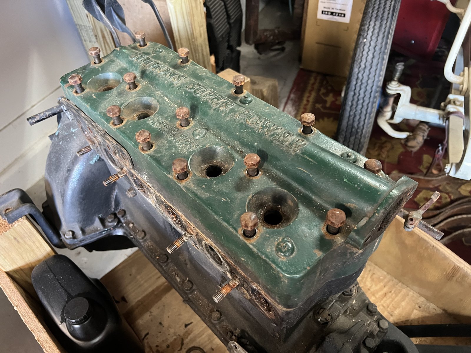

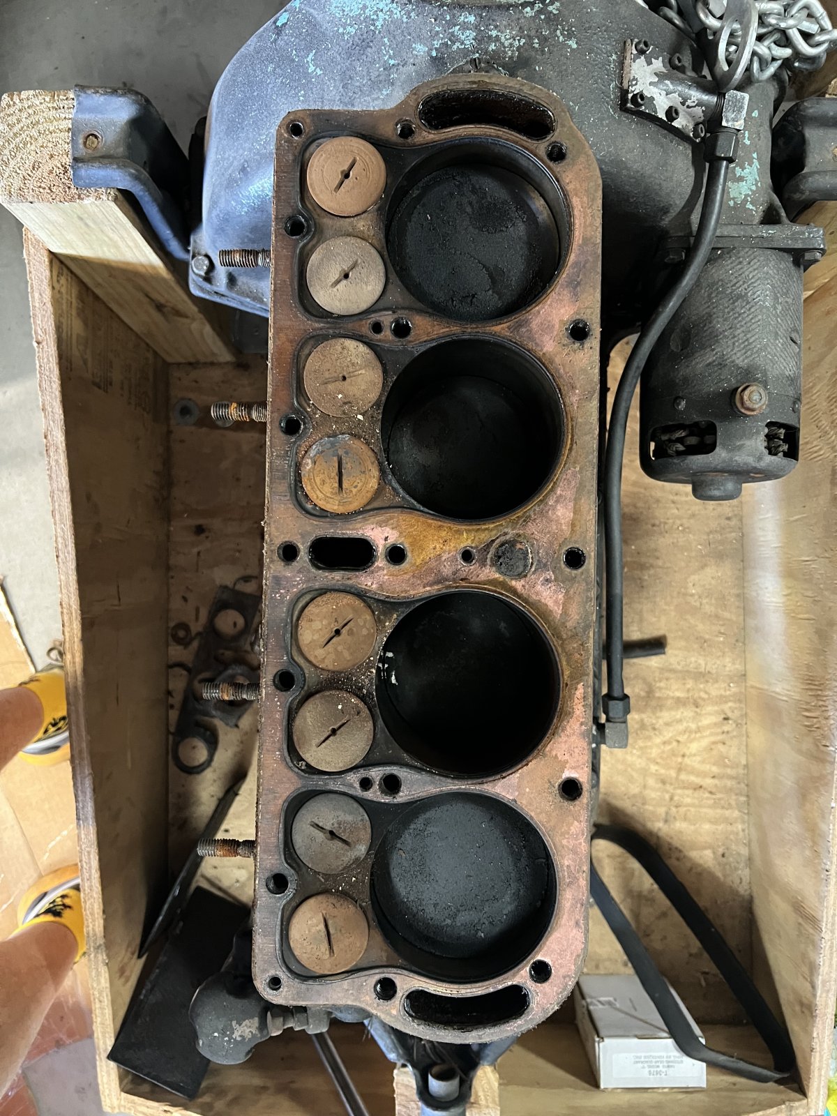

  18. fur biscuit
    Joined: Jul 22, 2005
    Posts: 7,831
    fur biscuit

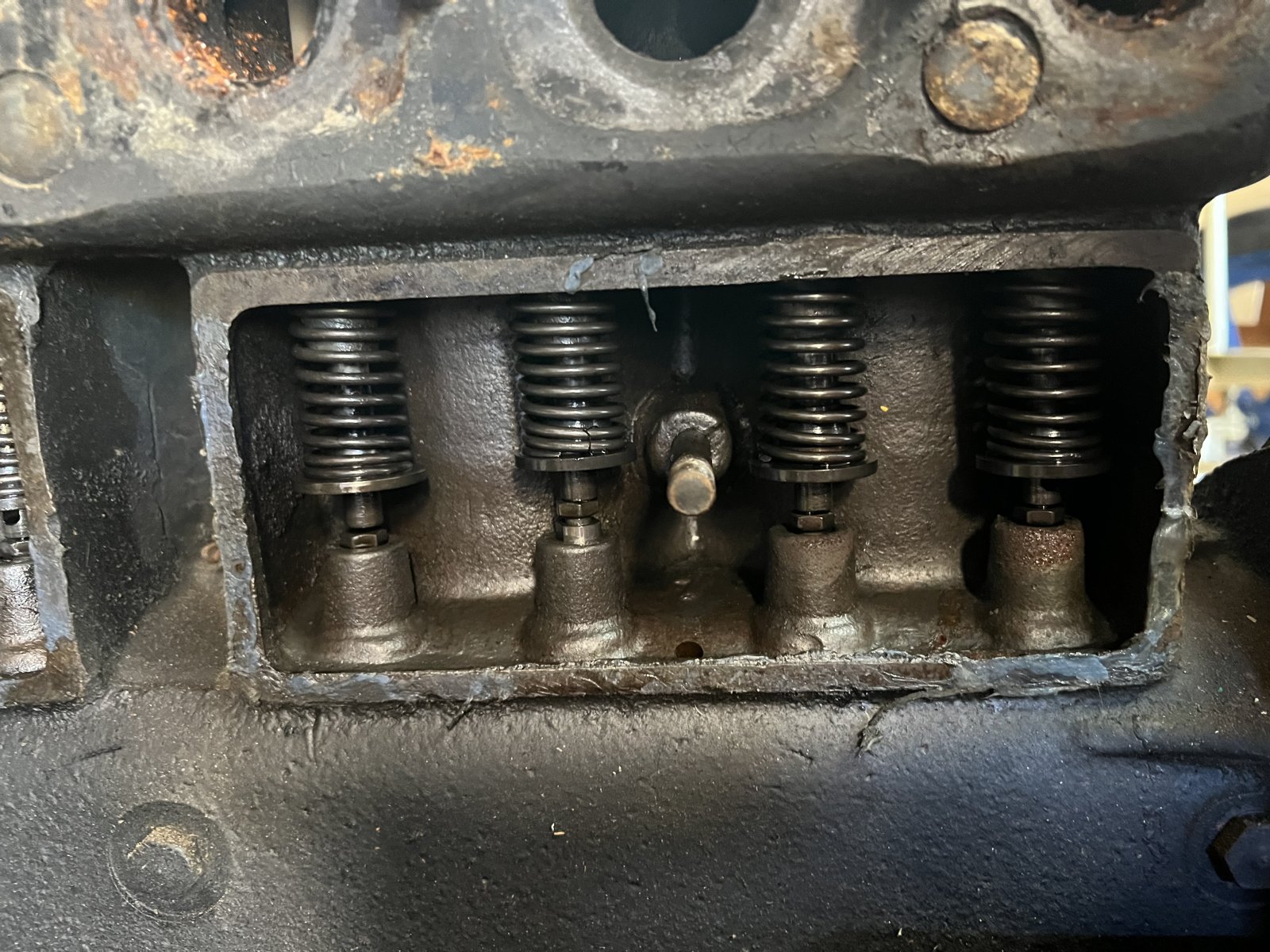

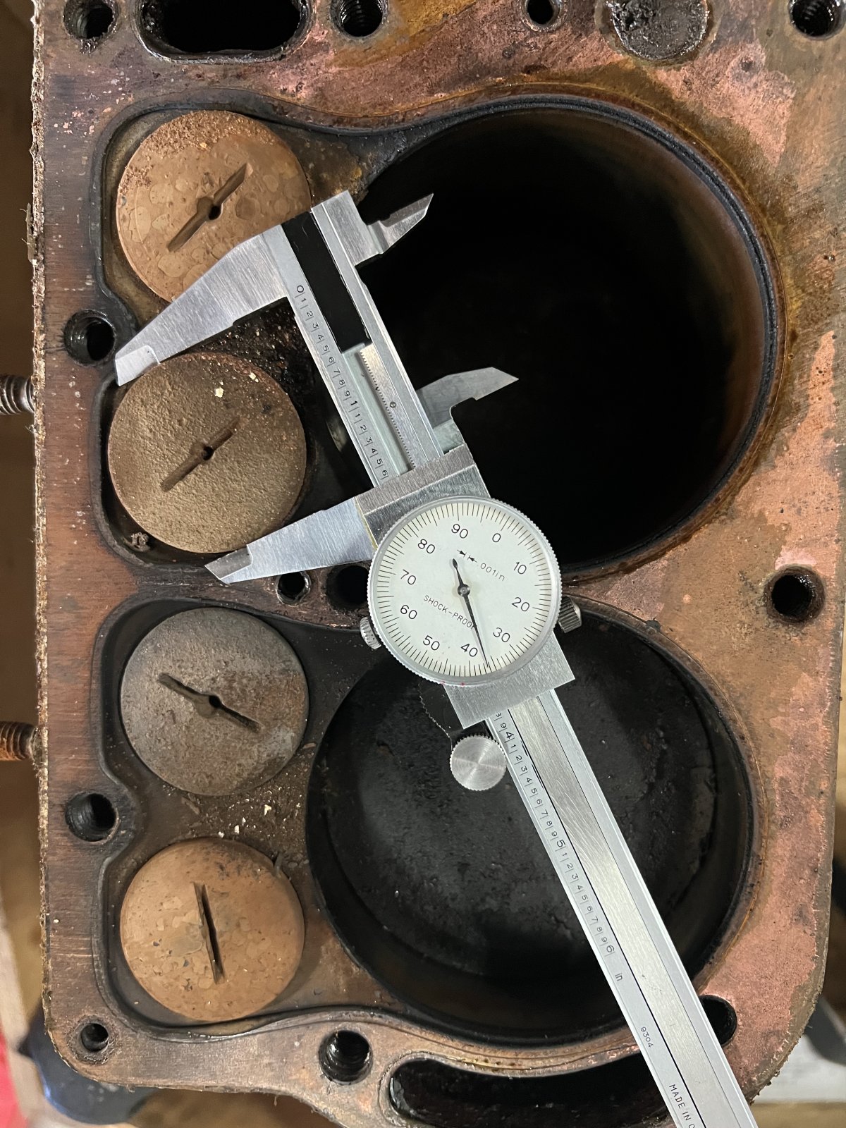

    Continuing the speedster saga, picked up an engine at auction, complete unknown. What I did know it has no compression. From the outside it looks very well thought out with some interesting details. There was a model A intake and exhaust mounted with no adapter plate. The earliest vw distributor conversion ever, off a 36hp bug. The head is a cast iron Simmons. There is also an Exterior oil line from the starter side of the hogshead to the front of the block. Today I started pulling it down. What other surprises will appear?
    well...

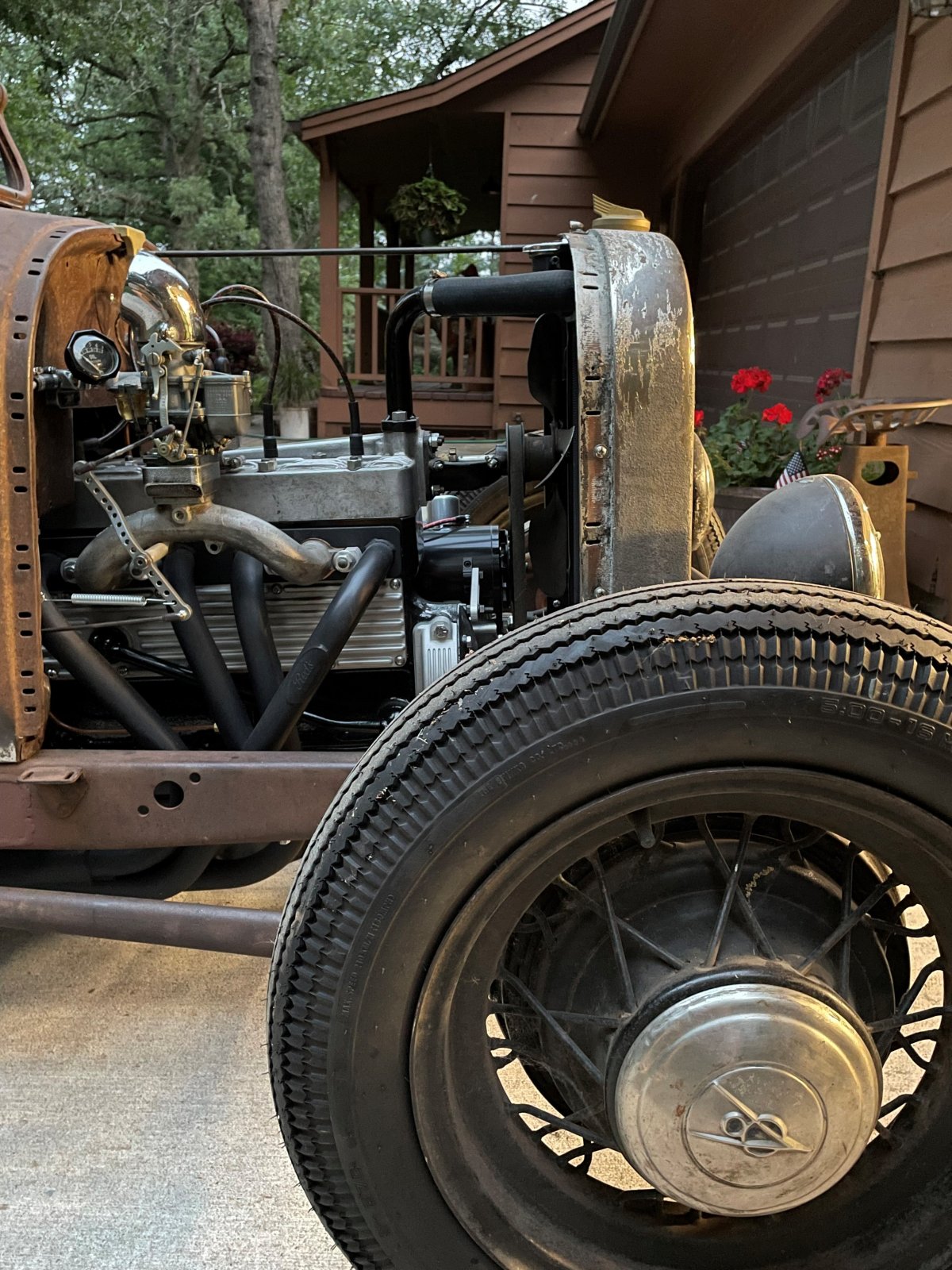

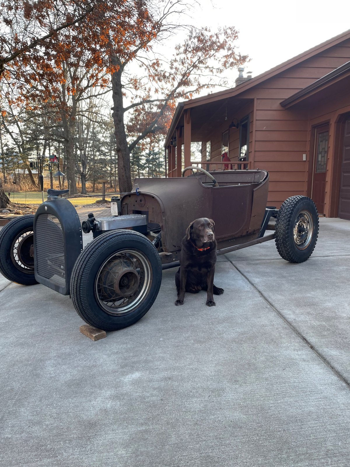

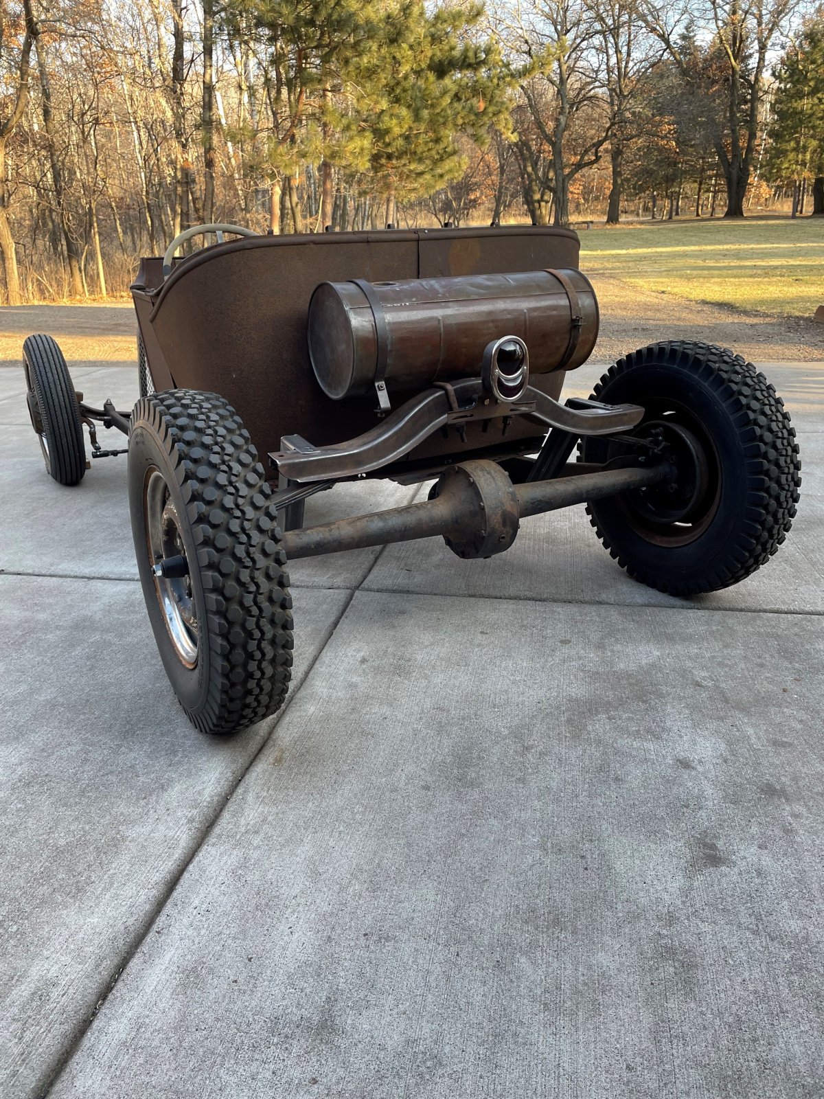

    Been picking away at this cluster. Got the rear dialed in but plenty of problems left to solve on the front.
    Need to start digging into the banger for this.

    He wants to go for a ride!!

    he will if he lives long enough, he's 10 but thinks he's 1

    Pretty handy, you won't have to paint the car or the dog, they're already color matched.

    brown dog brown car hehe
