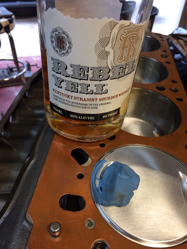

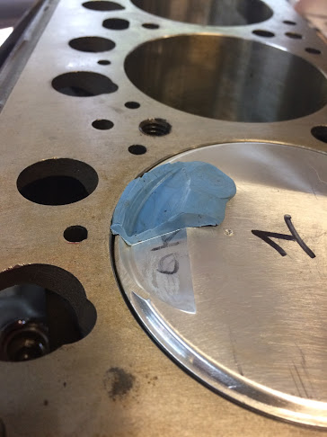

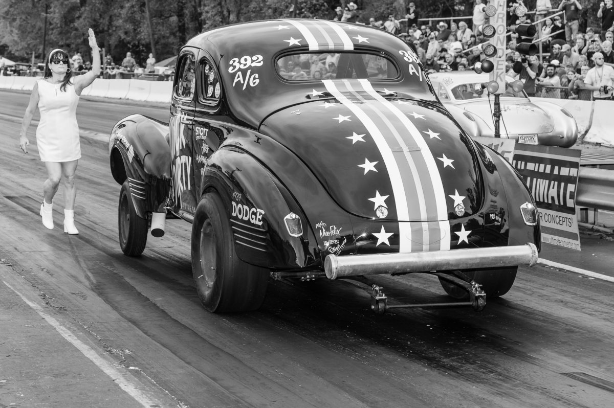

  10. Ok some parts of this last minute idea to build @Cabbage 's blower based 392 Hemi were not very well thought out. That was a 10 day thrash that's not for the faint of heart. I for sure quit 6 times and the 7th was gonna be the last time.
    Think we left off where Russ got the pistons fly cut the first time. This was Sunday and the valves were hitting - show stopper - we are done.
    Beautiful! Game on!
    Now its Wednesday and I have a headache still
    Game over! Show stopper!
    Thursday I had taken the day off work to go to Shady Side to test and tune. The txts start coming in .... go see Johnny again and fix those pistons @Tudor won't let it die ......
    Back at Johnny's
    Some Ford guy stopped in
    Now we're talking!
    But its 7:30 Thursday night. Tim calls "Hey man you need help?" (He's 2 hours from me)
    And at about 1 am we quit
  11. 7am Friday and back on it.

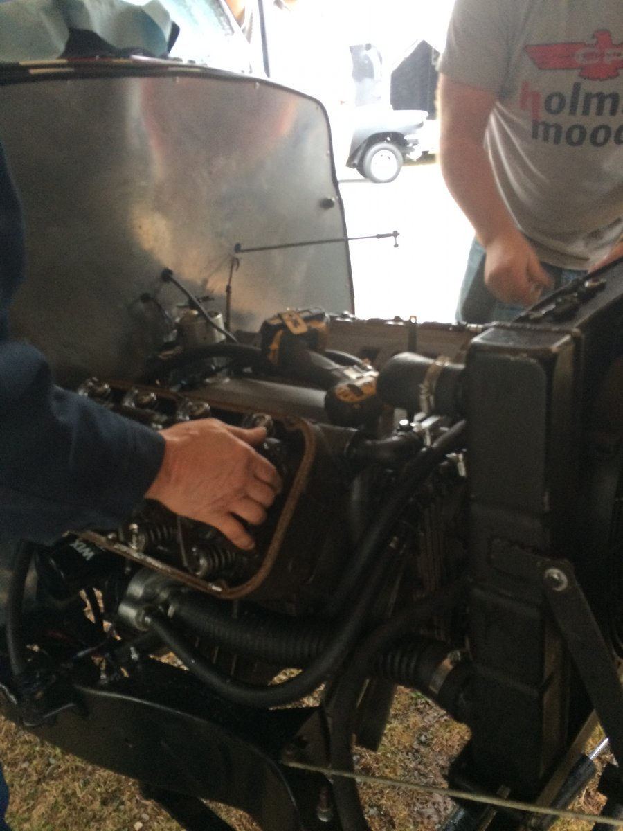

    About 5pm we broke in the flat tappet Isky 505 cam with only the outer springs
    This isn't the break in video - the phone is full - this was later but imagine 2500 rpm ....

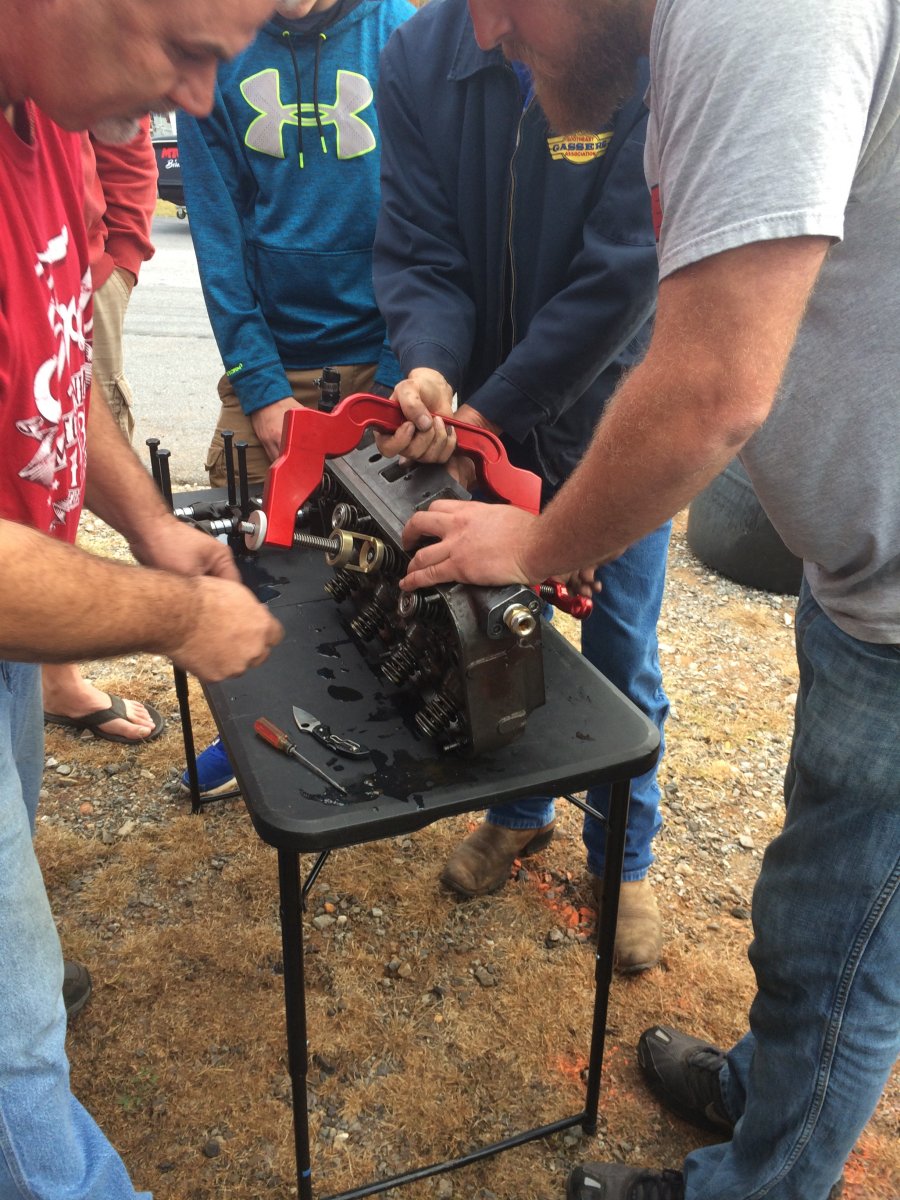

  12. We finally get loaded on the trailer and headed to Shady Side about 9 and roll in about 12:30. Then its morning again. Now the heads need to come back off to install the inner springs after doing the falt tappet cam break in. Like I said - not for the faint of heart or the sane person.....
    IMG_6517.JPG IMG_6518.JPG IMG_6519.JPG IMG_6520.JPG IMG_6521.JPG IMG_6522.JPG IMG_6523.JPG IMG_6525.JPG

  15. But as far as using an 8:1 compression engine on a giant stack injection ..... not so much. After the burn out it was time for a rest.

  22. Great to see you there too! You guys are hard to hide in a crowd ;)
    Kinda expected it - 2-5/8" butterfly on a 2.065" valve it ran out ok after choking on the gas from leaving the starting line.
