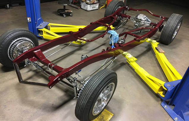

    I don't mind tackling what I do best but I pay for stuff I don't. Case in point, the dude with the sand paper and polisher is headed over tomorrow to start cutting and making with the pretty on my freshly painted parts.
    That meant I needed to make a roller out of the frame tonight so I can kick it off the lift. The polisher prefers working with the car of the lift to make a bit easier on his back and ensure a nice job.
    Here's the roller, headed to another bay for a few days.
    Needs a little something, perhaps a blown flathead?

    Thanks, the body is back on the lift. I left it bolted to the dolly so I can roll it around the garage after it is polished while I finish prepping the frame. Polisher is here, very happy with the paint job but he sees room for improvement.
    I gotta go to work and make the money I need to pay him, ill post some progress photos later after he plays with it today.
